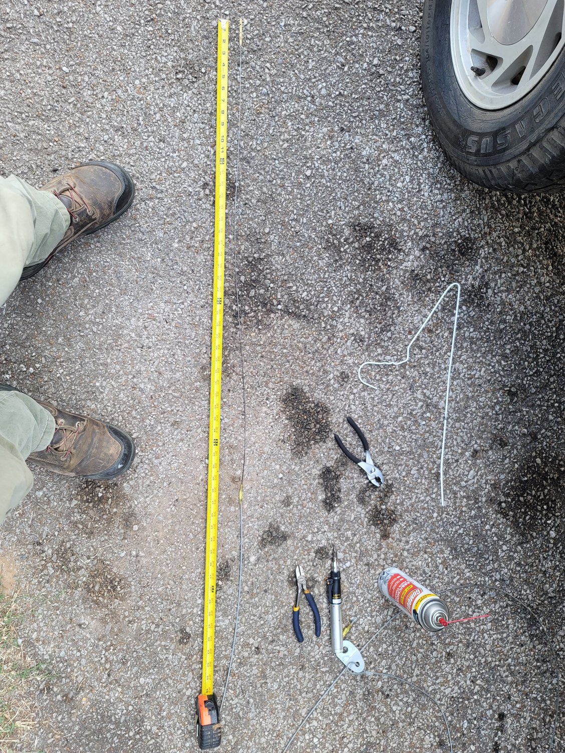

I've made a concoction. Heh. Don't laugh too hard. It works until I can source a replacement. Stress tested the connection too, it won't come apart with full strength.
