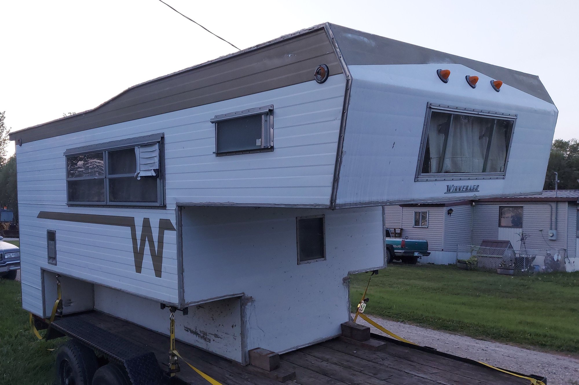

Yeah 100% agree. The Winnebago pictured below currently weighs 1400lbs and has a box length of 128'' so in my CCSB it would hang out 4 feet lol, but I'm going to completely gut it and only put back insulation, vapour barrier and 1/8'' wood siding leaving it a completely open space inside with no furnace, fridge or stove and I'm guessing that will drop the weight to around 1000lbs. I will of course build a small closed of toilet area to put in a dry 5 gallon bucket type toilet and for heat I'll use a diesel heater and for a back up heater I'll either install a second diesel heater as they're cheap or I'll put in a small wood stove.
Plan is to just turn this unit into a basic winter camper for this season and then come spring/summer I'll get a truck with an 8' box and then I'll go to town adding creature comforts to the camper like plumbing, small fridge/freezer, slide out, awning and so on and I'm HOPING that even with a 4' overhang it won't be an issue if the total weight of the camper with cargo isn't more than 1200lbs and if it doesn't feel safe on the test drive I will of course park the camper till I get a new truck.
What are you thoughts on that?
Here's the unit destined for a reno:

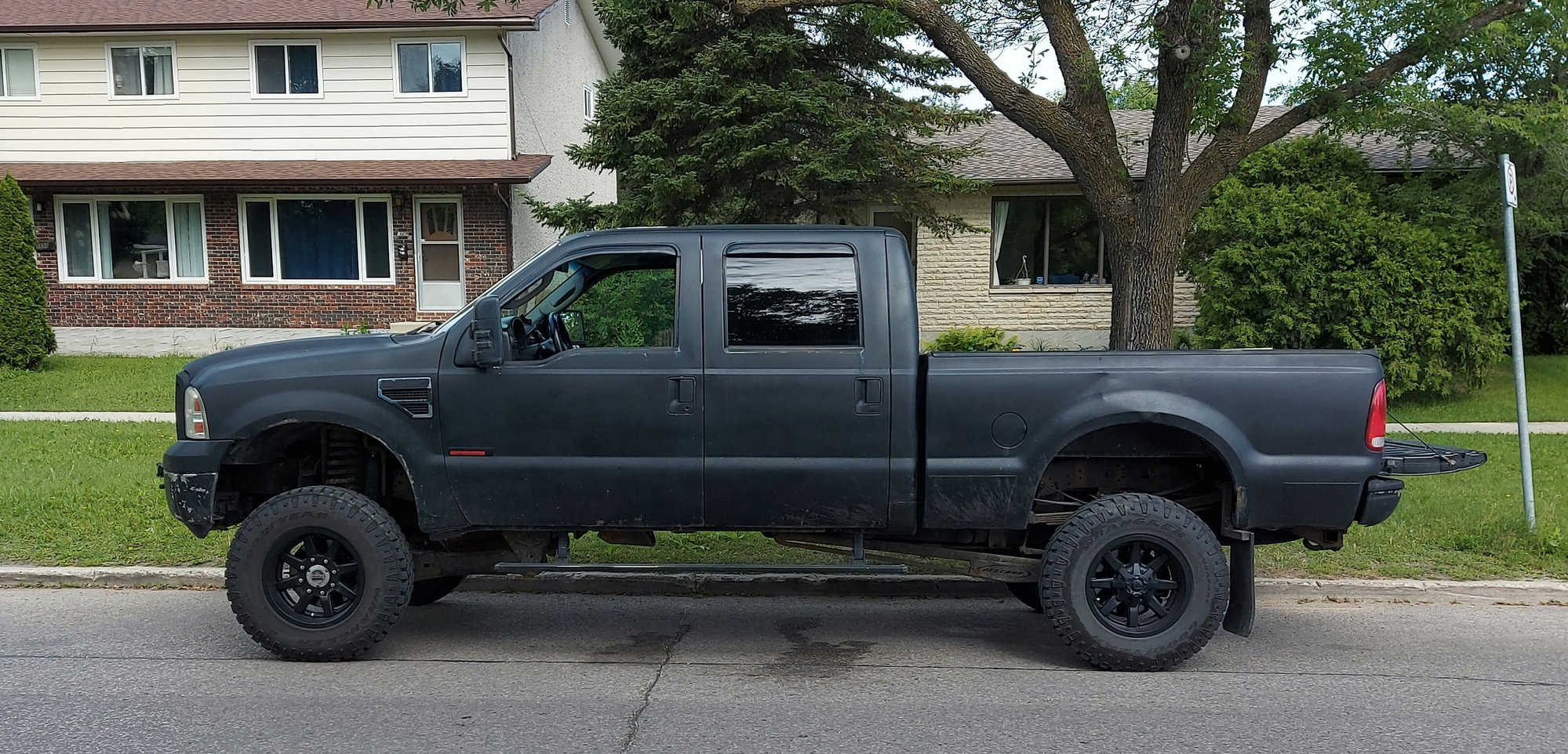

Here's my truck with 1600lbs of plank flooring on a 4x4 pallet centred behind the rear axle:

Sounds like a good plan. Make sure the eyes for the front tie downs are in really good shape! It's going to be biased towards wanting to move backwards, and the rear tie downs eyes will be too far back to do much good.
You might want to "help" it out with under-floor structure. Since it is designed to sit in an 8' bed and you'll be putting it in a 6.5' bed, the bottom of the box will be supporting in an area that is not designed to be on the edge of the bed. Maybe a custom-made receiver-mounted support at 8' would be in order?
