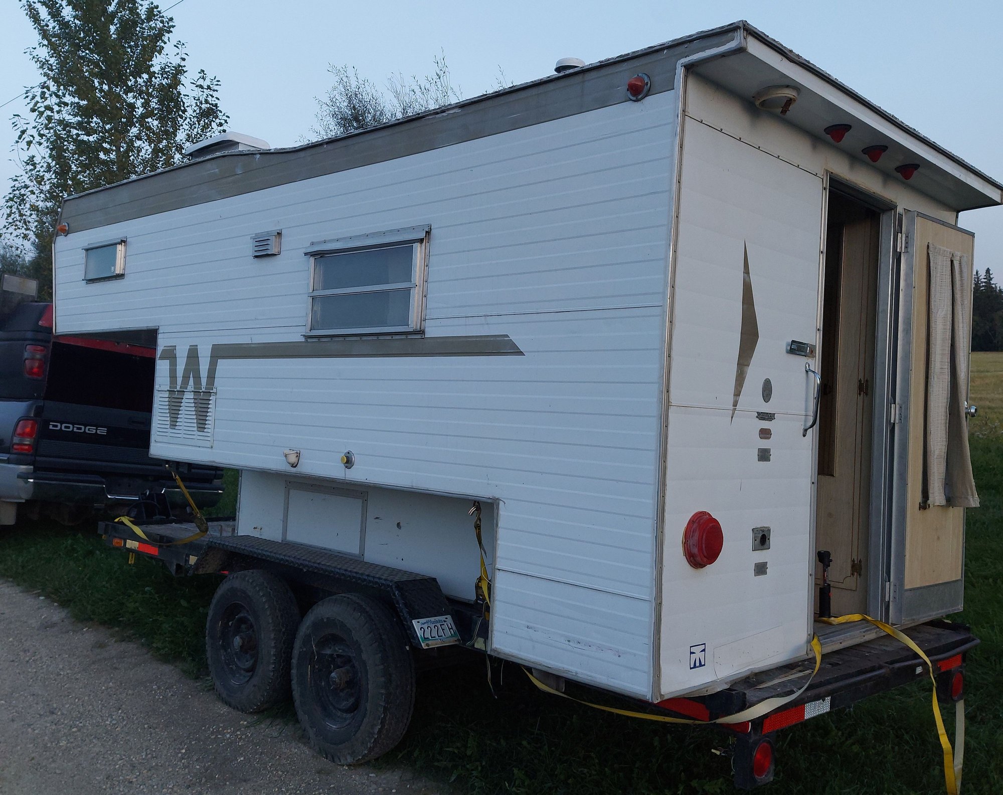

Finally got to see it this evening and for it's age it's in pretty darn good shape. I'm 220lbs and could walk all over the roof so it's solid, but there's for sure a few areas that will need repair on the lower level. From front to back(not including cab over)it's 128'' in length so WAY too long for my short bed, but I had it weighed and it's currently only 1420lbs and FOR SURE this is a project I want to take on! I'm 99% sure I'm going to buy it and reno it over the winter and this way I have a reason to get me a long bed truck ha ha ha. I've seen quite a few nice looking 7.3 CCLB 4x4 truck in BC for 5-6 grand so might go that route or might price out how much to turn my truck into a long bed dually
Here's a few pics from this evening, let me know what you fellas think.

Ok....so I've decided to buy the camper and will end up getting a long bed 6.0 or 7.3 in the near future to marry it to, but in the meantime if i can get the total camper weight down to 1000lbs-1200lbs do you think I'd be a complete madman running it over the winter in my lifted short box with 4 feet hanging out the back? I see dually rigs with those massive slide ins sticking out a good 3-4 feet so it's not uncommon or anything and it's a huge camper for sure, but 1200lbs is pretty light for an F250 even if half that weight is slightly behind the rear axle. I dunno....try and find out I guess maybe lol 😆
What you fellas think?

Not sure you'll have much left after removing almost half the weight of the camper.
