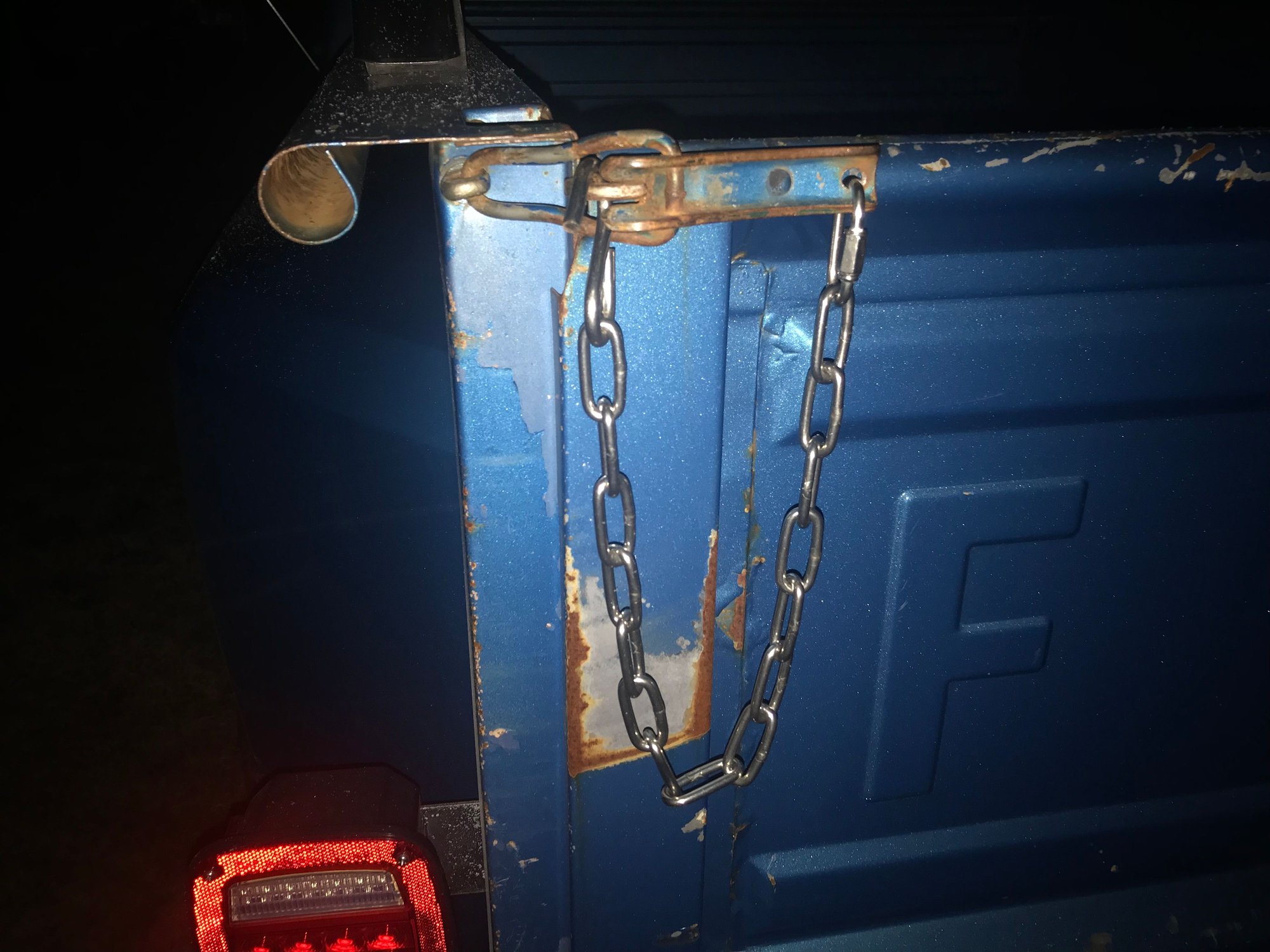

From: Pa
I understand what you are saying about the kids. I also understand that aftermarket chains are too expensive. As long as you have the factory latches and anchor bolts. You can construct the chains for around $25 bucks total. That’s what I did in second picture. Not the best picture because it was near dark. But they look very nice in person. I used all stainless steel chains and hooks. My gate paint was in that condition when I bought the truck. It was missing the chains. It should be easy to anchor modern gate cables. Maybe keep the chains if you like and add 1 or 2 modern gate cables to address the kids and keep the appeal of the chains. Or follow through with idea and fabricate it. Just giving you ideas that’s all.

I used bike tube over the chains to protect the paint and works great.
