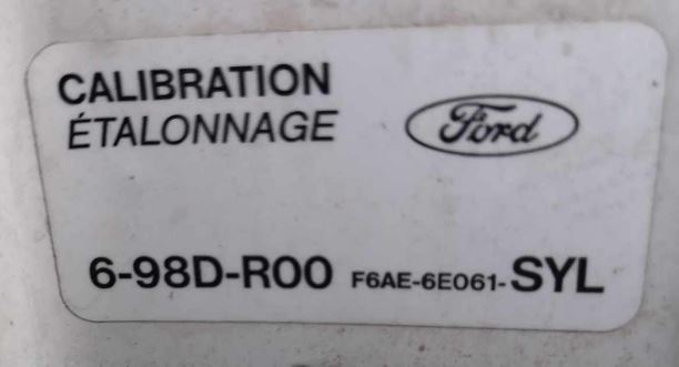

My calibration code doesn't seem to come up anywhere.. I have an excel sheet with seemingly every one except mine. Just wanting to verify im getting the correct PCM
The code is 6-98 D-R00

Can you tell us more about your vehicle, like the calibration on the door jamb , send a picture of it, send a picture of your Label saying when your truck was made and what engine/trans/axle etc you have in your door jamb too. Then tell us the Year make model engine/trans from your own experience, and telling us if its California or Federal emissions. you can find this on your VECI underhood, I believe its on the core support or similar on non 1996+ trucks but It could be on the hood by the driver(Like mine) if Im wrong

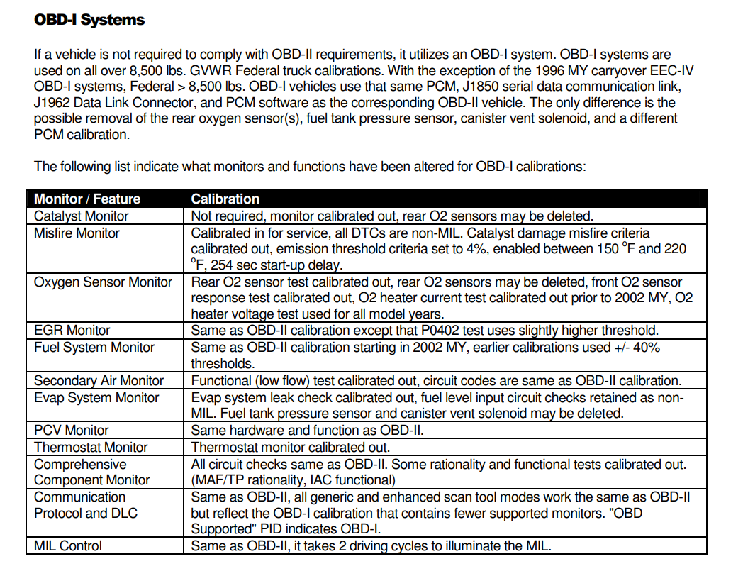

To be clear you have a code reading method of using the underhood connector, right? Not a dash one by the glovebox visible from the driver seat?
To my understanding a 97 f350 would have a EEC-V pcm but with dumbed down EEC-IV program loaded, Can you send a picture of your PCM connector on the firewall?

F6TF-12A650-BSA BCC0

Lol I thought it was a broken link when I tried it before(I love that website, lot of useful things like that OBD2 vs OBD1 info i found a sninp above for this thread)
But i was right, it still dont work. you sure its for newer?
Ford doesnt like 1996 OBD2 EEC-V's then
