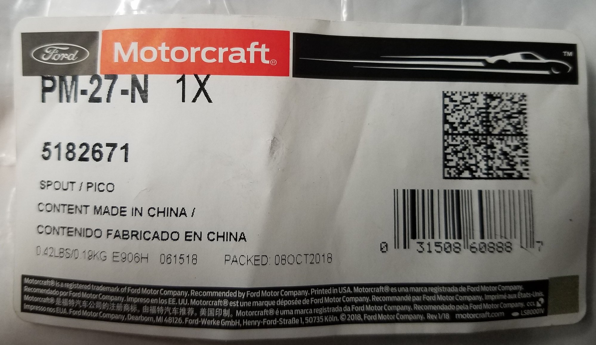

As winter approaches I make sure my DEF tank is not overfilled (or even full) so there is no possibility of it freezing and breaking. I almost always buy DEF at truck stop pumps where it might be possible to overfill it. If I fill from a container, I use the Ford nozzle which is supposed to prevent overfilling. Probably just being over cautious.
