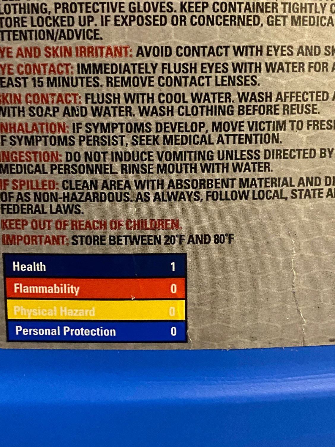

DEF Storage temp
Added my first jug of DEF in the 2020. I noticed on the label…yes I read the label, storage is between 20-80*. I guarantee the truck sees temps WAY outside this range. This is my first diesel with DEF. I was wondering what I need to look for or any precautions I need to take?

I'm not sure any. I don't tow and my truck sits in the driveway most of the time, so my DEF usage is almost nothing. I have the DEF that was in the tank when I picked up my truck in Feb 2018. So 3.5 years on the original DEF. I haven't added any. I live in Texas, so it does get pretty hot here. There is a sensor in the tank that will tell you the **** in the tank doesn't meet spec. All things decompose over time. I just can't say what that time is. You can also buy a refractometer that will show you the efficacy of the DEF in your dispenser or in your tank. If you have any concern, you should get a refractometer. They are not expensive.

Mine lives in a garage and is a daily so I should not surpass the 2 year shelf life. I’ll get a refractometer to ease my mind
