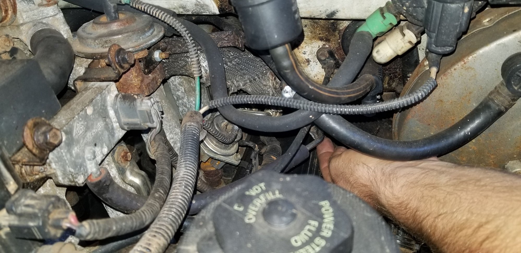

Without going into a long explanation, a good portion of the EVAP system is gone. I was wondering if the pipe in the pictures being broken/open could be affecting this? It clearly would be causing a vacuum leak, but I don't know if this could be the culprit.

Not the best photo, but if you look to where i'm pointing that is the line that broke and is now open.
Trying to point to the same line as in the first picture, but from a further out view.

Why don't you just plug the possible vacuum leak? Then you'll know.

Funny you should ask. I just did. No change.

That is the EGR tube you are pointing to
Has the two pipes that go to the DPFE sensor
1 bigger and 1 smaller, that is the pressure differential between the two hose sizes is what the sensor uses
I'd replace the broken EGR tube, before you cannot get one easily
Have patience, spray the big nuts with rust penetrant, use a torch to heat them up and then try to loosen them
