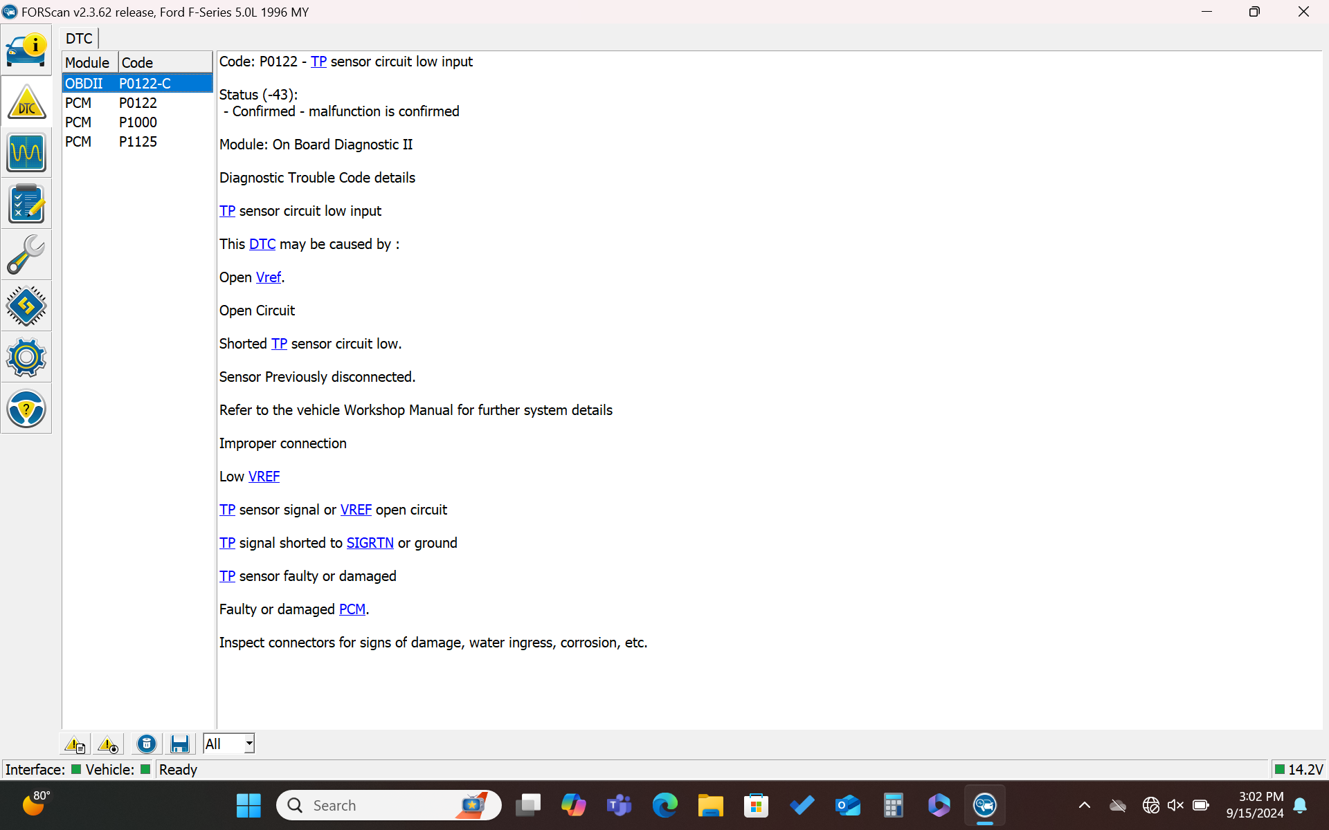

replaced the TPS today, it’s shifting better, but it’s still throwing PCM codes. I may have to check the wires to the pcm from the TPS, is that a super sucky wire trace?
I got the duralast TPS from autozone.
here’s the codes btw:

That Duralast TPS will cause you more headaches sooner than later. Use a meter to verify the output voltage key on, engine off. Should be between 0.6 to 1.0 VDC. Perhaps a bit higher for your model year.
Pretty straight forward to trace the wiring in my opinion. Not likely to be your issue given the code.

Tracing the wiring by looking at it is a waste of time. Check the circuit from the PCM to the sensor for continuity, short to power, and short to ground.
