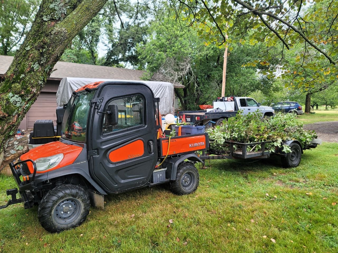

another little diesel that I just love, is her little Kubota RTV X1100C SxS with AC in the cab.... I am using it daily to water our trees.
that things fires up in about 1 second
you can see her '99 1 ton behing the SxS, it is still hooked up to her stock trailer, which is full of her household stuff...
