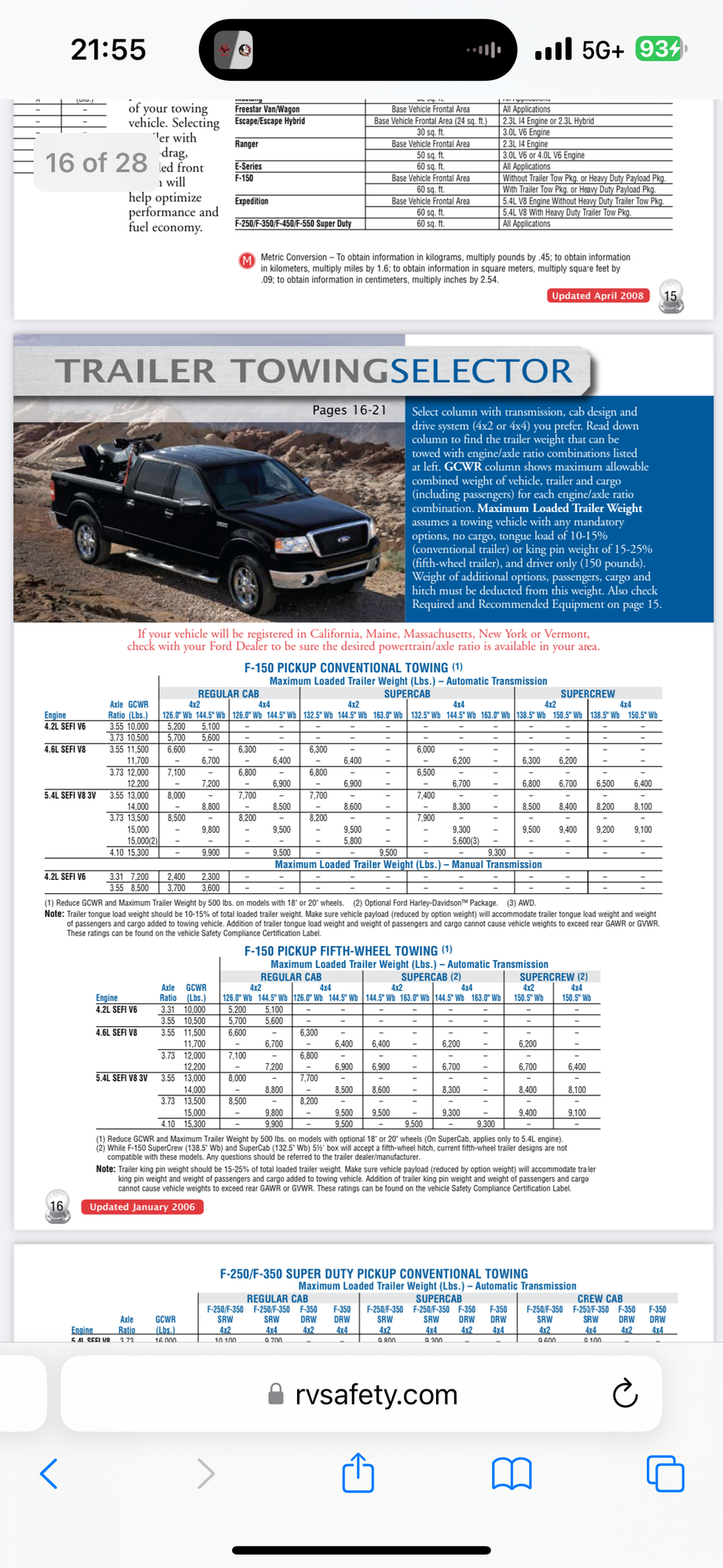

You will be quite a bit over (8200#, right?) and it’s going to hurt a bit more if you don’t have the transmission cooler already, which I doubt you would with that hitch/hitch rating. At a certain point, the cooling system won’t shed heat no matter how fast or slow you go. Take two trips if possible?
https://rvsafety.com/images/pdf/FordTG2006.pdf

If you can stand driving 230 miles at 45-55 mph, your truck will get you there.
im assuming a normally equipped super cab with 3.55 gears. So your tow rating is in the mid 6,000 lbs range with the towing package. You will be well above that.
You will be at the physical limit for the truck. Meaning, it won’t be happy but it will comply.
Expect 2nd gear up most hills at or near wide open. Expect 50-55 mph on the flat at 3/4 throttle.
Your biggest risk is to the transmission from overheating. The 4r75 is tough and can do a lot of work, but heavy loads create heat. that is your biggest enemy to the trans. The engine won’t care. It doesn’t make enough power to hurt itself.
If at all possible, install an auxiliary trans cooler in the cooler return line Before the trip.
The truck will do it. But just know that there is an uneasiness and sense of stress that comes with using a vehicle at its physical limit. Most people aren’t used to that kind of drive.
