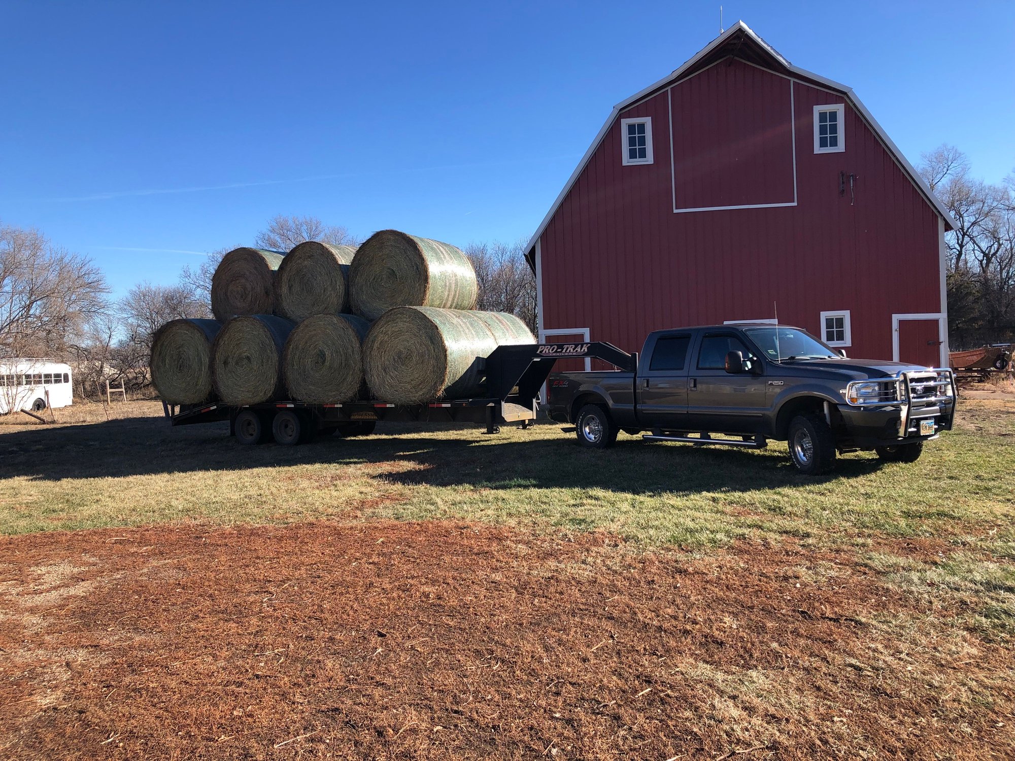

2x rated towing:
that’s in excess of 25k behind a 2004 f250 v10 rated for a little more than 10k. Not a one time deal, did 8 loads last year, 7 the year before and lost count before that. Truck is fine. Hammer down and let it buck.

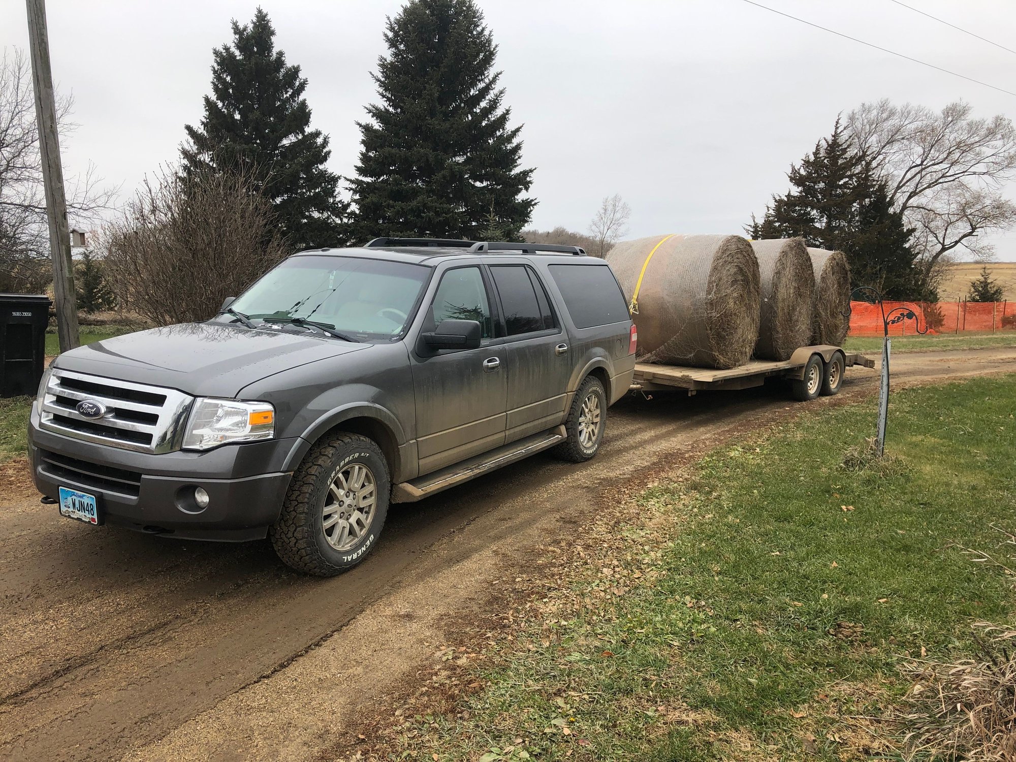

Full rated load:
this is around 8k behind a half ton. Handles great, just balance the load to control tongue weight and set the cruise at 65. Truck never cared. Pulls easier than the camper by a lot. Trailer is likely overloaded. Not by a lot but probably by some.

When we looked at the f250, truck says up to 14,000 lbs conventional towing capacity. In reality, it was much lower than that. Because of our configuration and options, our truck weighed in at 8500 lbs. add people, dogs, etc. and that weight goes to around 9k. 10k GVWR. Legally, our truck could tow a 6,666 lb trailer due to GVWR restrictions (15 percent tongue weight, 1000 lbs between loaded and GVWR means over 1,000 lbs of payload remained.
You complain about nobody running numbers and then go on to use an F250 rolling at 10k towing 7k as example of a setup that might be kinda suspect. This is why nobody takes you people seriously. And with opinions like that you don't deserve to be taken seriously.
Your average 99-04 of '05+ F250 with a job box full of crap in the bed, a few sticks of something on the ladder rack, two big guys in the cab and a skid steer and a couple attachments on a 10k trailer is in that ballpark. This is a combination that has for the last 25yr been proven to be generally acceptable for commercial use on public roads day and night, rain or shine and with all manner of employees of questionable decision making skill at the wheel. And yet here you are, telling us that's kinda suspect.
