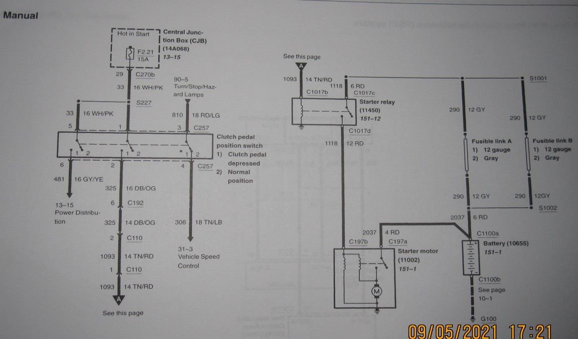

Everybody is telling you that there is not.
Maybe this will help confirm it.
It's from 2003. Hopefully that's close enough. If you have an automatic, there will be a neutral/park safety switch in place of the clutch pedal switch. Good luck. Don't over-complicate it. It's might be the most simple electrical system on the whole truck. Been the same for many many years. No offense intended.
