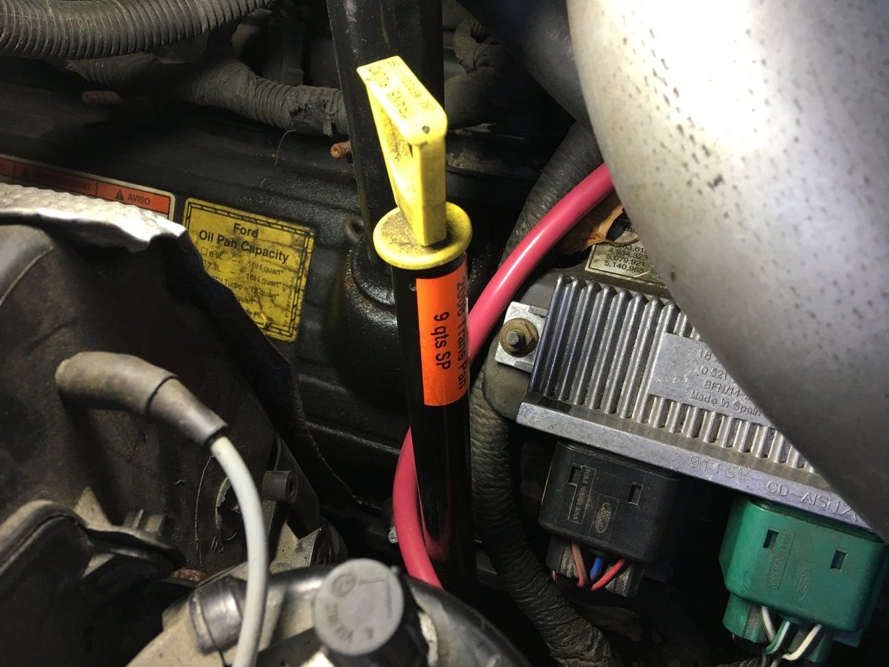

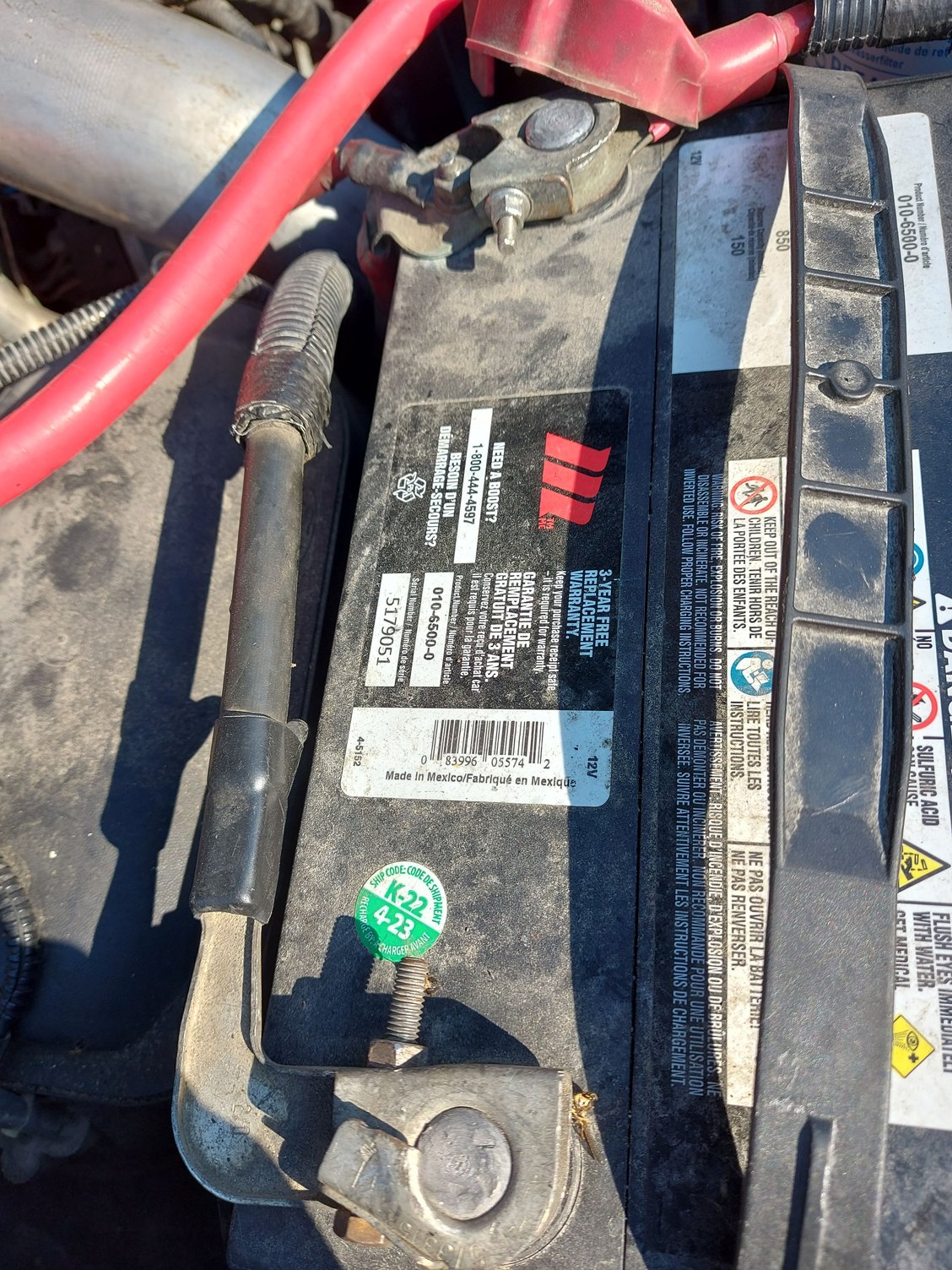

I'm not sure if my battery wiring is stock or not, but previous owner did a lot of upgrades so could be upgraded wiring already, but terminal attachments could be redone for sure. My goal at the moment is to remove all the unnecessary wiring that was added on for accessories that are no longer working/in place like running boards, flood lights, led strips etc and make sure my battery wiring is up to snuff including all grounds so today I'm removing the batteries, CAC tubes, air intake, alternator and whatnot to get better access to the wiring and when I put back together I'm putting in the Bosch 135amp unit to see if the current Napa reman is what's causing my idle rpm issue....and I'll also be upgrading the Airdog motor wiring once I trace it all down.
This is what everything currently looks like:

From what I see, your biggest issue are these bare wires. Not only for a short potential, but it allows moisture and humidity to enter the strands and promote corrosion. I'd tape them up.
If you search this site for my handle and the term voltage or wires, you'll find many years of posts.
A 4ga 18-24" hole to hole cable would work fine for you. It can be laid in this manner.
I've used Blue Sea fuses and holders on my truck and threads. You can also use these other fuse holders, although they require and additional cable of a few inches to connect to the battery.. The fuse size of 125a is good, the load is shared with the OE cable. All of this can be found on Amazon.

Also just to note, the wiring laid out in the pictures above, desperately needs some anti chafe and be tied / stood off. I’m sure it is just showing the layout, but wanted to make note for WPG.
