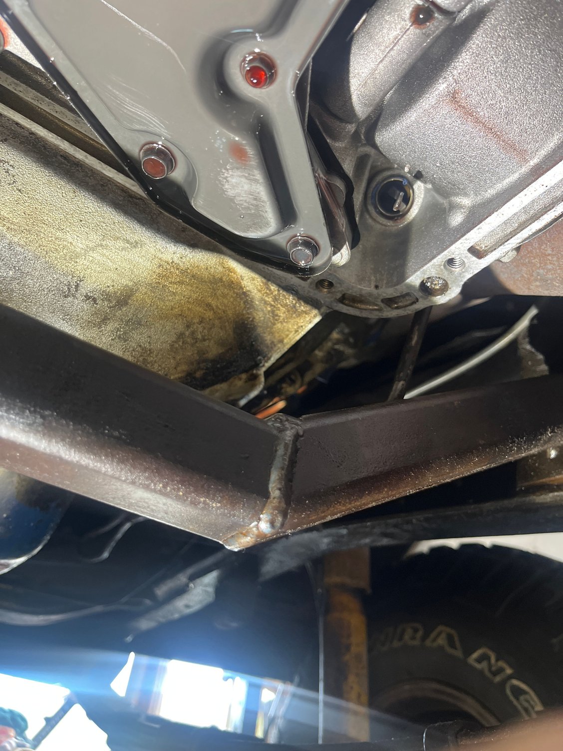

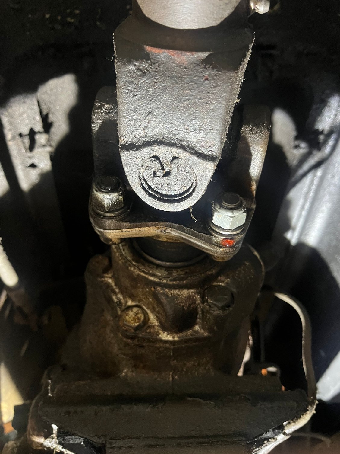

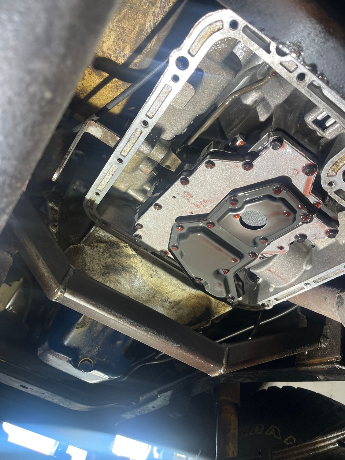

I keep finding oil here. Any tips what could be the issue?
I am also changing gaskets around levers and kick down.
looks «relativly» easy. Anything to keep in mind?
How do i remove the dip stick to change the oring here?
thanks in advance🛻🛠️🔧💉

Fluid is leaking through the splines and past the nut. Pull the nut off, slide the yoke out, brakleen the splines and the yoke, make sure everything is clean and dry. Slide the yoke back on and squirt a bead of ultra silicone around the nut mating surface of the yoke. Reinstall and torque the nut.

Removing the dip stick. Its just on bolt and pull it out or? 😂🤷‍♂️

One bolt, where it attaches to the bellhousing and then an o-ring where it goes into the case.
