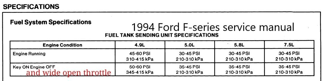

as long as it is above 40 it should run. I believe I read the 4.9l I6 runs higher than the 5.0l. My 5.0l hols 45psi but I think 50-55 psi is ideal.
