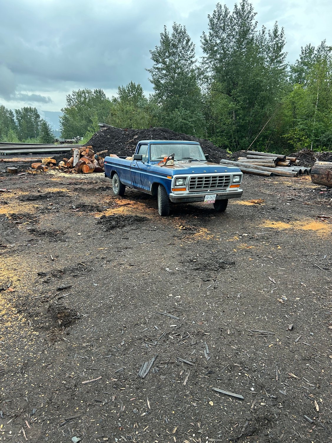

Hey everyone. New here and fairly new to the old truck world. I’ve got a 1979 f250 with a 351m. For some reason the starter does not fire properly. It doesn’t jump out far enough to engage the fly wheel properly so actually getting the truck started is few and far between. The starter has been replaced more than once. Battery is good. I’ve looked at the wire connections from the battery to the starter and they’re all good. I’ve really got no clue what is going on with it and why the starter doesn’t jump out properly.
any help would be greatly appreciated!
