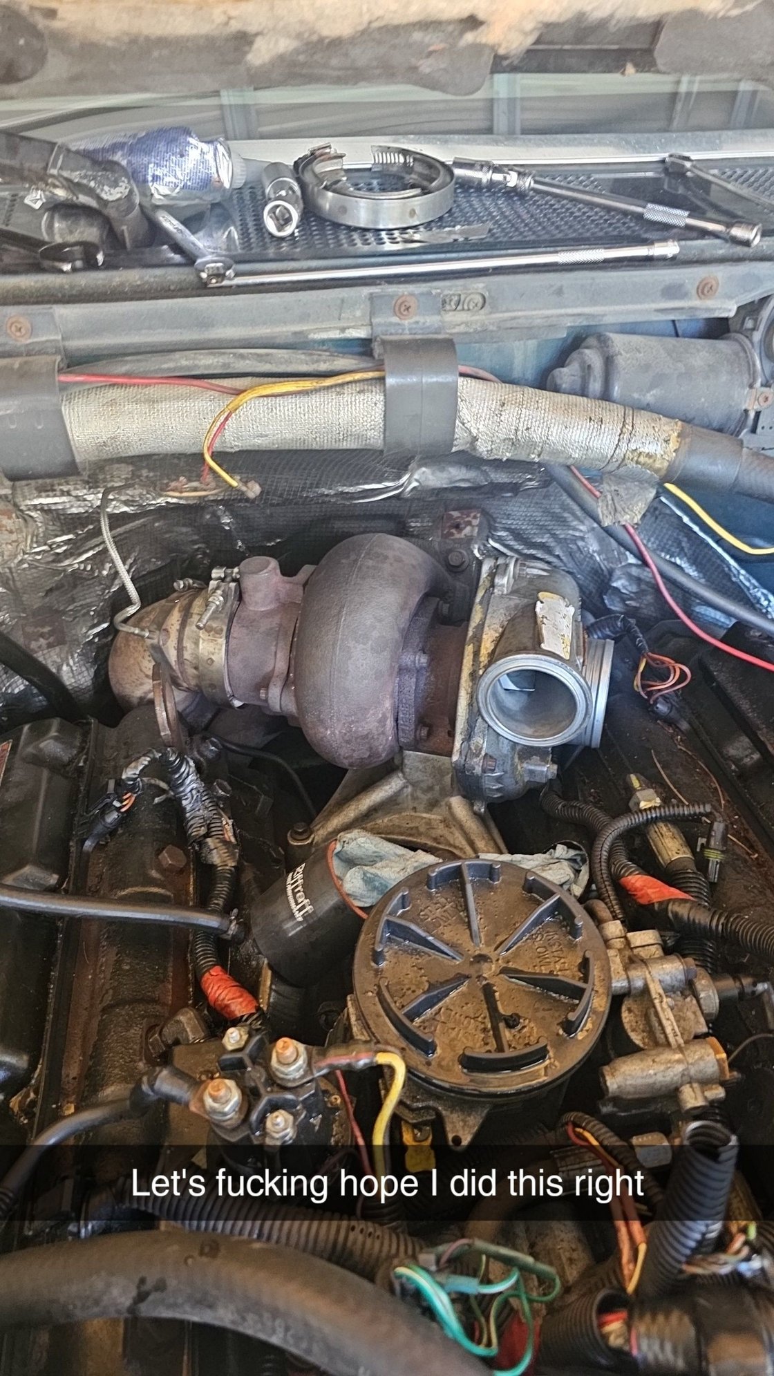

So I just removed my turbo on my truck to do pedestal seals I ordered from Clay, of course I was like a kid on Christmas when I got the box today got another sticker and a pen which was pretty cool. So headed out to the garage to give the old girl some tlc. Was having a hell of a time getting the passenger side nut, so I took off the ebpv and got a 15mm crow foot on it gave it a couple kisses with my impact and bam busted loose. So I wanted to put it out there for anyone struggling. I also found that one of my ebpv bolts is missing and thinking that could be contributing to a boost leak have to tap the threads and pray it accepts the bolt. Also I trust Clay but I also want to double check with the torque specs 18ftlbs turbo to pedestal and 18ftlbs pedestal to block for obs, 36ftlbs and 18ftlbs for 99 and up? Also what's the torque spec for collector to turbo? I bought a gasket from Clay for that also.

well got her all back in I did what Clint Allen suggested and used rtv with the orings so I'm letting it set before I start it to see if I have a Geyser. Replaced pedestal and block o rings, collector gasket with one from RiffRaff and bought the boot kit. I was about to go get those actually lol.
I want to state the wiring is not my doing and I'm planning on redoing it all

Old Aug 31, 2024 | 08:07 PM
Harveyearlolstad's Avatar
Harveyearlolstad
Joined: Aug 2019
Posts: 537
Likes: 119
From: Norcal
Noticing your picture, u may know this but your exhaust probe is on your down pipe and when you are monitoring temps take into account where your probe is located. From my understanding, you should only read 900 ish degrees max no more. If located on the manifold than 1200 degrees is the max for a limited amount of time of course. My exhaust probe is located on my down pipe also which I need to relocate just been putting it off.
Others please chime in if I'm wrong here .

nope you are absolutely right. I live in the rust belt so the thought of me drilling into rusted manifold has me nervous of all the potential issues like cracking, ect also juat procrastination. so I'm planning getting new manifolds and then drilling and tapping it in and fixing it then. Before my endeavor the last 2 days the hottest I've ever gotten the egt where it's at now is 600 700 so I will definitely keep and eye on that. That's the part I wasn't sure on is was the critical temp the same or was it less?
