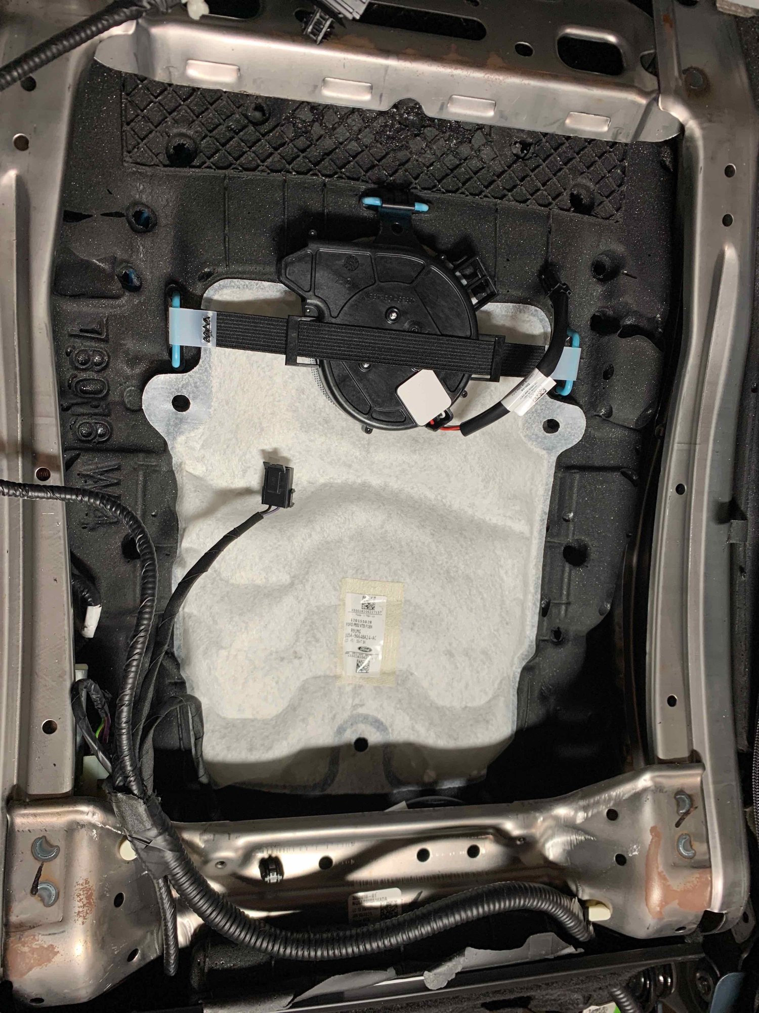

Here is a pic of the drivers' side seat back in my MY22 Limited (as listed in tag line below). The cooling seats is simply a fan that pulls cabin air and pushes it through a seat cushion and seat back perforated mat. I don't believe there is any way for A/C being ducted in the blower nor any type of cooled liquid ducted into the seat. Can't speak to other MY trucks, other than my MY22 Limited.

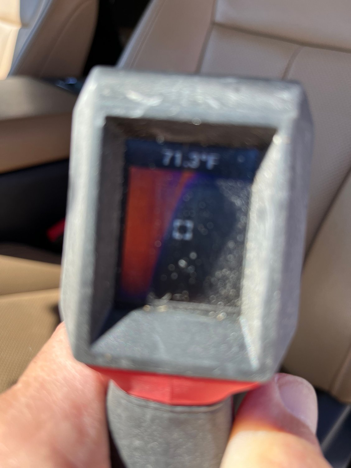

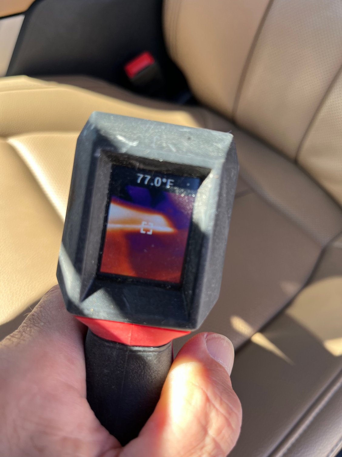

Kind of blurry, my infrared gun is not quite as defined, but you can clearly see the purple cooled areas in the "ventilated" portion in comparison to the orange areas of the "non Ventilated areas. Tells me they are cooled also. '22 Lariat. This after diving 1/2 an hour.
Did you have the AC on during that drive? There really is nothing (literature, parts) that indicates that Ford went back to a cooled seat. They stopped using the TED unit in the SD and nothing I have seen shows that it was reintroduced.

I had the climate on at 72 blowing out the dash vents at level 2. The door was open about 10 minutes prior to taking temps. 6 depress difference between ventilated section and non-ventilated right next to it. You can definitely feel the colder air between your legs. Not disagreeing about the parts list, but however it is designed it is definitely cooling in the seat bottom and back. Even in the mornings when I start it in the garage and have the air off but the seats remember the setting from the day before and are on you can feel cooler air within a minute.
