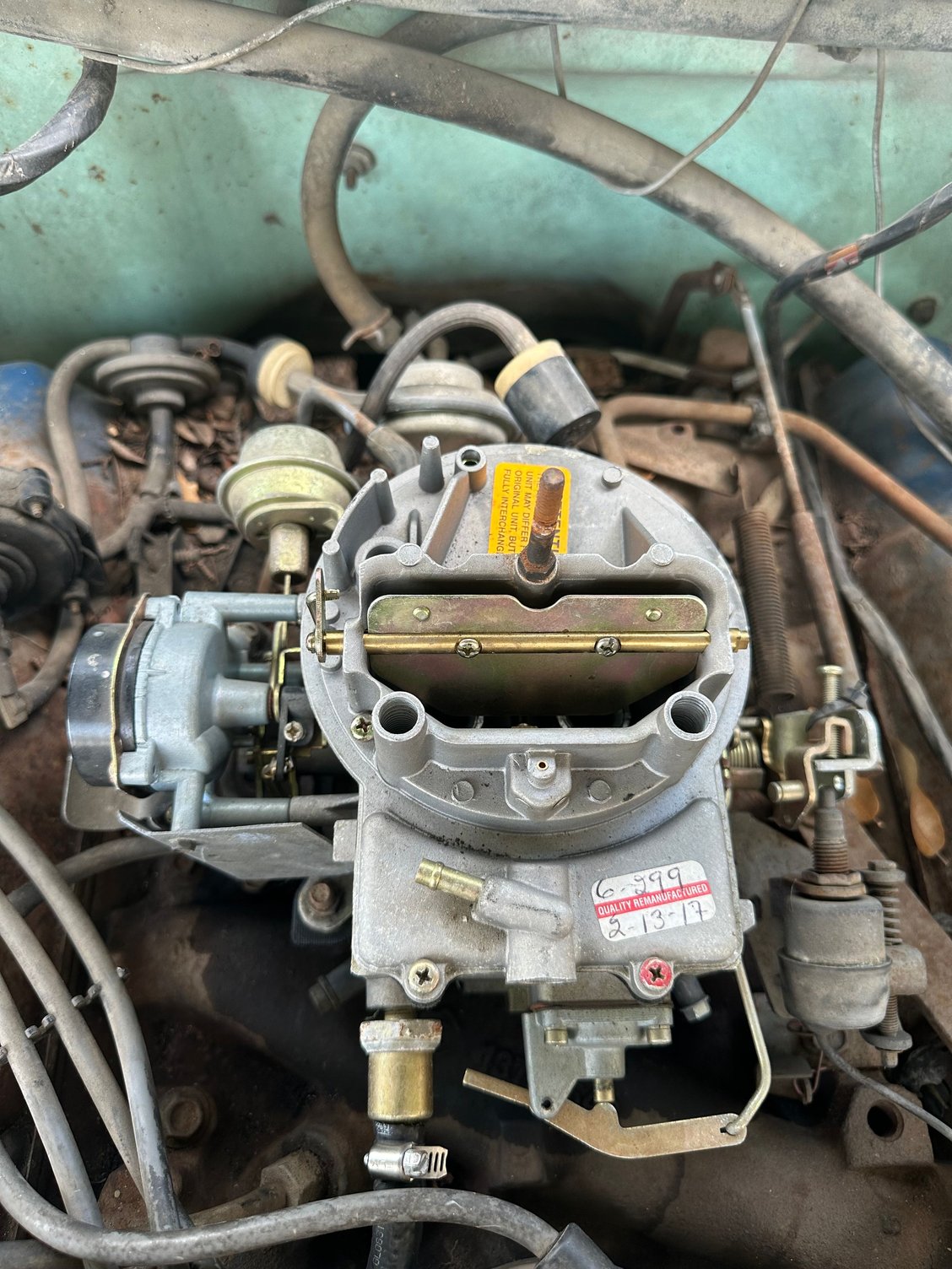

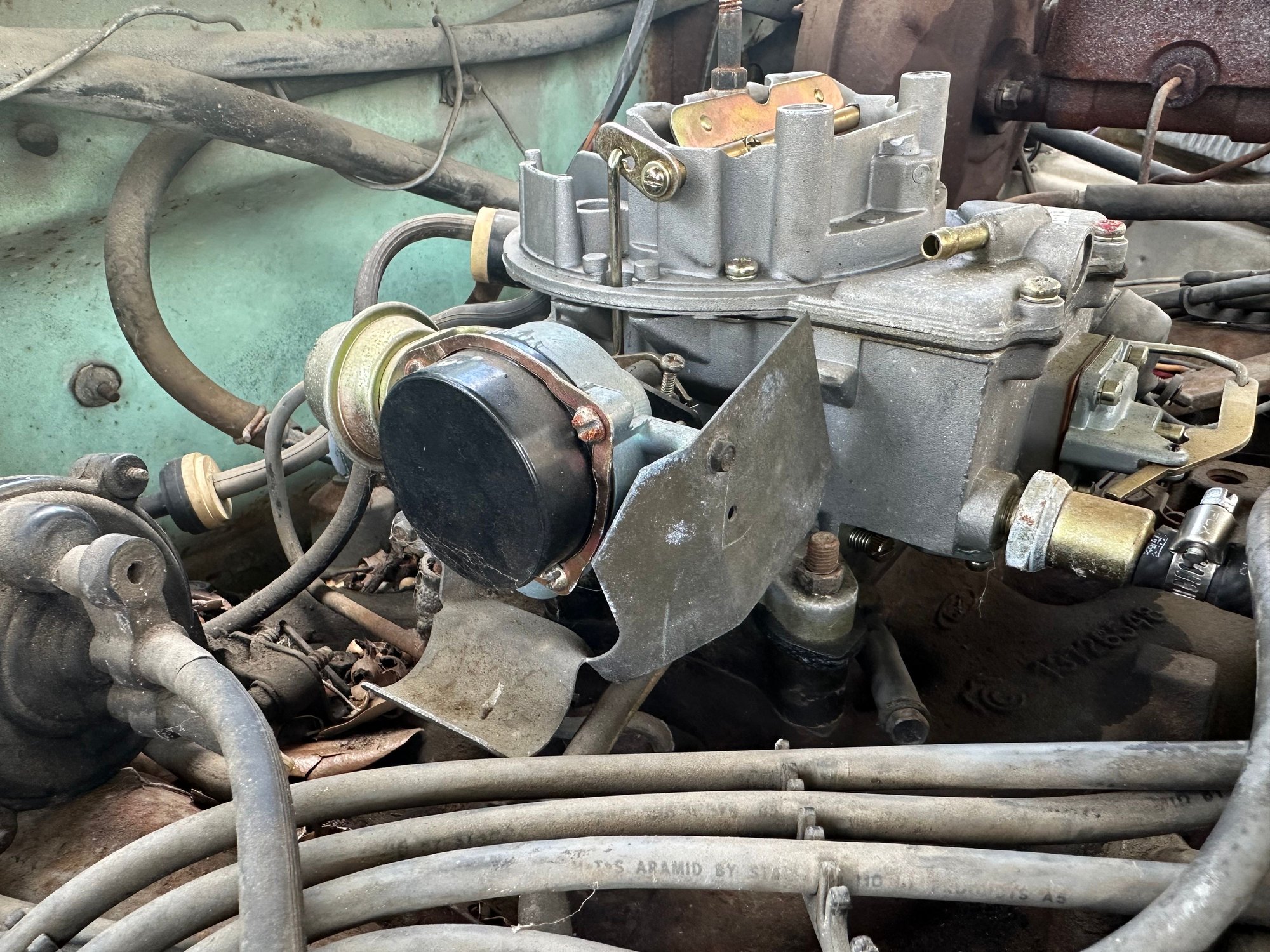

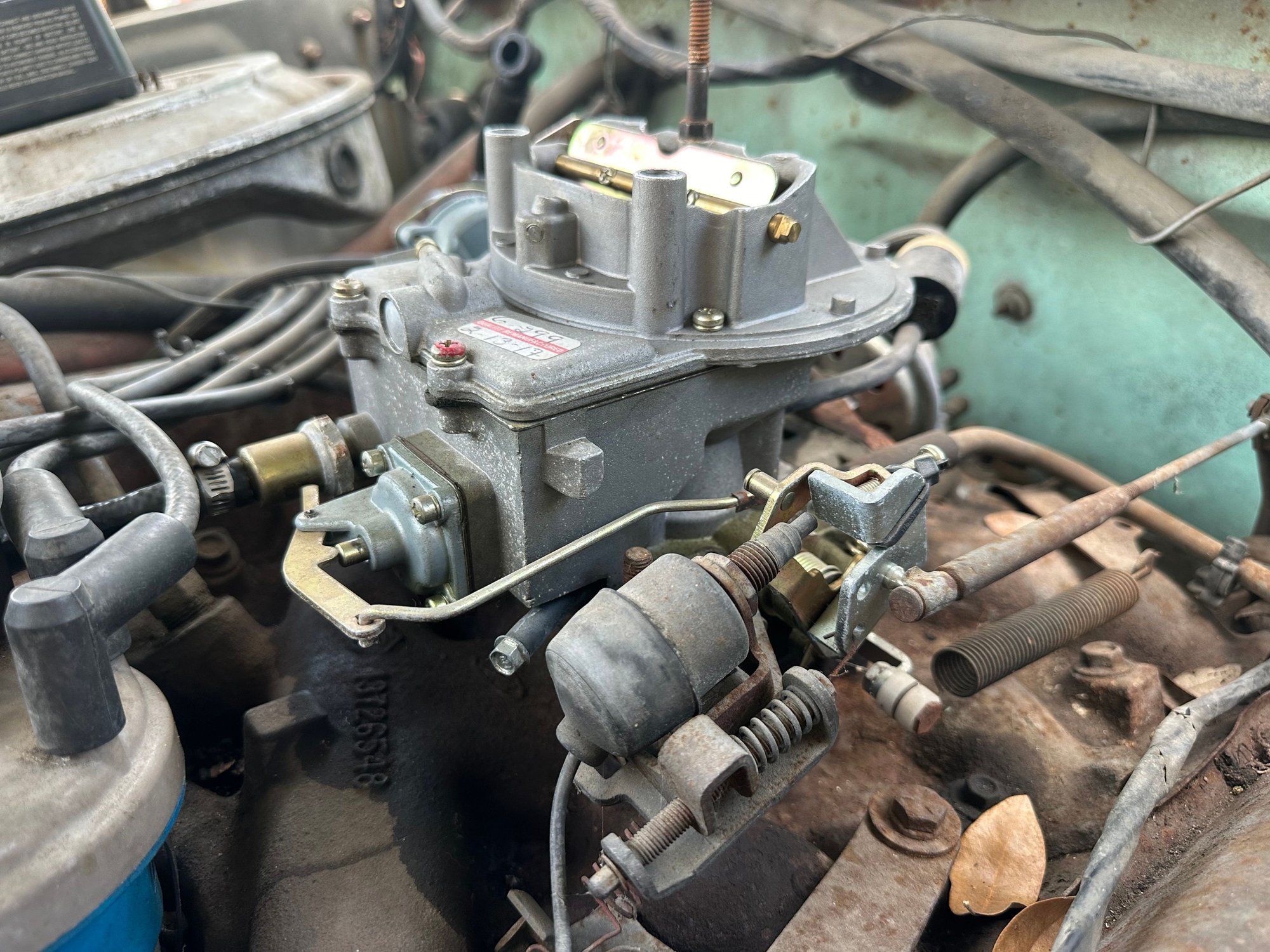

I’d rebuild it but I don’t know what it is. It’s aftermarket. I’d prefer to replace it with something better and more robust that is known. Here are some pics.

What carburetor is this? What do I need to rebuild it?

Looks like a Motorcraft 2150. Your local auto parts store should have a rebuild kit. If not, you can get one from RockAuto.com or any number of other internet sources.
easy way to tell motocraft/autolite 2100 apart from a 2150 is back base of the carb.
i think a curve in the back is 2100 and a flat backside is 2150

I guess since it doesn't say MOTORCRAFT on it, I assumed it was some knockoff and not actually a 2150. It is clearly a reman, but it seems to be missing stuff that the original would have had like the high idle solenoid stuff. Anyway, I will probably just take it apart and clean it good and see what needs to be rebuilt.
It looks like you have a solenoid for bumping up the idle speed.
What is it you think you are missing?

The solenoid is not plugged in and I don't know where it was plugged in. The connector is there. Not worried about destroying the carb. I'd love to have a reason to put a Holley 2300 on it. I like quality, but I want to get it sort of half *** running and let it run for a while to make sure I don't have any other engine problems. If I do, and they require a rebuild, then Smeding Performance will be employed to get that taken care of with a 427 Windsor. Not going to rebuild a 351.

IN my picture, the idle stop solenoid has been disconnected. Looks like a single wire plug. Where does this wire plug in?
EDIT - FOUND IT! It still works. Why would they not hook that up and make adjustments? Anyway, I have a rebuild kit for the carb on order. Should be in tomorrow.
Fuel is leaking out the weephole in the accelerator pump, so, that diaphragm, while not awful, does have a leak.
