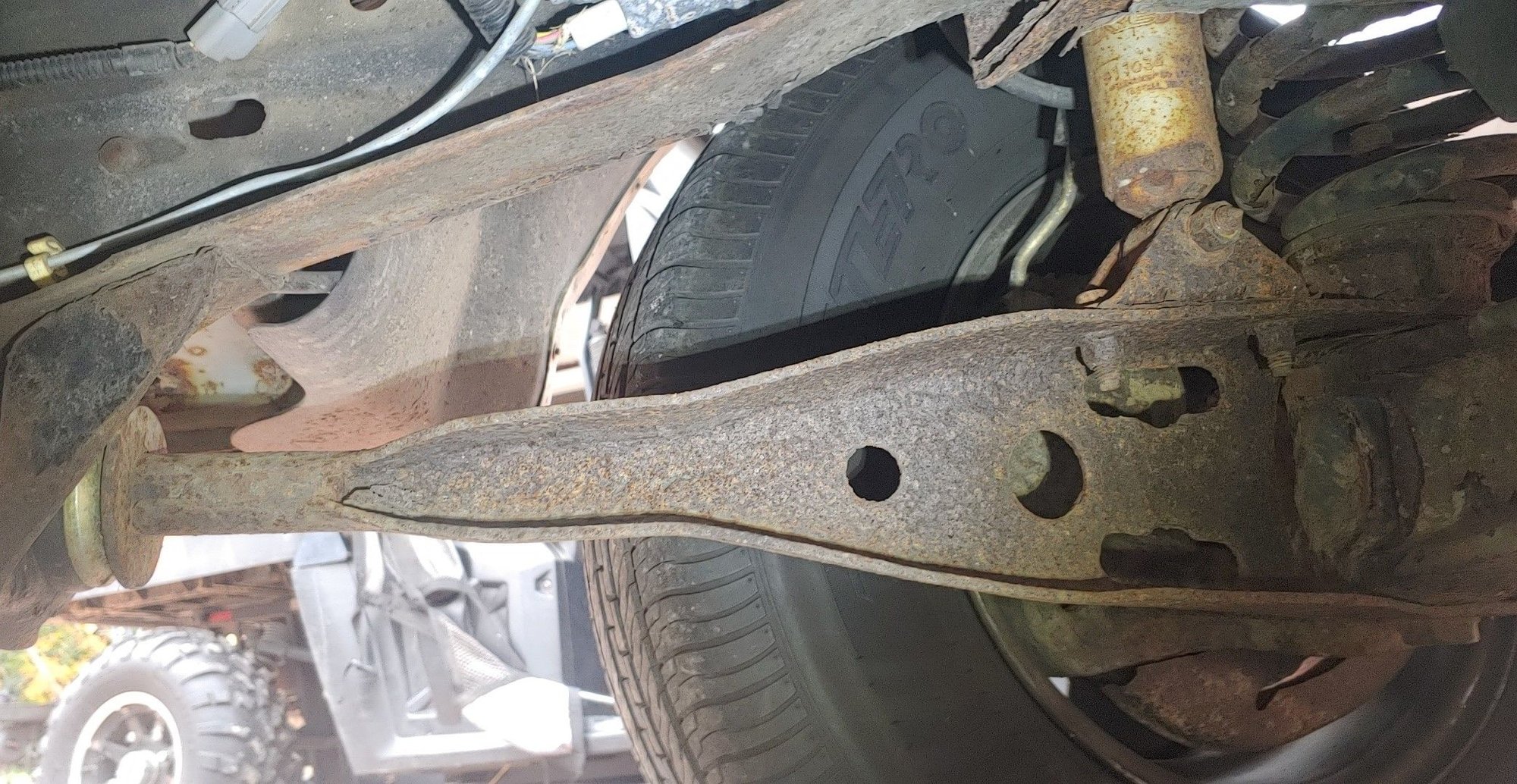

So what’s the problem? Jack it up by the radius arm, radius arm track or frame. Place the stand under the I beam.
The F250 radius arm is a lot more beefy than the F150 I hope, id fold in the radius arm on my f150 trying to jack it up lol!

Originally Posted by AuroraGirl
coughs
Hi there.
I took that as a Married with Children joke
It shouldn’t be that delicate since it is locating part of the front axle. That was in listed in my ‘89 manual as a jacking point for a F-150
Maybe Ford does not show it as a lifting point for your ‘96? I don’t know.
Old Aug 25, 2024 | 07:55 AM
AuroraGirl's Avatar
AuroraGirl
Joined: Jun 2021
Posts: 5,219
Likes: 805
Hmm.. I guess it can be used. Well, I wont be doing it on mine because they are quite rusty. Is it rusty enough to be weak? no idea but id rather not find out lol
