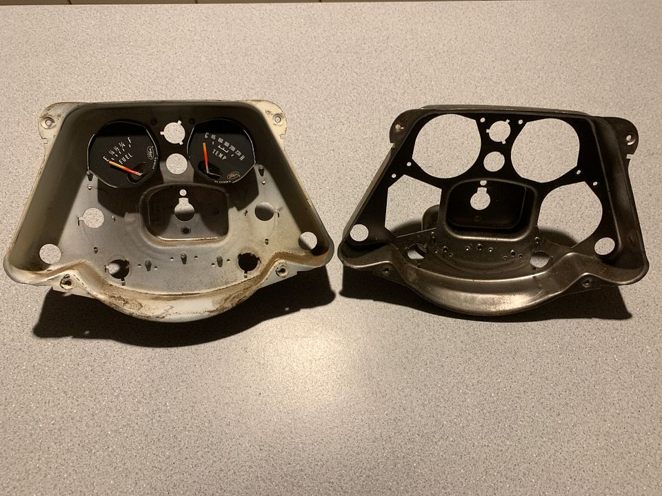

The housing that holds the speedometer came in two major forms. @PoolFixer mentioned Bronco with all gauges and no idiot lights and that was what some of the trucks came with, too. If just idiot lights it used the housing on the left. But, if installed with a full complement of gauges you got the housing on the right. You can see the two extra larger openings for the oil pressure and AMP/GEN gauges.
Left is C1TF-10848-A
Right is C1TF-10848-B
The one on the left is from my 1964 and I'm planning on switching to the one on the right with full gauges installed for that truck.

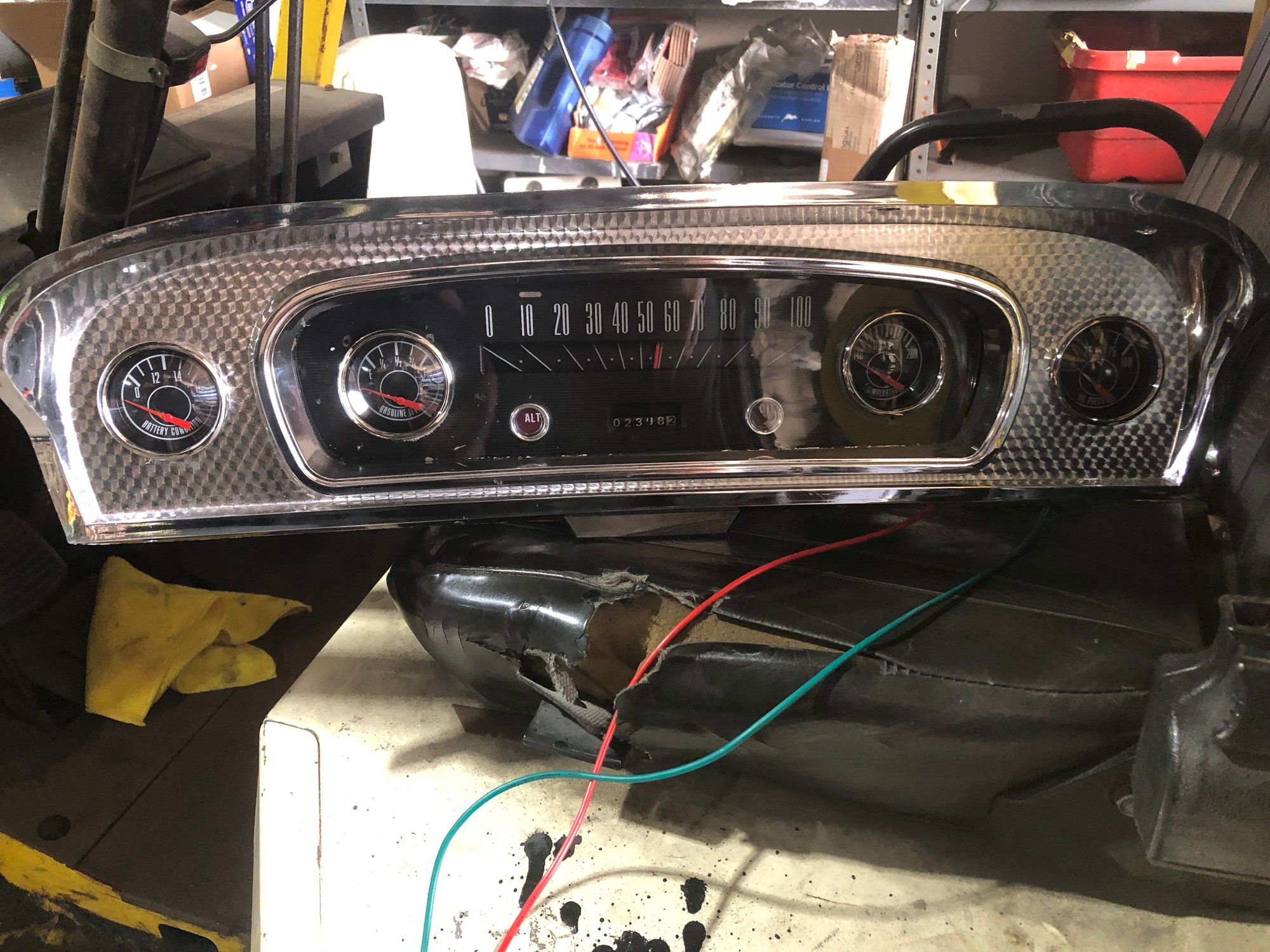

circling back to this.. got the gauges installed. Not my best work, think my holes are slightly askew but when your'e driving it's hard to tell. It's nice knowing what's going on when i drive now. I don't know what I did but since the swap, the speedo does not work. sometimes it says 60 mph when I'm stopped, sometimes it won't move at all. cable is in there very securely but something is amiss. I didn't exactly get rough with it when it was out and not sure where to even start troubleshooting. it.
