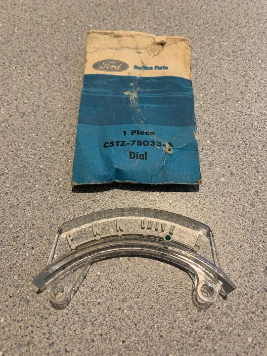

Just FYI - the tin piece around the ***** below the speedometer was originally only installed in 1963 and 1964 Custom Cab trucks so someone added that to your truck. This truck didn't come with emergency flashers which they would have used the empty hole for the switch, and they'd add another one to the left of that as well for the indicator light so 4 items total on that side of the column. But, without that the empty hole would have just been a chrome blanking plate.
The column is from a newer truck. The shift lever is the newer shape with the newer ****, and it has the replaceable plastic pointer instead of the built-in shark-fin pointer on the shift bowl. Also the plastic indicator doesn't have the Green Dot and DRIVE wording.
YES, THE SELLER TOLD ME HE HAD THE TRUCK CONVERTED TO POWER STEERING MANY YEARS AGO YOU ARE CORRECT DEFINITELY A NEWER COLUMN. JUST WISH I KNEW EXACT YEAR/MODEL IT CAME FROM. PREVIOUS OWNER NOT A MECHANICAL PERSON AND IM SURE HE TOOK IT SOMEWHERE AND SAID I WANT POWER STEERING AND PICKED IT UP AND PAID HIS BILL AND IT HAD POWER STEERING AND HE WAS HAPPY. I DON'T NECESSARILY MIND IT, IT'S NOT TOTALLY OUT OF CHARACTER FOR THE VEHICLE.
