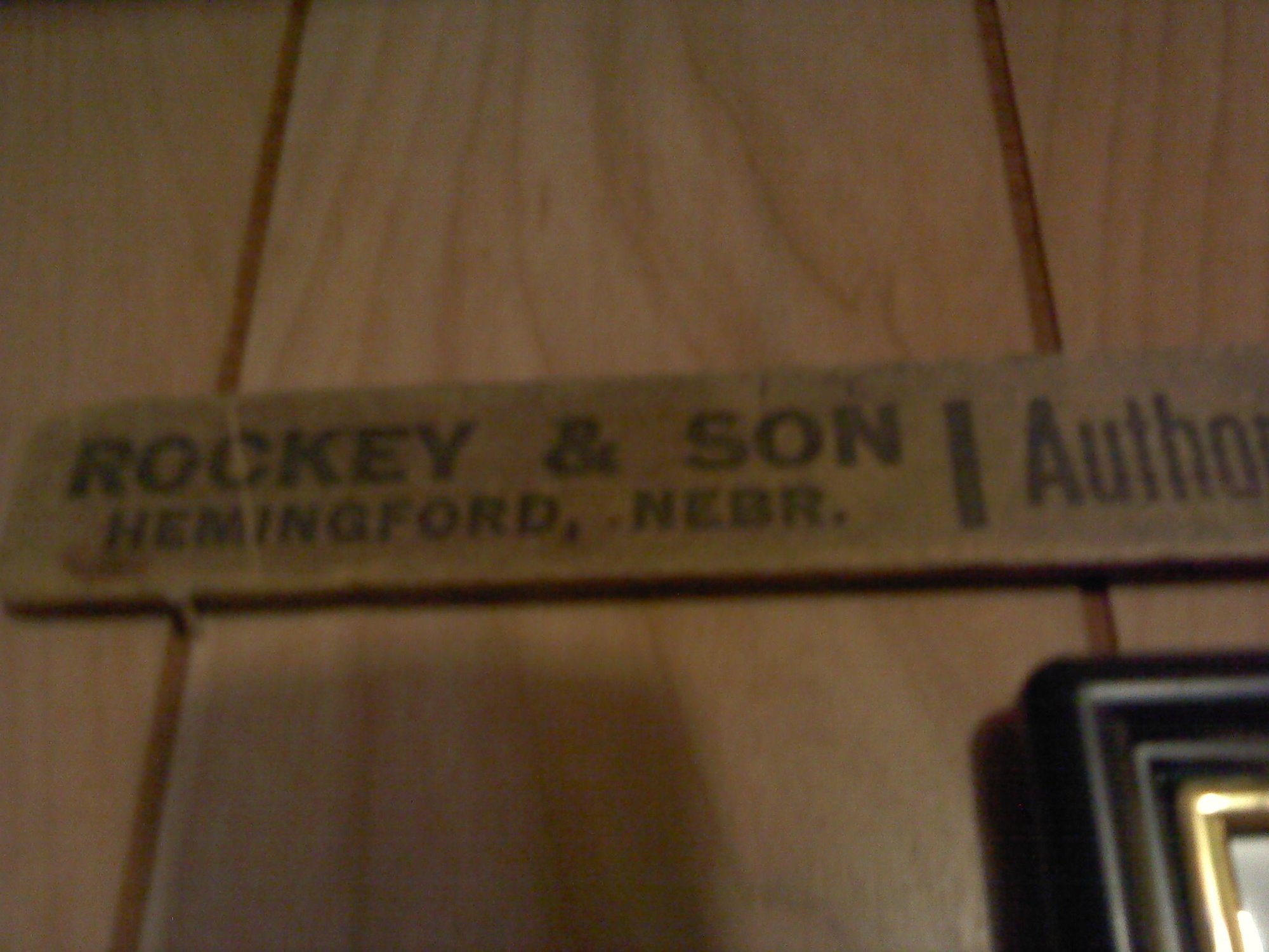

My dad has this hanging in his office, Model T fuel gauge from his granpa's dealership in NE so Ford's were in the blood so to say...
