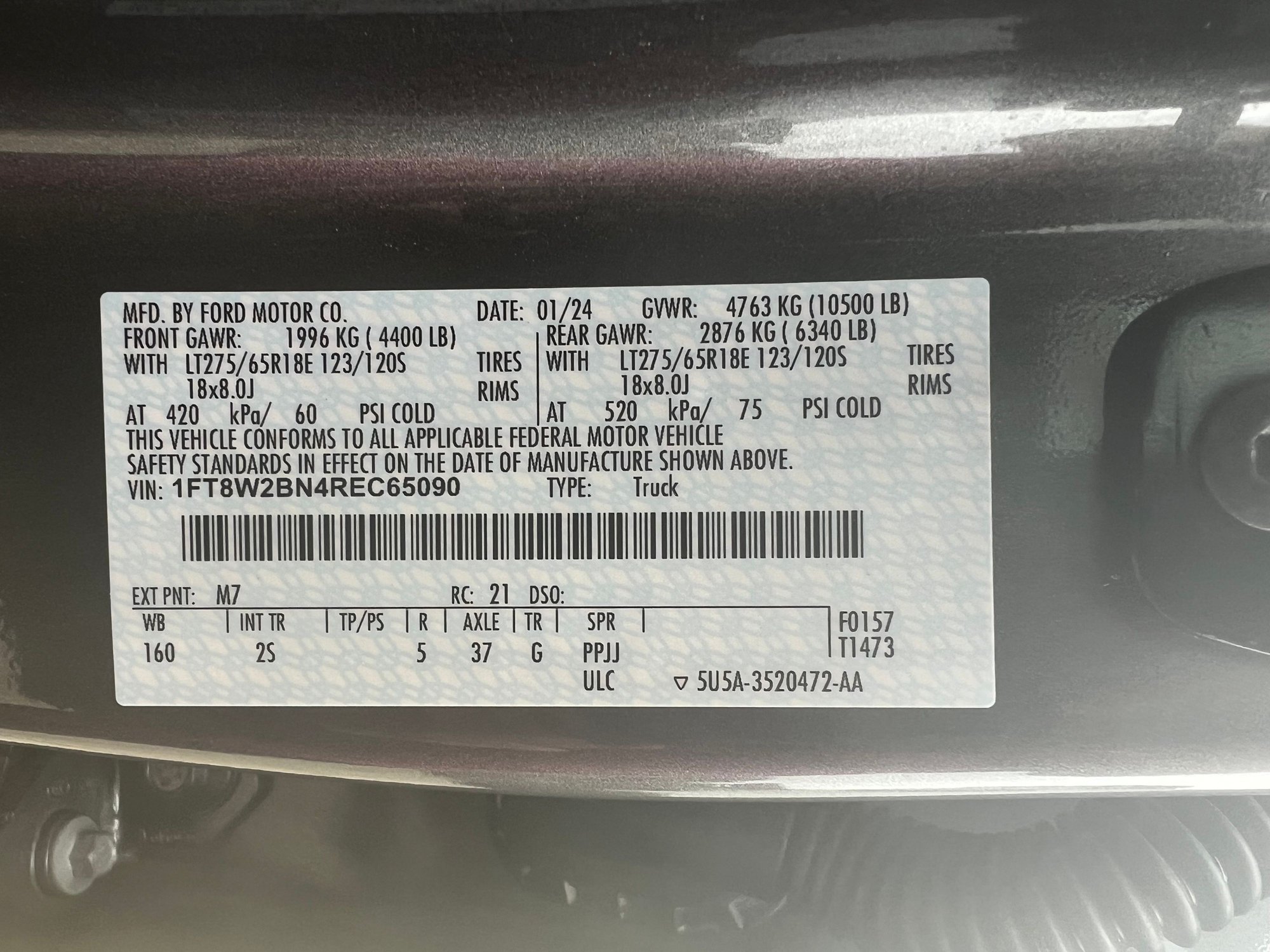

Can you look on your driver door jamb for the white GVWR sticker and tell us the Front
GAWR? It would likely show (5990) or (5600)?
Those ratings drive front spring that Ford installs. You can put the next lower rating spring in to improve ride.
Tremor springs come in similar ratings, but are 1.25 inch longer.
GAWR is 4400 lbs so I don't think it has the camper or plow package on there.

On mine, the front jounce bumpers were too close to the axle in stock form. That's where a lot of the harshness on bridge joints and railroad tracks was coming from. The 1.5" leveling kit actually improved that because now the springs and shocks can do their jobs.
It's still rough though. Yours with a gas engine could maybe be softened up with lower rated springs. If it's got the 5600 lb. springs up front then try 5200s.
You already have the soft version...
