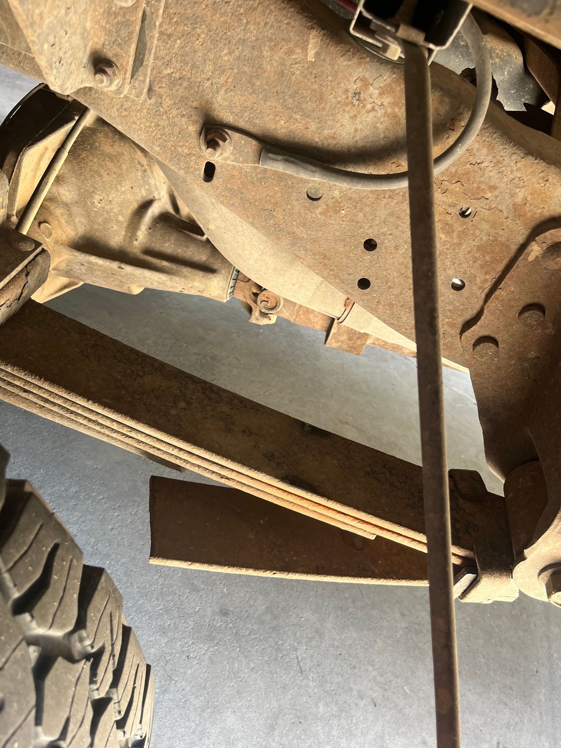

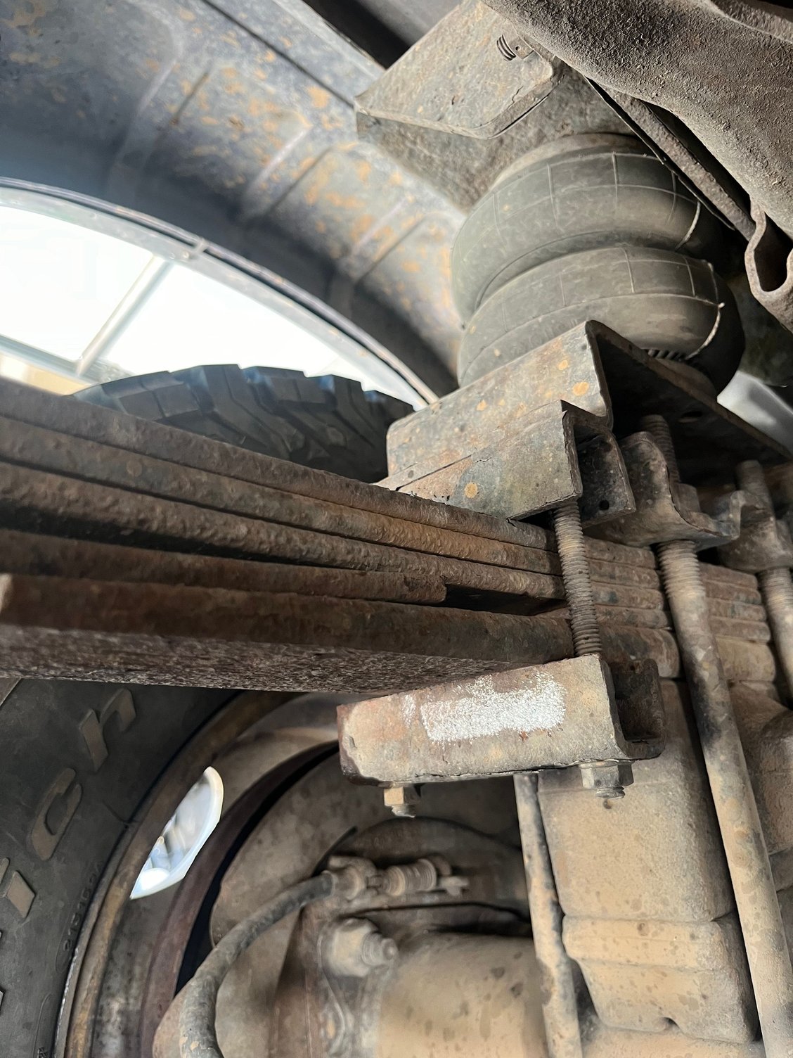

Nuts!! Noticed this when I got home yesterday. One too many washboards for this ol’ girl haha.
Talk to me about leaf springs if you got a minute. I’m seeing aftermarket springs on rock auto (Dorman, Husky, etc) for a decent price but I’m unsure if they’ll be reliable. My truck sees a lot of dirt roads here out west.
Also do I need to replace them in pairs? Trying to decide if it’s worth attempting the replacement myself….
Have not done the H&H mods is now the time to remove my bed and do that as well? Might make the springs a little easier to change with the bed off.
Anyway just trying to get a game plan. Any help would be appreciated. Thanks!

I replaced both of the rear leaf springs myself after buying them from SD Truck Springs. They have held up well over the years towing heavy.
It is not a bad job, just be sure you have stands to support the frame and two floor Jack's to support and maneuver the axle.
There is a site sponsor that sells springs, I believe it is ATS, but I could be wrong.

ATS has done a lot of us good and I would use them again. Tell them what you're doing and they'll fix you up with a spring. Rear springs is a brute job, not a science job but you'll need to jack that frame up about three feet so get some good jacks and cribbing out, you'll be surprised at how much flex is in those springs.

Yeah the 6 ton stands from Harbor Freight are just about perfect for these trucks and not priced too bad. Well at least not when I bought my set, who the hell knows now. A good impact wrench is very helpful as well. if Sous say the SD springs are good I'd go that route. I can tell you the Pro Comps on Amazon won't last. I broke both rears of a set of Pro Comp within 2-3 years. Dorman can burn in hell so SD gets my vote. Don't forget to buy new u bolts too, and if you don't already own one you'll want a torque wrench to make sure everything is spec when it goes back together. I'm not usually a big torque spec kind of guy, that's one area I will go drag the wench out and do it right. Kinda scary when you think that only 8 u bolts attaching the whole truck and it's contents to the axels and wheels propelling you 80mph down the road.

Check a for a local spring shop, heavy truck shops or parts stores should be able to give you a reference. Let them put a leaf in and you're good to go.

I used ratchet straps to hold up the axle when doing leaf bushings last year
have a spare jack handy as the pumpkin will make the pinion side point down
PBlaster it for a couple days helps getting bolts off and i cut the u bolts as mine were too rusty

I paid $414 in 2015 for 2x rear OEM spec leaf springs with all of the associated hardware with a $30 coupon and $105 for shipping via UPS. Although, now when I click on the email receipt, the website appears to be inactive and if I Google SDTruckSprings, my browser warns me about suspicious activity.
At this point, I cannot recommend SDTruckSprings to and would suggest you talk to ATS or another vendor you find that may have earned your business.
I had tall jack stands for the frame support on each side and 2x floor jacks. One is a heavy duty 3.5 ton and the other is a lightweight 1.5 ton or so. Having the ability to raise, lower and move the axle to get it in the right place with the two jack stands was key to my success.

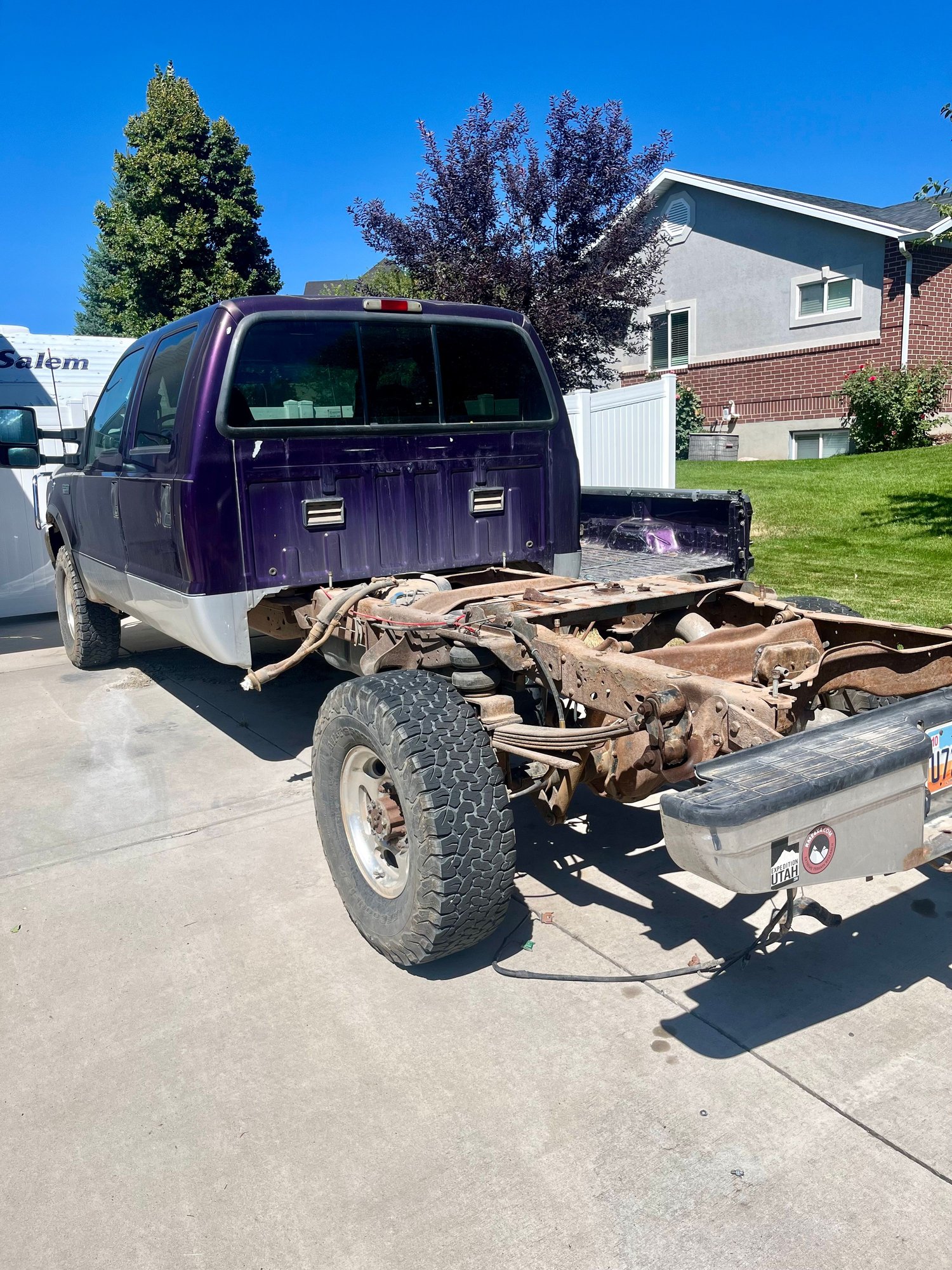

10-4 thanks Sous. I really think I’m gonna pull the bed and do the hutch and harpoon while I’m at it. It’s a lot of work but I think I could kill two birds making the springs easier to get to.

Thanks again fellas, I’ve axed the heads off the bed bolts so it’s ready to come off. I’m pretty set on the spring upgrade I’ll be sure to post some pics and take you guys along for the ride if I do end up going that route.
