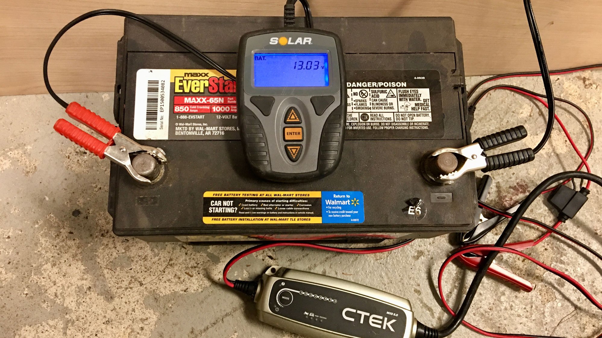

From my experience, it seems that some brands of wet cell batteries tend to do it and others don't as much. I use AGM batteries now, so no issues there.
@TooManyToys. uses Walmart batteries and has not had it happen to him with that choice.

You can have a gap in the case where it surrounds the post and it wicks into a he terminals. For the last few years Ford has had a bad issue with the assembly line batteries like this. But it can happen with any brand.
I’ve not had this issue with the Walmarts I’ve been buying since 2014. I have 12 batteries in vehicles, tractors, equipment.

I've had Walmart's Everstart Maxx batteries since October 2022. Sorry to report mine have the same problem, and it's been going on for many months. Same with the Everstart Maxx in my wife's Tundra, and hers is only 8 months old. I wonder if it's the extreme heat we get down here in TX that causes the case to fail.
I'll be spending the extra $100 on AGM's next time around.

I just called the 888 number listed on Walmart's website for warranty info. They said the corrosion is caused by over or under tightening of the terminals to the post, which causes micro cracks in the case, and is not covered under warranty. The things that make you say hmmmm.....

Hard to overtighten with the style of terminal we have.
You may be right about the heat; I see none of that. Do your Walmarts have caps, or are they vented with a small nipple at the side?

Caps on batteries in both trucks.

Different construction and possibly different suppliers.
