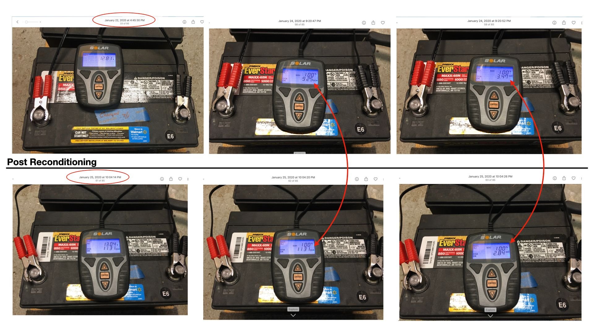

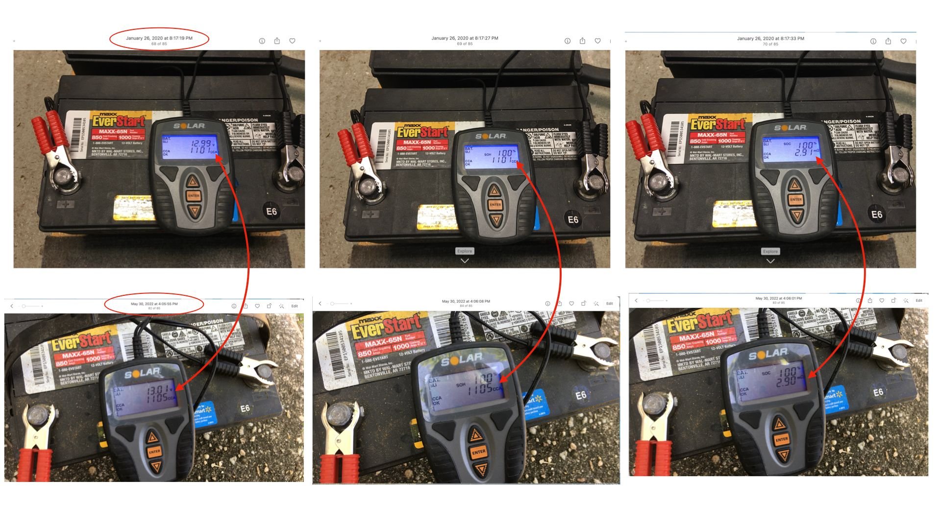

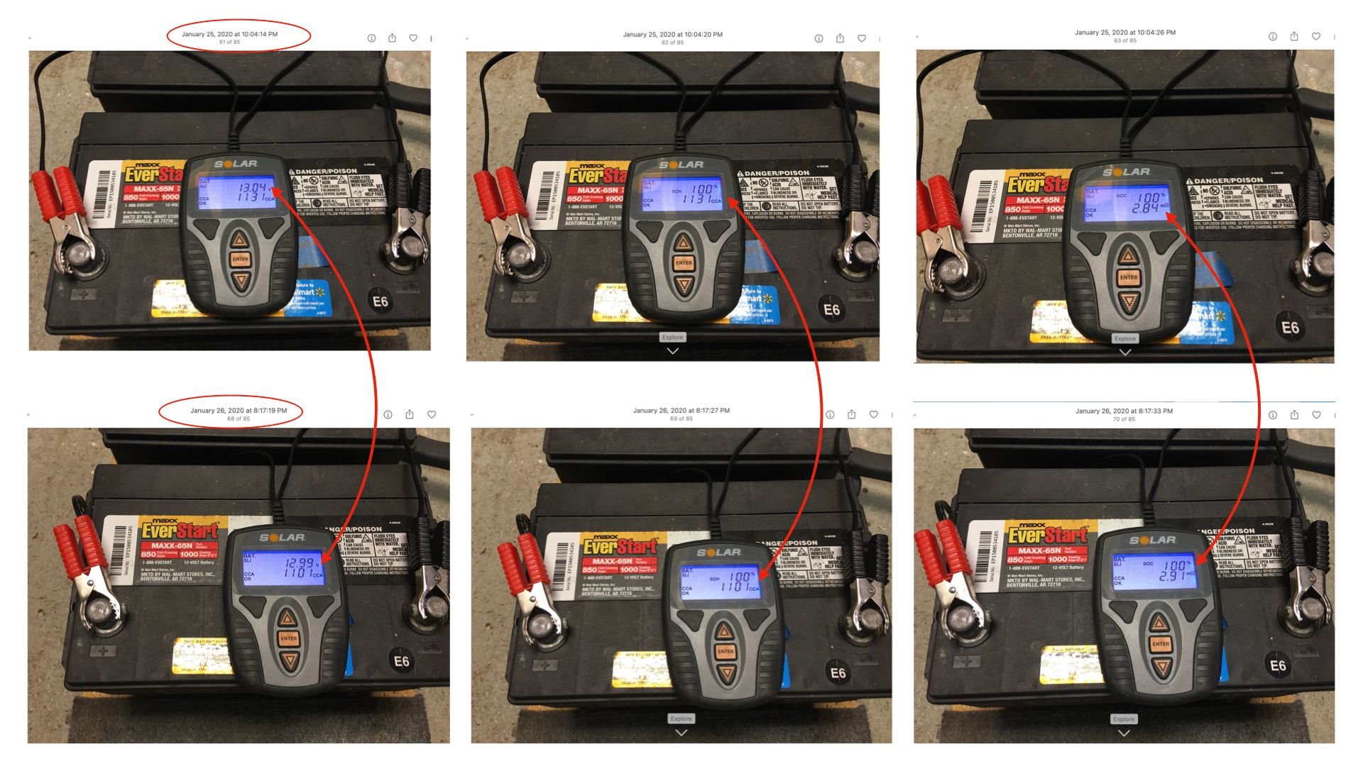

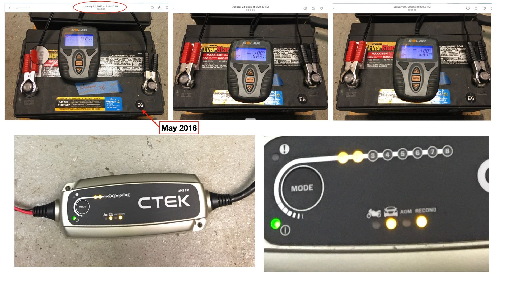

Over the years, I've found that periodically putting them on a tender or charger keeps the capacity up and gives them a longer life. I also use my CTEK (NOCO similar) with its reconditioning function (~24 hrs), which really helps.
I still have my Wlamart 2016 batteries in my truck. Ten years ago, I would have said that was impossible.

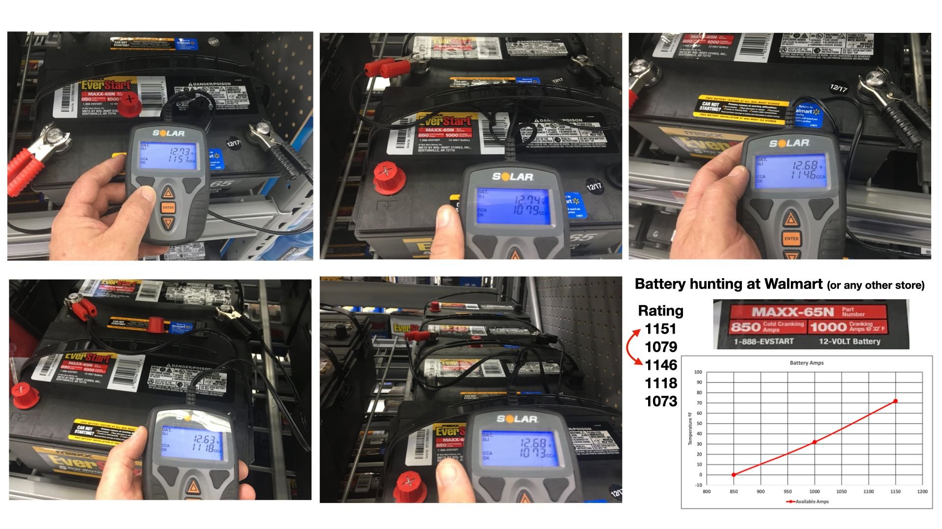

Ideally, I try to do this to a battery three to four times a year. Between the vehicles, lawn, and farm equipment, I maintain a little over a dozen automotive-sized batteries. Keeping them in good condition saves me a fair amount of money. I've had threads here about this.
Hunting at the store for the highest capacity and lowest resistance, while trying to get two that are the closest in capacity.
Starting the reconditioning process.
Start to finish. Four years old at the time.
Resting for a day.
Two years later, now 6 years old. While my truck sat during the engine rebuild, these were rotated into use at the farm with the tractors. The capacities and resistance will change over a few days and days of use. These are the ideal post charge.
