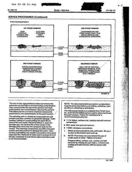

If you would like, here is one over 100+ pages published by Ford paint engineers and GE/SW (Ford specific paint mfg's), etc. on this .... this one particular page is very self-demonstrative of the chemistry and science.
Clar Bar 1997

That is blurry and hard to read, but doesn't appear to be about clay bars. This is what I have used https://www.griotsgarage.com/how-to/prep/. I don't use them often but they pull contaminates off of the finish. Clay doesn't remove any paint, it will probably remove most wax. A clay bar wont remove etching. Your wax or whatever coating is applied should be protecting from that.

It is specifically addressing paint contamination- proper removal, neutralization of residue (environmental & industrial product related)....... it specifically describes the limitations of clay bars, just as I stated. It is one of "many" docs from manufacturers (including Porsche, Mercedes, GM, etc.) that was provided to us during an ICAR specialty course (formal training for paint repair by the paint mfg industry). Almost any compound liquid or otherwise removes paint, from microscopic to mil's- and with claybar, until you get to 4000+ grit at which point, yes, you're just floating over the paint.... and that is why ALL clay bars have grit ratings just like all polishes have mfg specific grit or other ratings for each product, even though not all mfg's readily provide the documentation....such as the one I have attached for BAF (aka "Abrasives Index").
I'm not saying that one should not use claybar, but like any product it is important to understand its limitations and best practices that has been established by the paint manufacturer engineers....and claybar in general is one of the most overused, improperly applied application correction specific products on the planet (IMHO). If you are going to use it, understand what your specific needs are and select accordingly. Whether it's a chemical or other product, pick the right product for the right purpose. In most cases, the retailer (IMHO) does not have this information and is merely running off of PR docs- not a good thing.

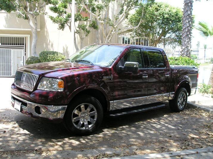

Let me just say that I personally live within 5 miles of LAX and of course we deal with all airborne related industrial contaminants........ I have yet to use a claybar on any of my vehicles (have I used it on others, yes, because of the level of contamination required it, but I then also in most cases neutralized the residue afterwards which 90% of detailers do not do). The 3 vehicles I will use as an example is...
my 2006 Lincoln Mark LT (which is parked outside, my wifes 1997 Mercury Cougar (black, daily driver also- CC/BC oem paint with the excepion of the left front fender - accident repair from idiot who back into it and the top back of the decklid with was scratched and I color matched/and repaired), my 1965 Mustang with is painted midnight metallic blue (from 1987) with Single stage PPG Ditzler Murathane- ie PPG Urethane and my dad's "Coupe' which was painted purple based blue acrylic lacquer....again single stage.
Cougar front
Lincoln Mark LT
mustang

I am not in disagreement that a clay bar has some abrasive, but so does the towel that you apply the alcohol with. Clay bars are supposed to be lubricated also. I have detailed more cars than I can remember, I started in 1980. Different people look for different things, most used cars get shiny stuff on the tires and people think it's clean. Some people look for complete paint correction. The OP has a 4 year old truck that has been through car washes and washed with dish soap. My guess if you use no mechanical paint correction and shine it up with any wax, it would never look good to trained person. Scratches, swirls and any etching would show up.
