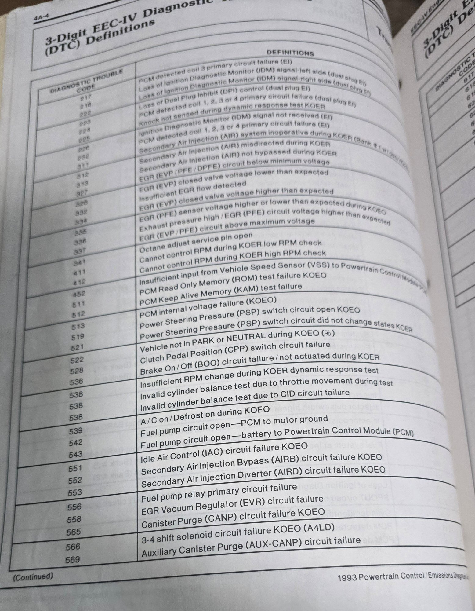

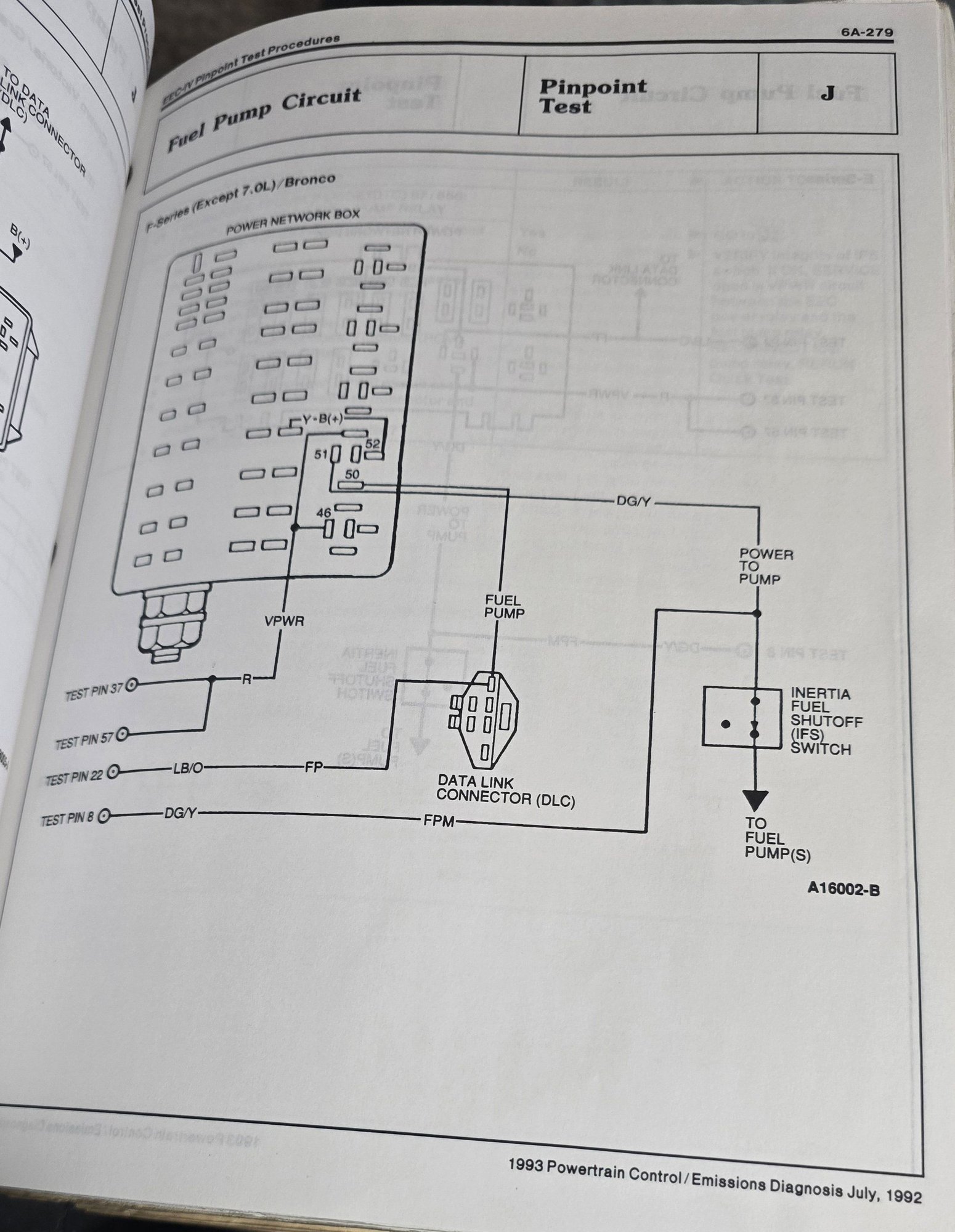

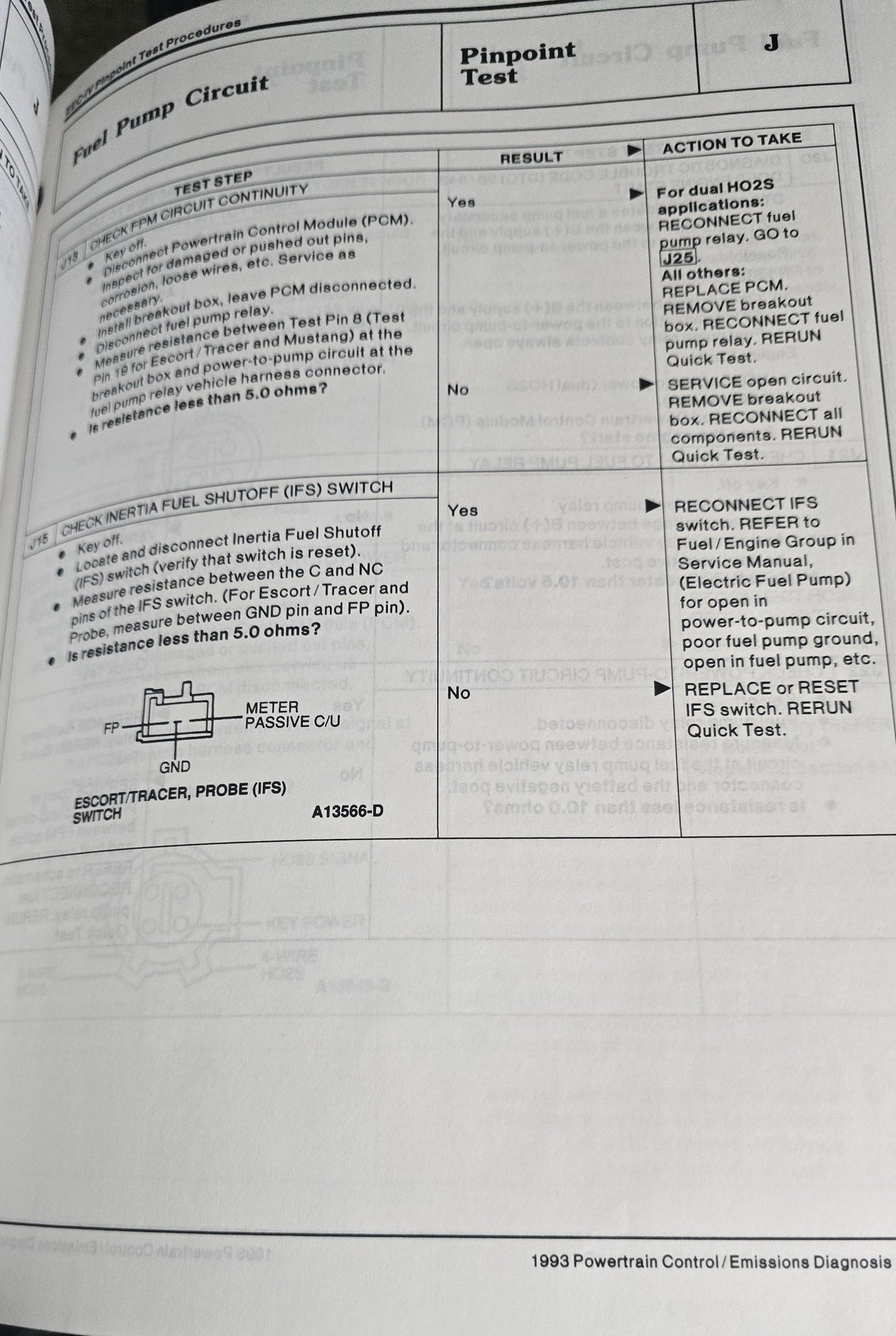

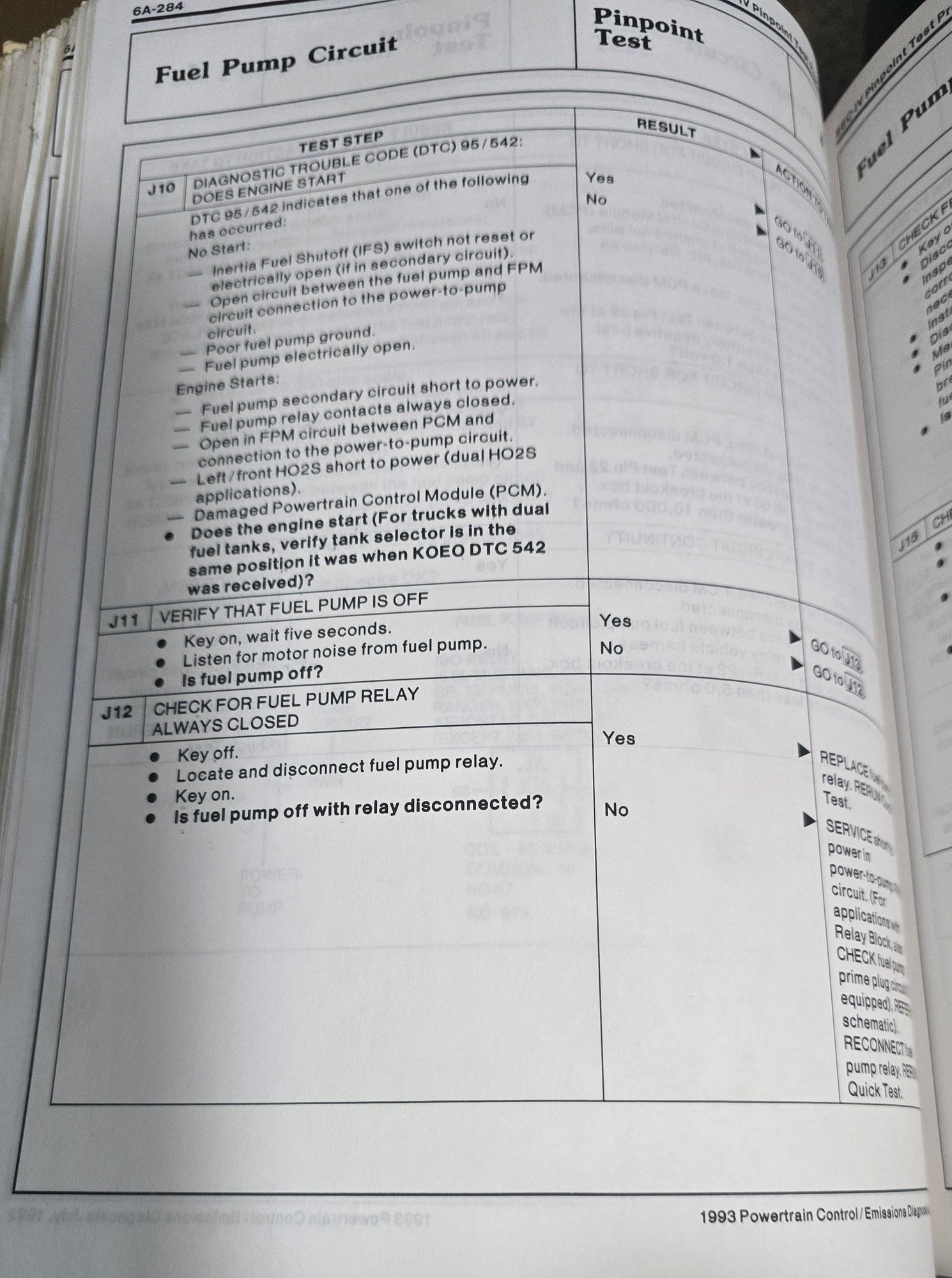

You could use a 1993 PCED and look at the pinpoint tests for that code 542
Here is a sample
AllData at your public library has these, and you can print them free in most cases
Here is a sample
