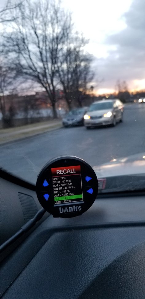

Just a follow up post DPF replacement. I just completed my first regen since the replacement at 695 miles. About what I would expect given the time of year and my activities.
What is different is the length of regen 14 miles. I have always averaged about 6 to 8 miles to complete a regen. Maybe it had to do with speed. Got behind some slow folks.
Good news is no more check engine light and the burn process was normal.
695 miles when I told it to regen
14 miles later, Idash regen status off
