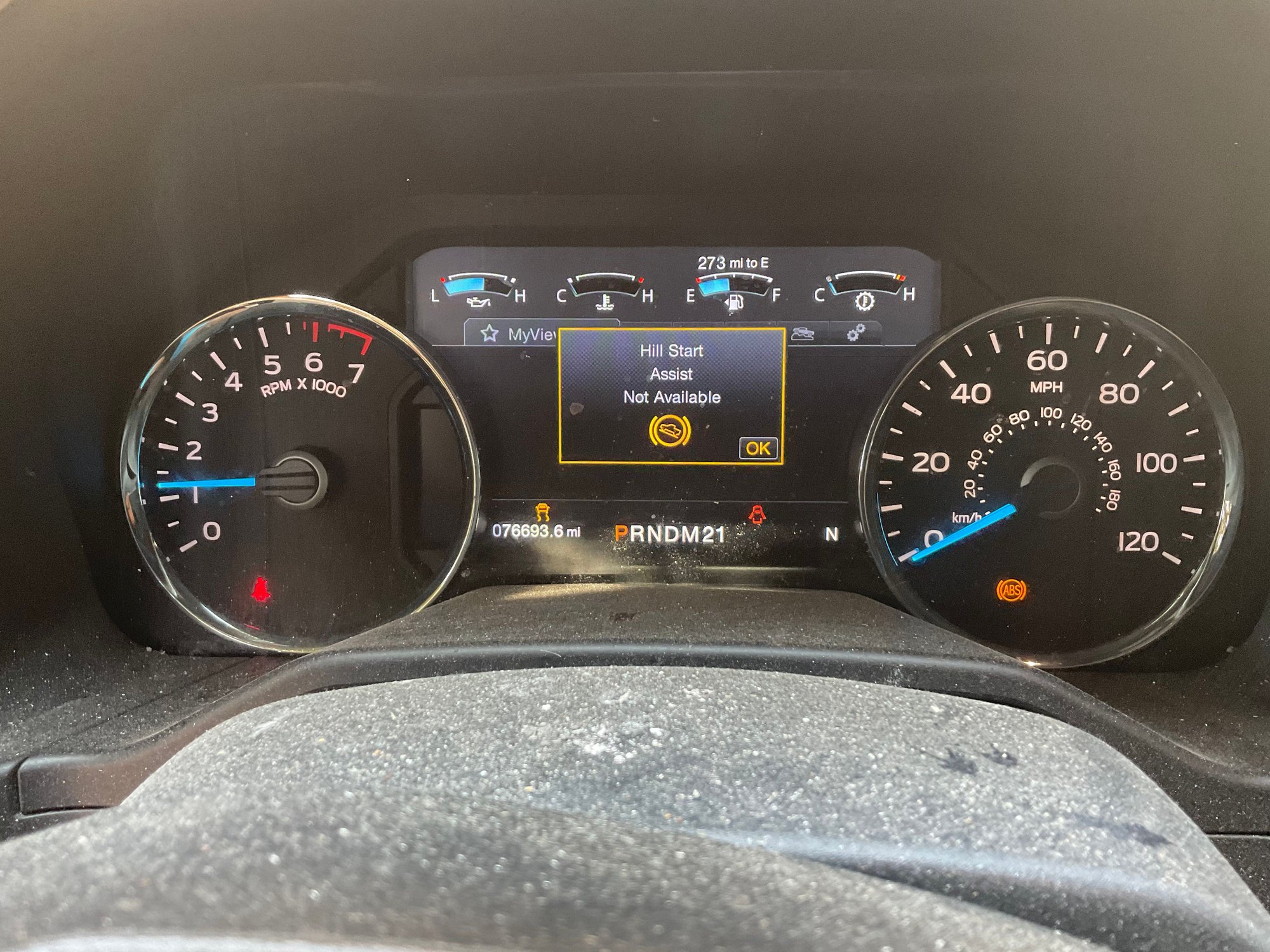

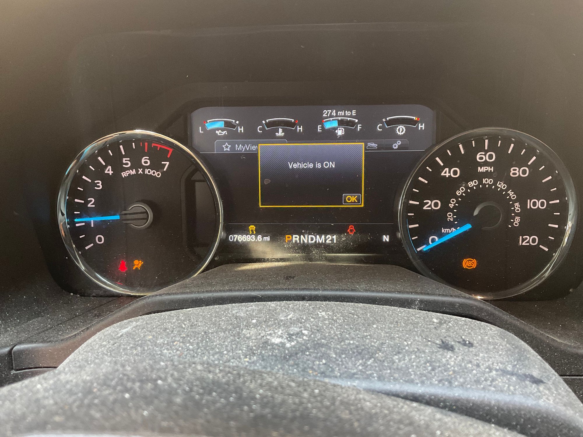

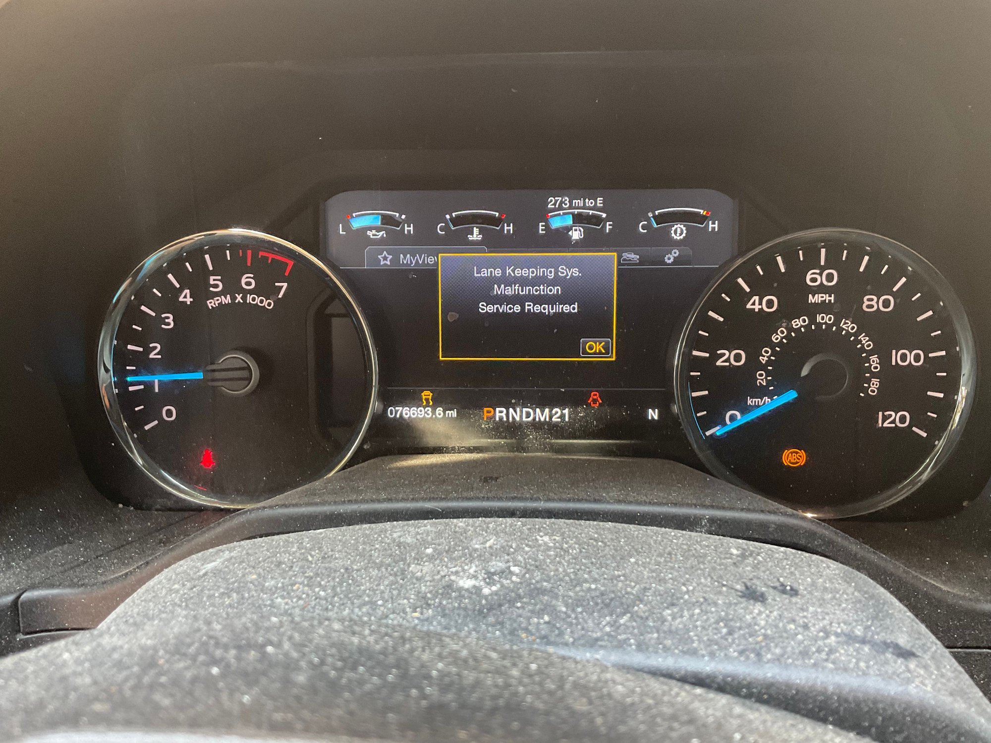

Son-in-law truck is throwing this code and it’s baffling me. Truck is a 2017 F150 5.0 Any ideas?

Power steering does not work, abs control module flashes

Code 415 is invalid data received from the ABS control module.
All the other functions that depend on or are part of that system are >>complaining/chiming in to tell you about it from the dash screen.
Your just not yet used to too much info being provided by these rolling computer systems on 4 wheels.
Make sense?
I think Forscan may be able put a test on that module.
The readout is only for PCM related functions, not for U codes.
The CAN buss system makes this all possible.
Good luck.
