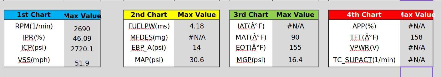

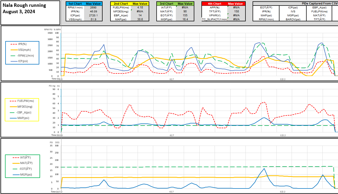

The data you attached looks like it's from FORScan, though I'm not familiar with the first two images. I'd like to know more about that.
Here is a chart of the CSV file you provided, using our PID charting tool. As you've seen, FORScan does not graph very well, so we made this excel tool. The chart shows the rig running down the road at up to 50mph. I don't see an immediate issue that would cause rough running, but the truck is slowing down and speeding up alot. There is a little idle section at the end that looks normal to me. Your high pressure oil system and boost looks to be performing correctly throughout this data.

that chart is powerful, but I suggest formatting the cells for
Center
Middle
makes for easier reading, I can't tell what is going on with the original format.

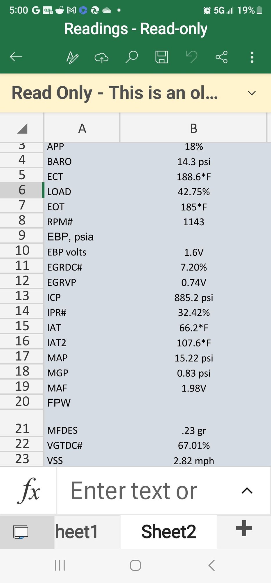

I'll try..here are some random codes I throw..Truck has s b intake 5 in exhaust hydra tuner EPBV DELETE EBS DELETED AIH DELETED now noticed oil in valley that wasn't there ALL OF THESE CODE POPPED UP WENT AWAY ..except shift solenoid aih iat
THIS IS ALL RANDOM...

Originally Posted by BWST
What's up with EOT and EBP here?

EOT is running cool at 150F, but this data is not very long - might still be warming up. The EBP sensor has been deleted, per her comment above.

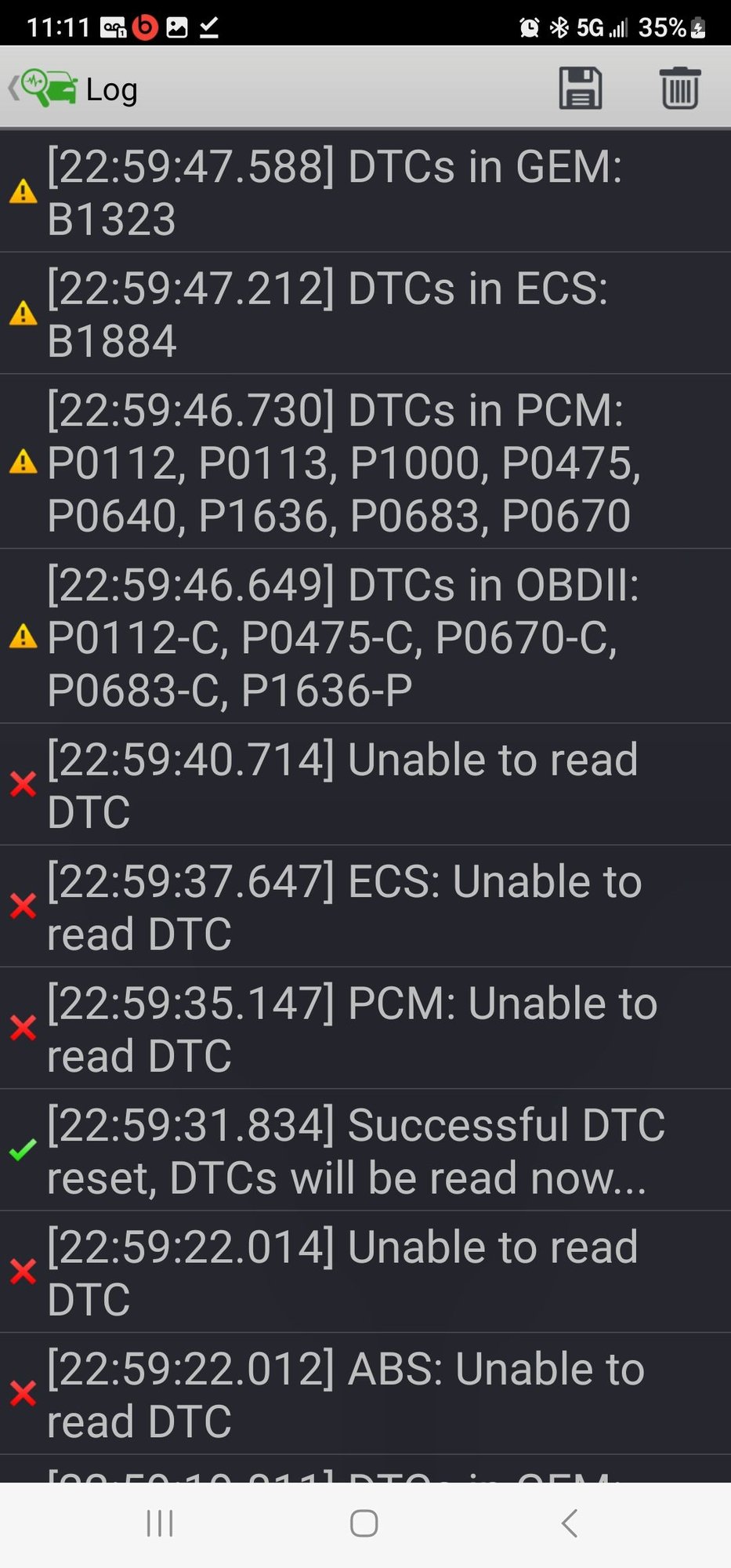

[The glow plug comes and goes I also have no speedometer shifts hard asf shakes under acceleration like bad front or something but all is new..WHATS THE CMP LOW READING HERE IS A DIFFERENT ONE of today ..what's this shift solenoid 1 and 2F. FAULT...ALSO THE TRANSFERCASE 1
AND NO BARO..

Wow this is a lot to unpack, but let's see what we can sort through. CMP is the camshaft sensor more commonly known, around here at least, as the CPS(cam position sensor). It is the linchpin to all the engine management. Without an accurate signal from that little guy the PCM shuts her down. The low reading refers to a ground side fault, which if I recall the ground is the signal return wire which is shared by most all of the deleted sensors you mentioned. The shift solenoid codes are transmission codes. They might have something to do with the shuttering and hard shifts you mentioned, though some of it could be tuning also. Depends what you've got loaded on the hydra and who wrote them and what if any transmission mods you've got. Transfer case codes I wouldn't worry about for now anyway, and the baro is probably just the wrong PID loaded. There are at least 2 baro's on the list try loading the other and see what you get.
