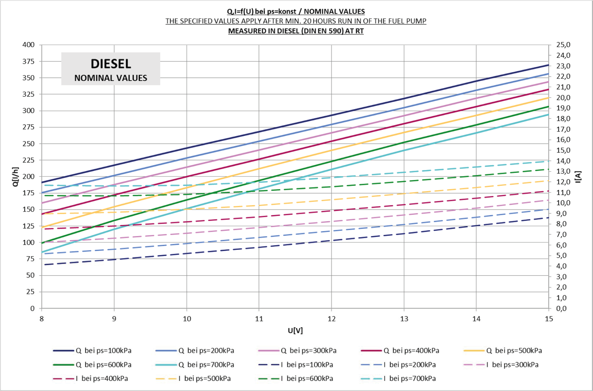

Flow curve for the bosch 200 which is their new diesel rated pump. I think the flow is part of my problem with vacuum. Before I changed the lines when the glow plugs were running the pump would be just about silent. Once the glow plugs shut off and the pump got full voltage and full flow it started screaming. From what it looks like the pump can run at between 6-15V. Running the pump at 10V would be plenty of flow according to the chart.
https://cimg9.ibsrv.net/gimg/www.ford-trucks.com-vbulletin/1891x1249/diesel_a323bd4f95d51bf0011894e255d7d1a8fe781ad6.pn g
