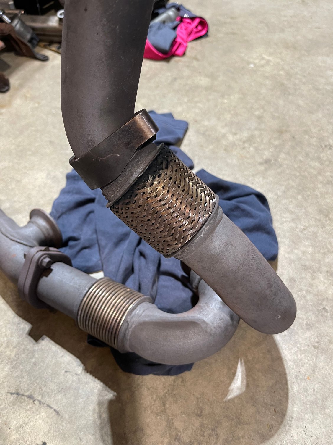

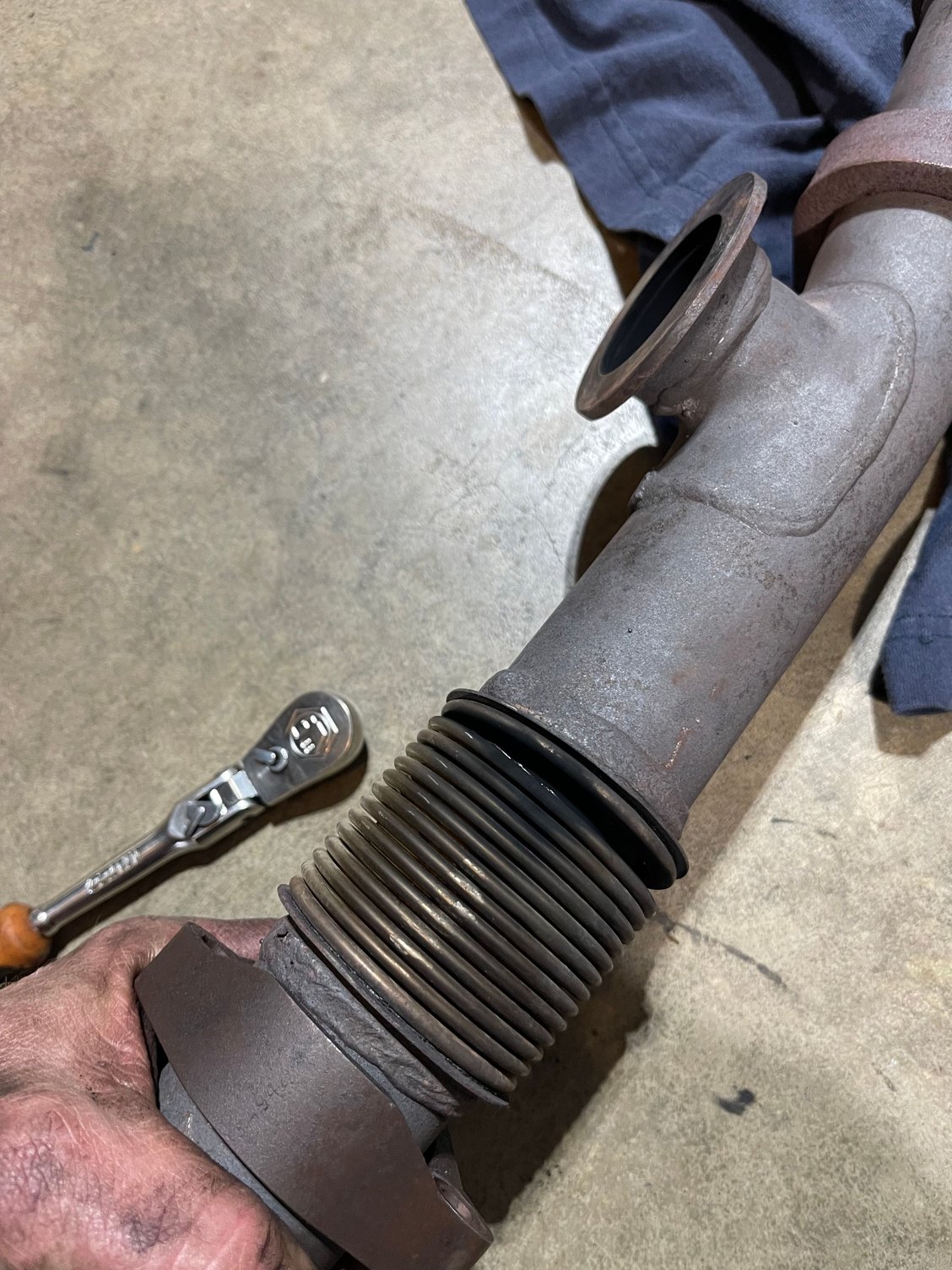

I noticed a small exhaust soot leak that appears to be getting worse over time, If I had to guess one of the OEM bellows is cracked. I don't have any exhaust in the cab, but I do not want to get to that point.
I discovered my cracks when replacing the clutch. Saw a little spot on the firewall. It wasn’t much soot, so was surprised to find them cracked this much.

That is what I suspect I will find. I cleaned the engine bay the other day in prep for my work, and found soot had creeped up into the EGR cooler.
