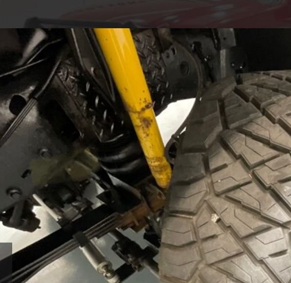

Good evening,
I am looking at a 2000 F350 7.3l ZF6 and noticed this diamond plate on the left front frame which sent up red flags. The truck has a lift and it seems like they have air helper springs up front. They also have bags in the rear. Any ideas if this is a common place to reinforce due to the modification or is the frame cracked and they slapped this patch on? I have not contacted the seller to ask just yet as I wanted to hear what logical reasons may exist beforehand. Also, I cannot tell if this was replicated on the passenger side ans well. Any thoughts on this are appreciated.

It's kinda hard to tell for sure what's going on there. Is it just on the driver's side or both? How is it attached to the frame? Bolted, welded, Gorilla Glue, Hubba Bubba, other? There's actually a factory frame splice a foot or so back from there. If that's actually a repair of some kind it looks stronger than the factory job so I probably wouldn't be all the worried, provided it's straight.

looks like a bracket for the air bags.
is the other side the same? if not then there are issues... if both sides are the same roll on brother.

This was my initial thought as well. Perhaps the owner made their own bracket instead of buying them from AirLift or Firestone like most of us do.

the big question, (only question) is the other side the same or similar? once again a home made bracket for the airbags is not big deal...if its only on one side, I would be concerned also look for cracks, if lifted airbagged and PO was hauling dirty all the time it might have been to fish over some cracks. thats not cool either

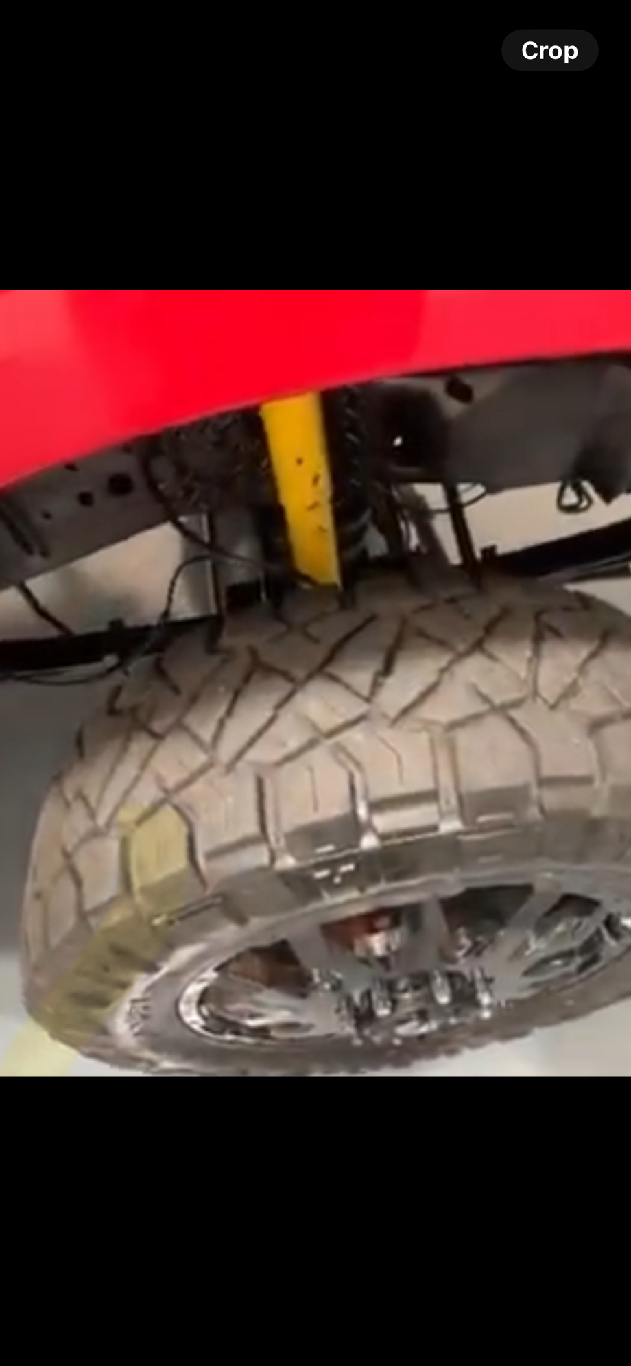

So I got another not great pic of it and those brackets are on both sides and appear to coincide with the front air bags. It does have a pretty heavy duty bumper on the front.
