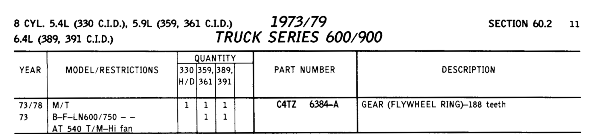

Does that work? Fords I've worked with all have one side's teeth chamfered so the starter pinion has a chance at engaging. Fords of this era with inertial pinion gear engagement aren't as forgiving as ones with positive-engagement designs.
If I looked it up correctly, that comes back to
C4TZ-6384-A
Dennis Carpenter says they'll sell you one for $45+
There may be cheaper ones; this was just the first DDG hit I recognized.
C4TZ-6384-A

I've never seen an FT ring gear, but other Fords I've replaced the ring gears on (I'm thinking specifically of one on a '84 6.9l w/C6 with replaceable ring gear, and an old Falcon with 170cu Six) had chamfering on one side but not the other.
I'm specifically recalling that 6.9 because I put it on backwards the first time, and had to pull it off and re-mount it [smh]. Around 2004. I think it was an Anchor brand ring gear, that time.
