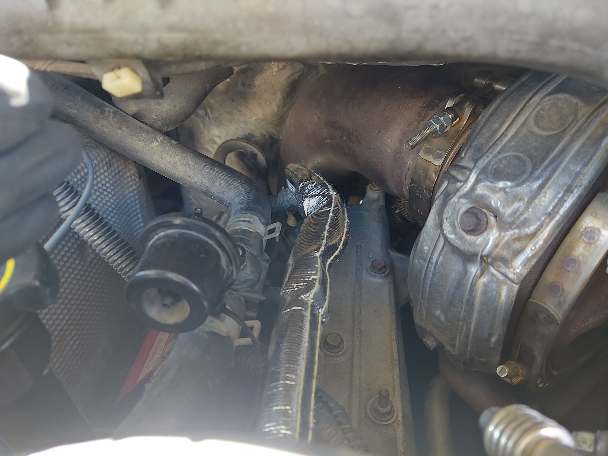

I used the titanium heat wrap that Autozone carries. It’s a 2” x 25’ roll there was enough there to do the up pipes to the turbo, and the down pipe to the bend under the fire wall. I had to get more of the stainless steel retainers than came with the roll. They sold those as well.
I have some of that wrap and more on the way actually! I wrapped my new up pipes before installing the other month, but I only went half way so I'm going to finish wrapping the rest of the up pipes and will wrap the downpipe as well and I also ordered some ceramic fibre insulation and I'm going to go overboard and wrap that over top of the titanium heat wrap and secure with SS zip tie straps THEN completely cover that in that super thick aluminum foil.
There should be a good chunk of the ceramic fibre insulation left over so I'm going to pick up a thin piece of aluminum sheet and DIY an insulted turbo cover while I'm at it and more than likely wrap all coolant lines in fibreglass/mylar velcro insulation stuff as well. I'll be pulling the downpipe to get better access for wrapping it and turbo is coming out for an inspection/cleaning and will pull FICM and degas bottle as well to get at the up pipes and should have good access to EGR delete pipe as well.
I have another 10-12 days before I go back to work so I want to do as much to the truck as possible before then and I want to do everything REALLY good cause I'm sick and tired of having to do things 2-3 times lol so a bit overkill is just fine by me

Just be careful you don’t make things too thick. Any rubbing anywhere will lead to your wrappings coming off and becoming a mess. I have the 4” MBRP exhaust which is a 3-1/2” pipe at the turbo. Just having the titanium wrap on there made it a little tricky getting everything adjusted for no rub.
Yeah I've thought about that. My downpipe is 4" and pretty sure the end that connects to the turbo is 4" as well, but could very well taper to 3.5".......Will have to measure it when I pull it out.
The ceramic fiber insulation is 1" thick and I'm going to slice it in half to get more out of it and I'll avoid rubbing 👍
