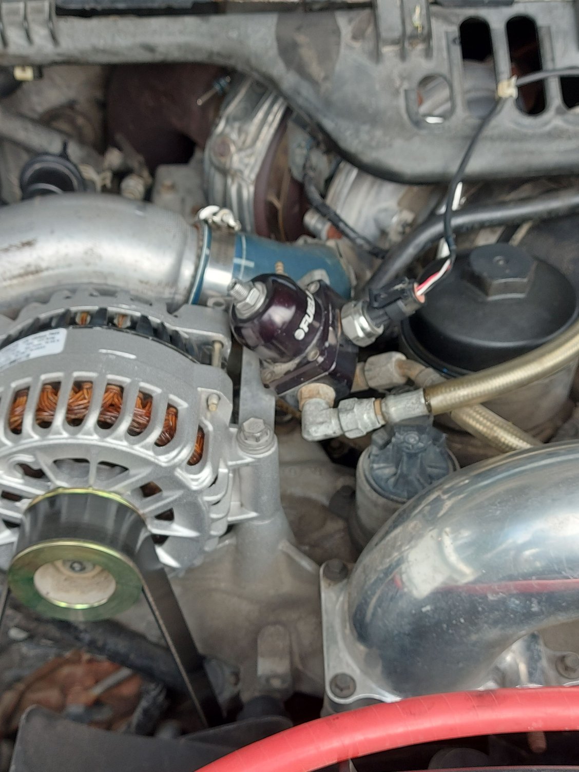

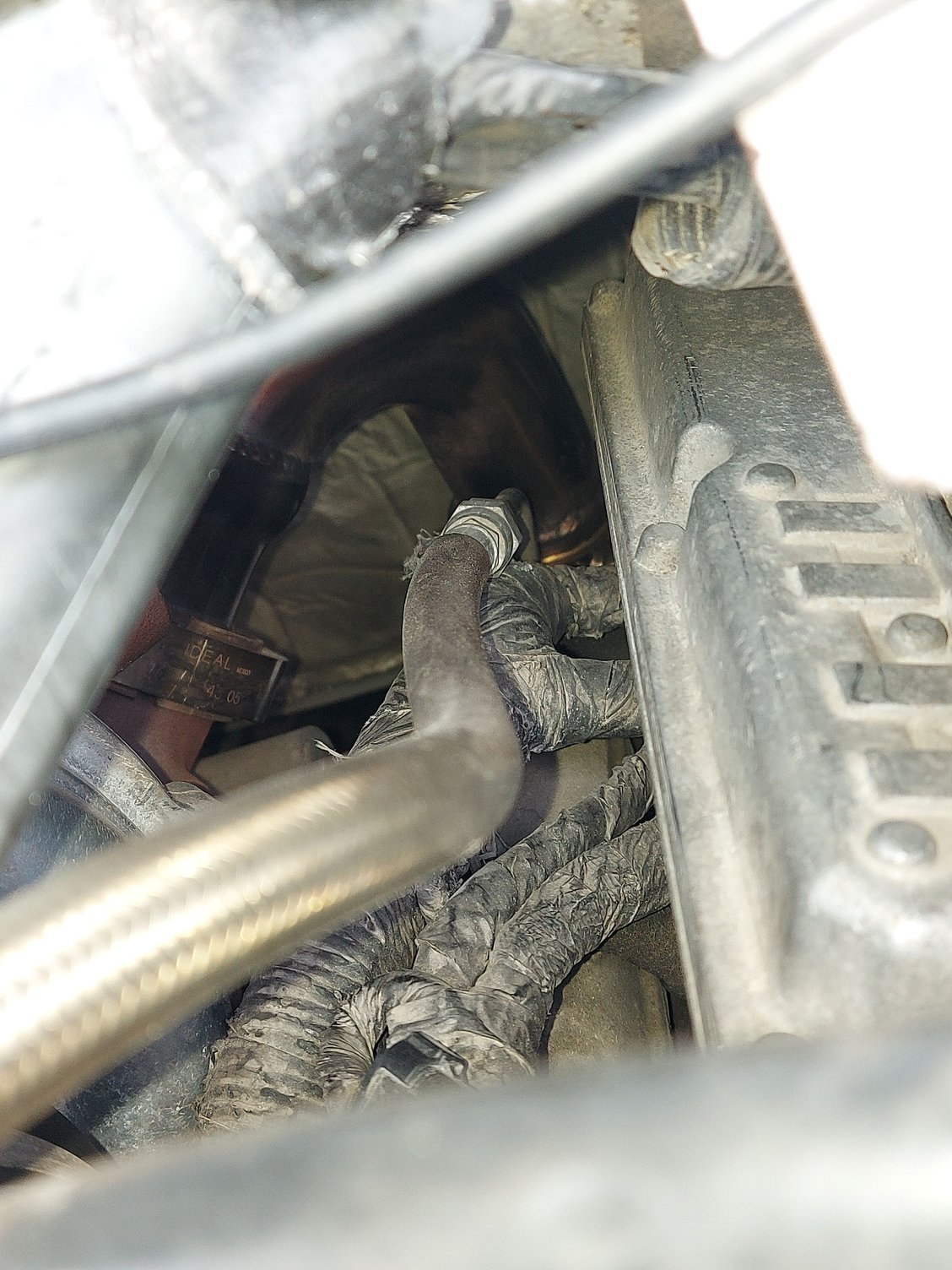

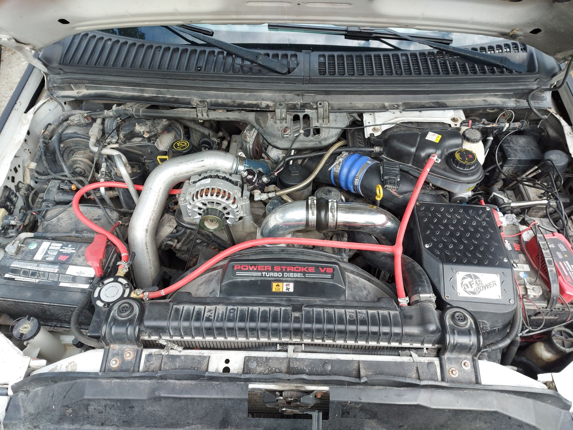

Not sure about the stator, but engine bay picture attached and pics of the fuel pressure regulator location and metal feed lines and Airdog is located on frame rail under drivers seat.
Relocating the fuel regulator will be a bit of work so I'm going to try insulating the metal lines first and if i could raise the back of the hood an inch or so like an old hot rod it would drastically increase air flow over the engine I would think.
First off I think I need to install an electronic temp gauge and mount the sensor directly on the pressure regulator and put the gauge in cab of course then i can get a reading under current setup then if i can lift the back of the hood an inch and see if the temp of the regulator goes down at all.
If that works then I can just buy a air ram cowl hood or whatever they're called or figure out a way to cool engine bay at highway speeds.

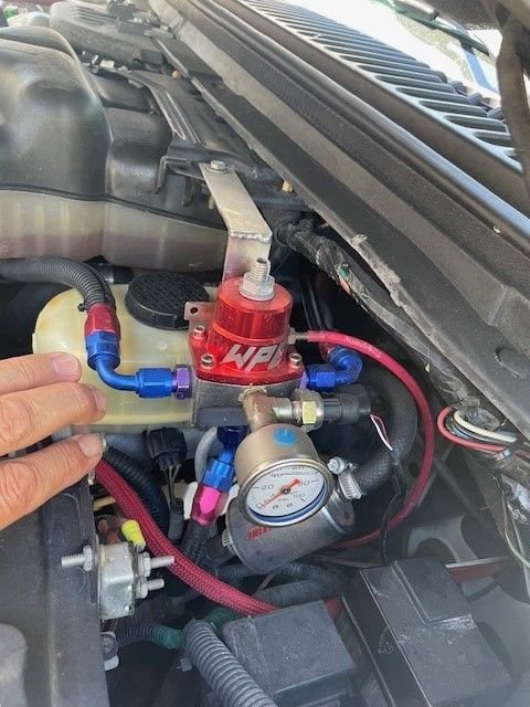

Can you post a pic of your pressure regulator please

Pretty basic three line RR. Two off the back of the heads and one return to the main fuel OEM line. My ADII is set to full flow and the RR regulates the pressure at 62 psi.

Yeah that's where I'm going to reroute mine to and funny my AD2 is wide open as well and regulator set to 62psi as well lol. Thanks for the picture brother 👍

One thing that REALLY helps is to put a fuel cooler in the return line back to the fuel tank. I used an add on transmission cooler about 8x12 and mounted it in front of the radiator. It also benefits the fuel pump. If you're in a really cold climate you can plumb in a bypass to help with gelling in the winter.
WPG--yes, you have that stupid a** fan stator. Do yourself a favor and get rid of it. Your heart and blood pressure will thank you for it later.
