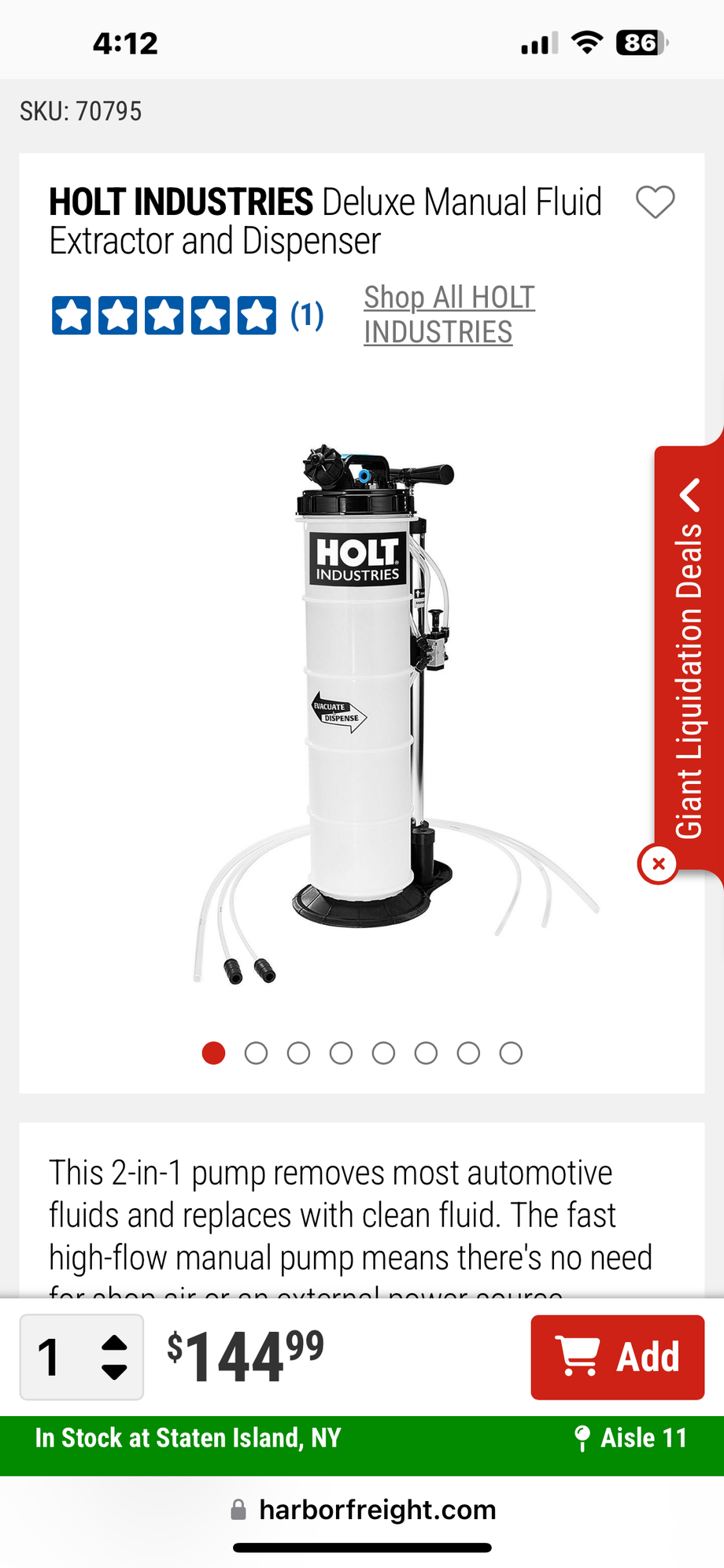

If you have one of these you can prime the oil system pretty easy and fill the cavities Dave is talking about.
you can even use a tee fitting and leave the sensor in and connect the hose to the new port and set this to dispense and you will quickly have 10 qts coming into the pump .
