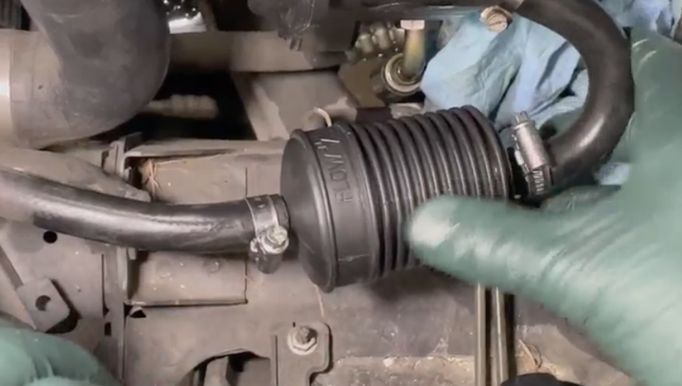

also curious how you did the did line filter I like the idea. Got any pics?

cut hose and install filter
dont forget to tighten those clamps

Awesome thanks for the idea and denostration. Definitely going to be doing this when I swap boxes.

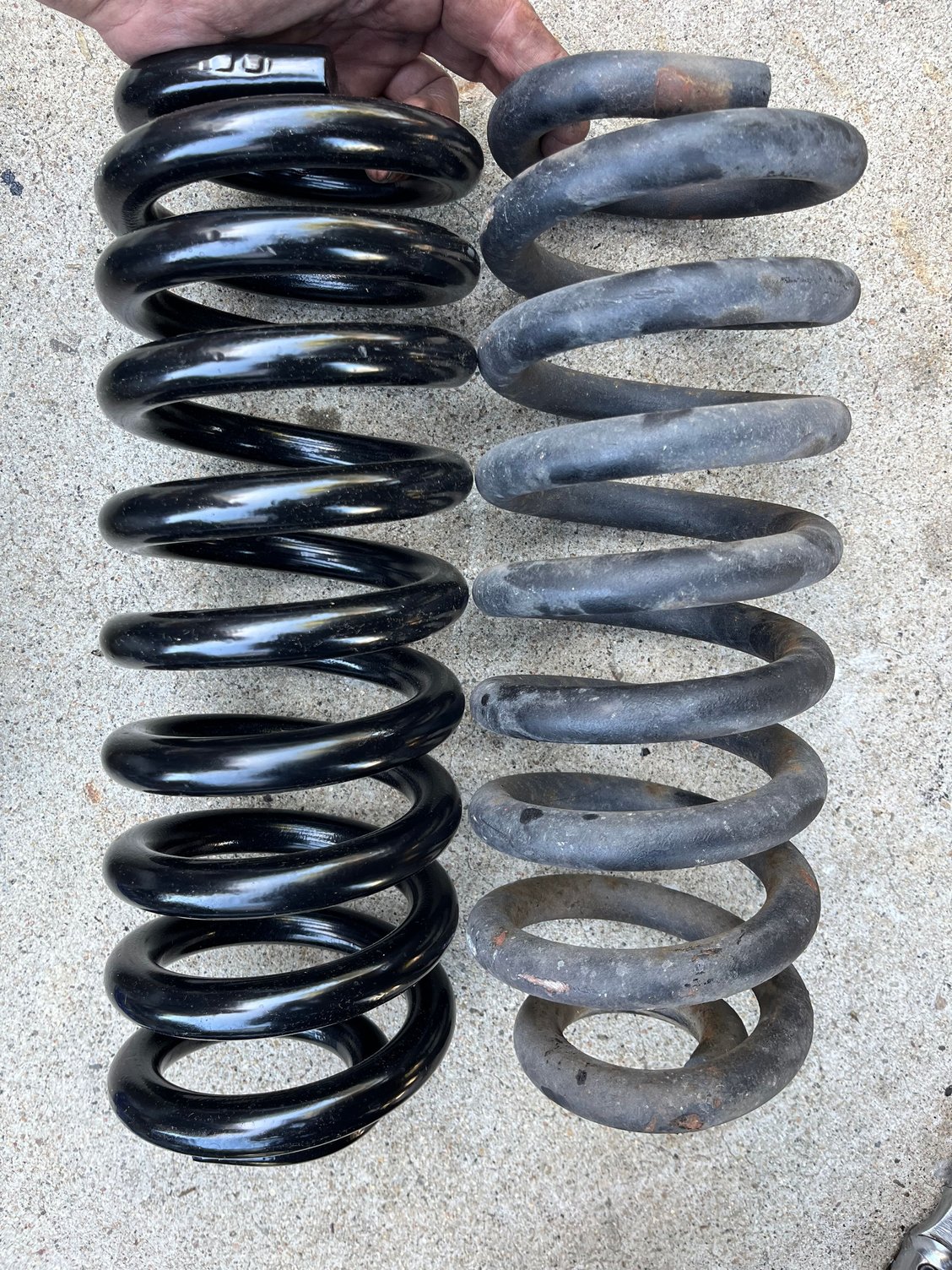

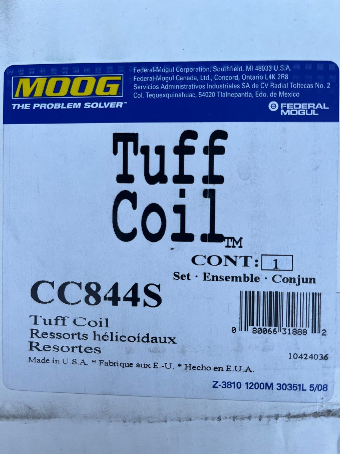

I went with moog on everything. Bushing, ball joints tie rods and coil springs on my 2wd.
New coil was about an 1” taller. Brought my ride back up. Almost leveled my truck.
If you have 2wd, make sure to buy new isolators. Part # for the heavy duty for diesel notated by “S”.

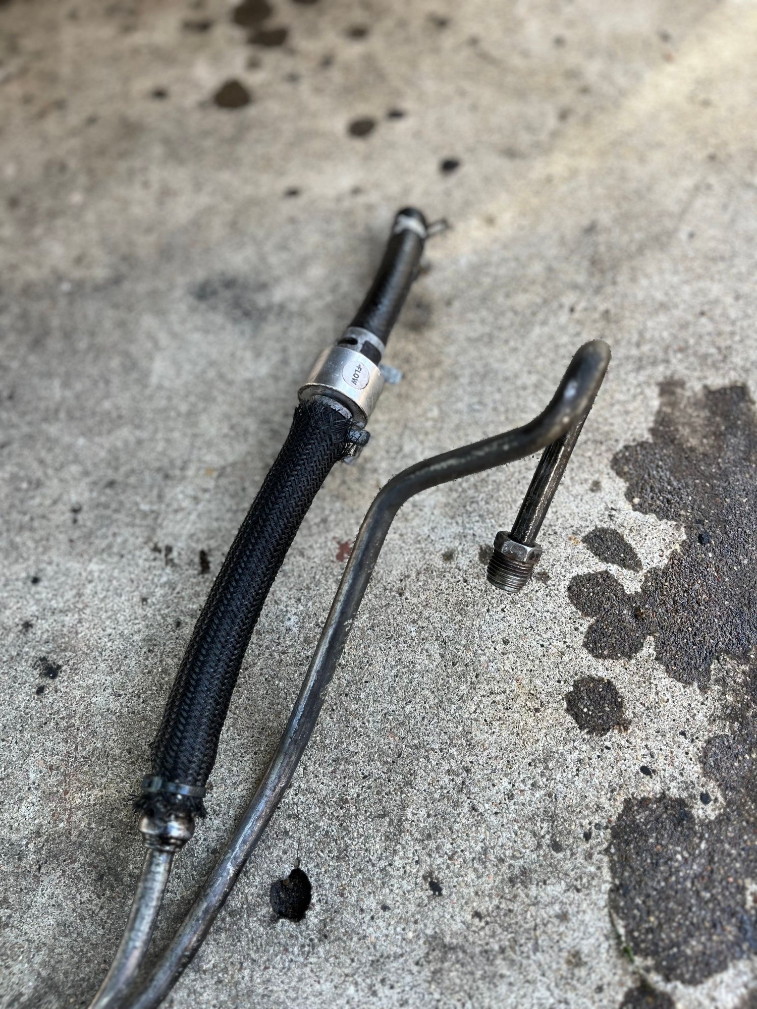

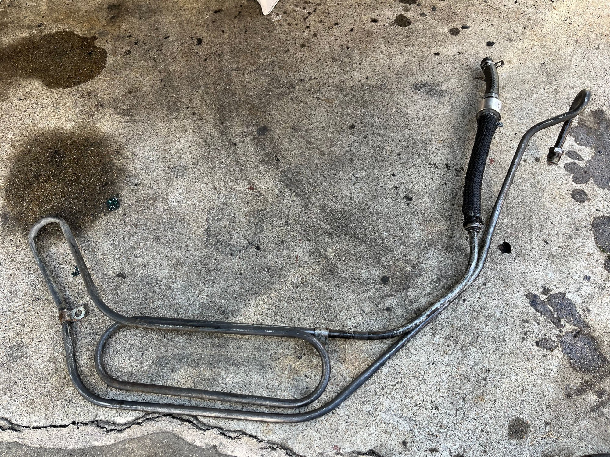

Low pressure side. You can see the inline filter (silver color). Use good hose cutters and quality clamps. Cut out small section the size you need to add filter. Arrow on filter points towards power steering pump. Diesel site sells some but I bought mine from Rock Auto when I purchased OEM replacement high pressure line.
Low pressure side power steering pump cooler with inline filter added.
