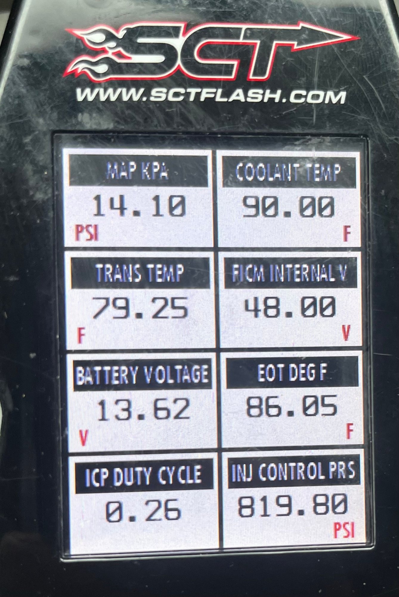

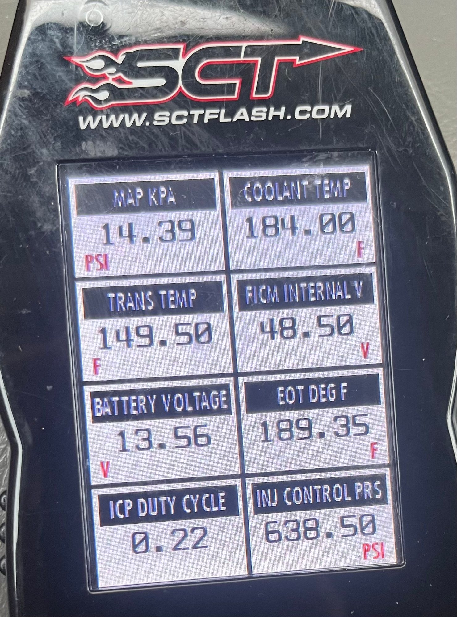

Seen a lot of these recently, not really looking for a definitive answer as I have broken and will just be paying a mechanic for diagnosis and repair. Just want to learn for the future, maybe help someone, and have a discussion!
I have been having issues with Hot Starting and recently replaced my oil cooler which fixed an issue but not the hot start issue. I have put some images below of running values.
Taken while idling immediately after starting
Taken within first 10 minutes of driving while cruising.
Taken right before parking while cruising (about 20min running).
Taken while idling after parking.

I’m unfamiliar with sct
whats ICP Duty Cycle ?? Assuming it’s meant to be IPR duty cycle but it also has a decimal point that’s not normal reading
where is you ICP located
need to take values in a more controlled way to really dial it in
any codes

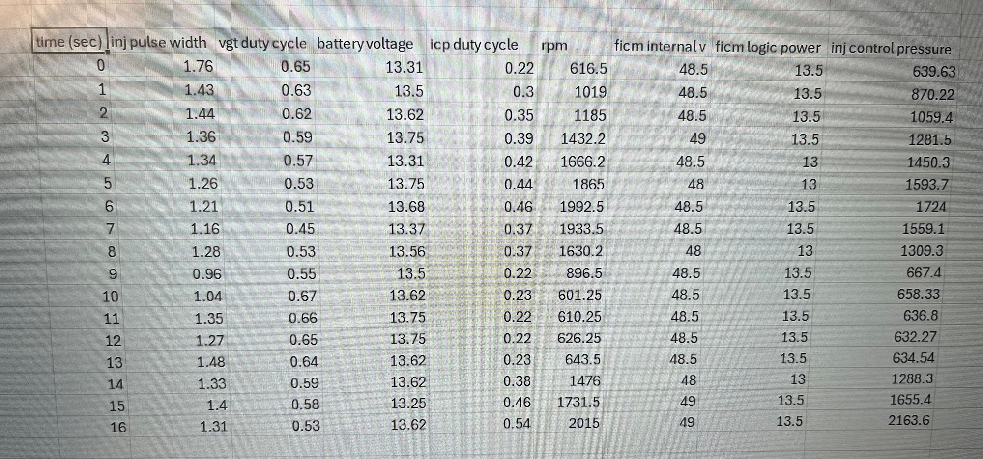

I think it is an error with the program and reflects IPR duty cycle as you stated. I would imagine it is just displaying the percentage as a decimal instead of whole number (ie .22 being 22%). I have attached a picture of a longer test I did today not sure if that helps. It was while accelerating at a stop light up to speed (45mph).
i am not sure where it is located… it is stock as far as I am aware
