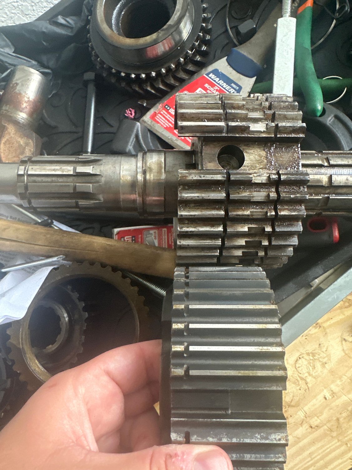

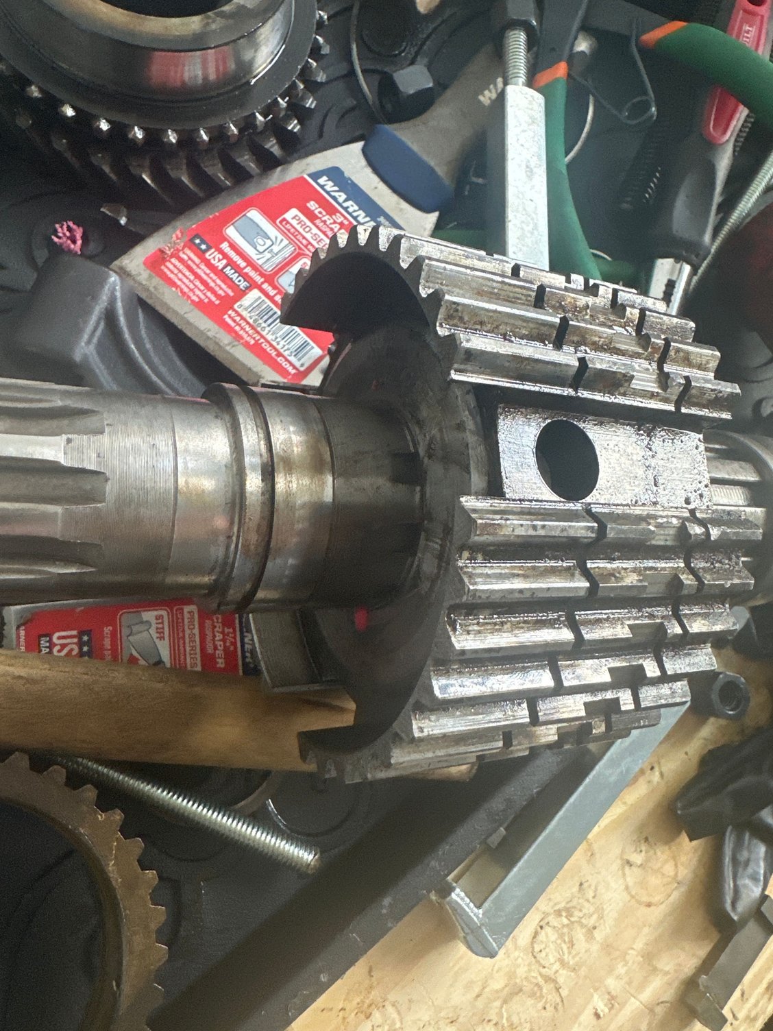

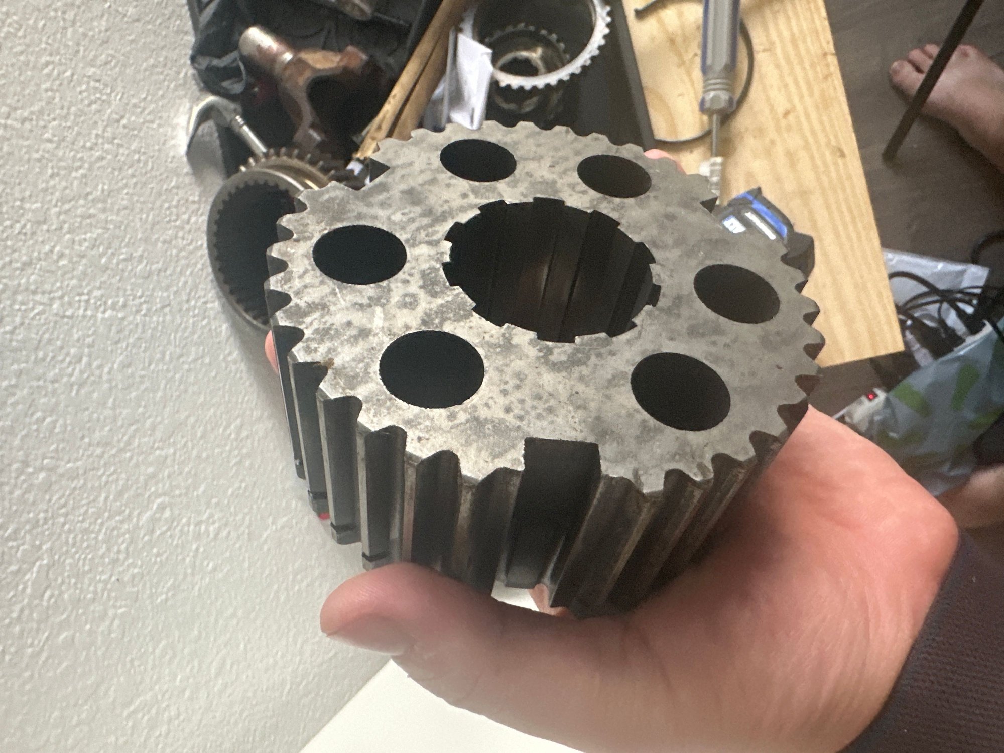

Multiple 1st/2nd Synchro Assemblies
I’ve researched that there appear to be two different 1st/2nd synchro assemblies for T18s. There is one with the clutch hub showing several holes (photo) and then there is one where the clutch hub does not have those holes. When I line them up side by side the one with the holes appears to be slightly smaller.
Are both styles interchangeable for a rebuild?
