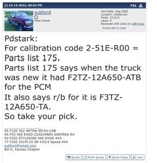

I am wondering if anyone could help figure out what ECM I need to order with calibration code of 2-51E-R00? I do not have the original ECM to recover the OE number. Thanks!

After typing that code in the search function here….

Thank you so much, I will use to order the new PCM.
