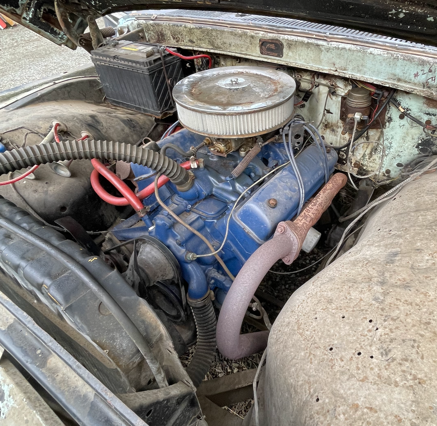

My 64 F250 had an aftermarket dealer installed AC when I got it. The original owner had the motor rebuilt in 73 and added some OG large truck Rams.... The other cheaper way would be to eliminate the cross-over pipe and do a kind of "cross under" setup with the exhaust. This was a pretty common thing back in the day. I have that setup on my 64 F100 I think people got tired of getting burned on the cross-over.
64 F250 w/AC
64 F100 "Cross-Under"
