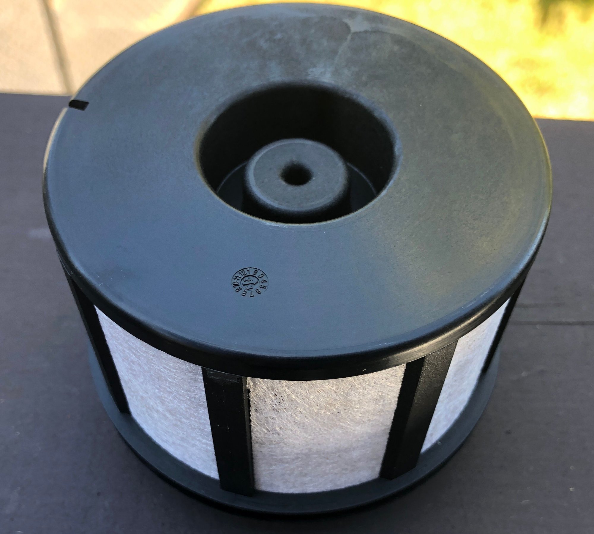

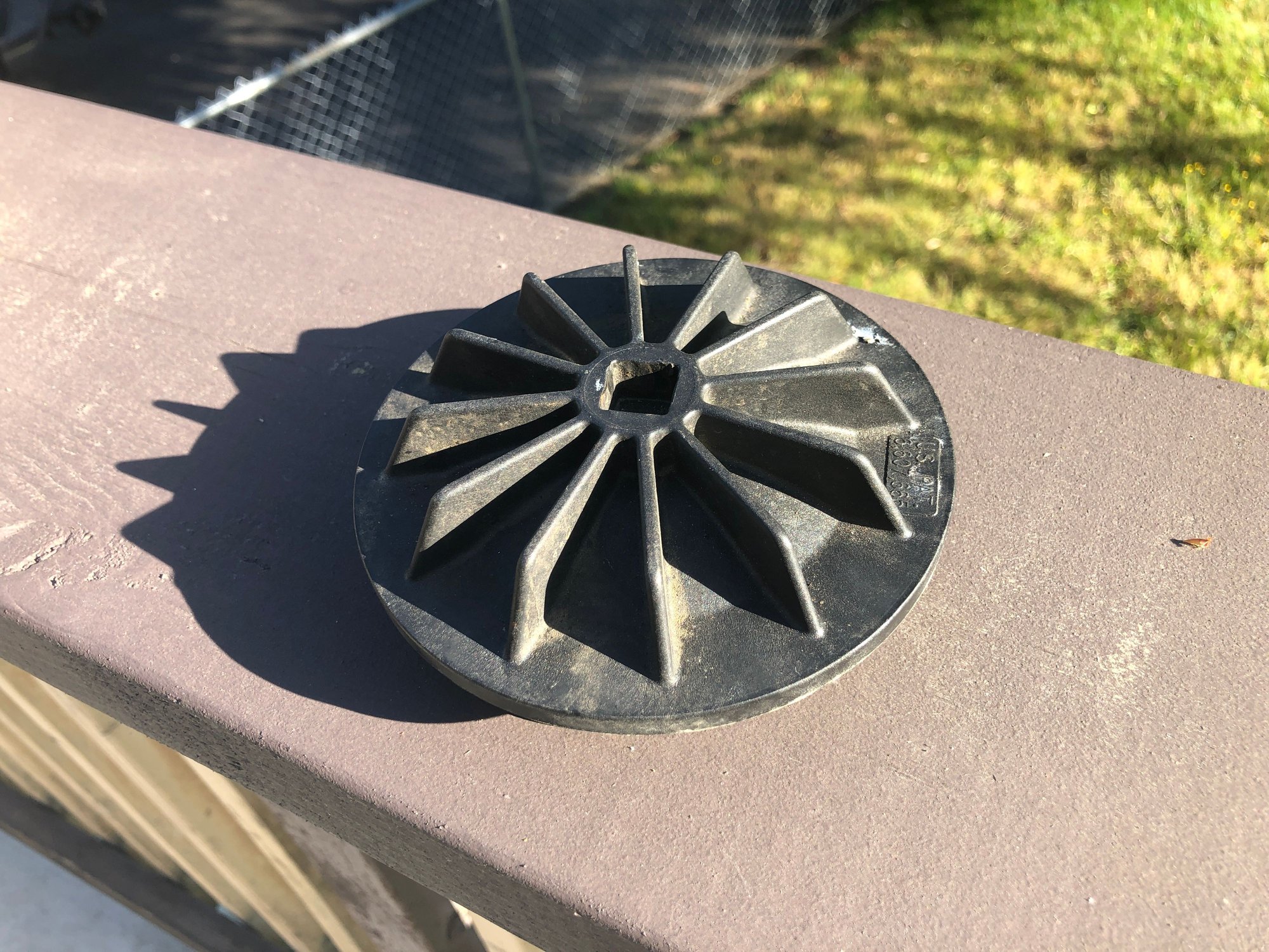

Does anybody have a picture of inside and outside of the factory fuel bowl lid?
This doesn’t look right to me, and I don’t have the old element from 4 years ago to compare.

@F350towing That is not a factory fuel bowl lid.
The explainer label is somewhat in the way in the photo below, but you can at least see the top rib pattern and perimeter of the OEM fuel bowl lid.
The sign in the photo above blocks our view of the center of the fuel bowl lid, so I've added another photo below to show the center, in order to show that the OEM lid does not have any type of hex or socket feature in the center.

That's not a factory Ford lid. Let us know how much the lid is from Ford if you go back to that dealer!
Just to make you feel worse Motorcraft Fuel Filter FD-4596 Fits select: 1999-2003 FORD F350, 1999-2003 FORD F250 - Walmart.com

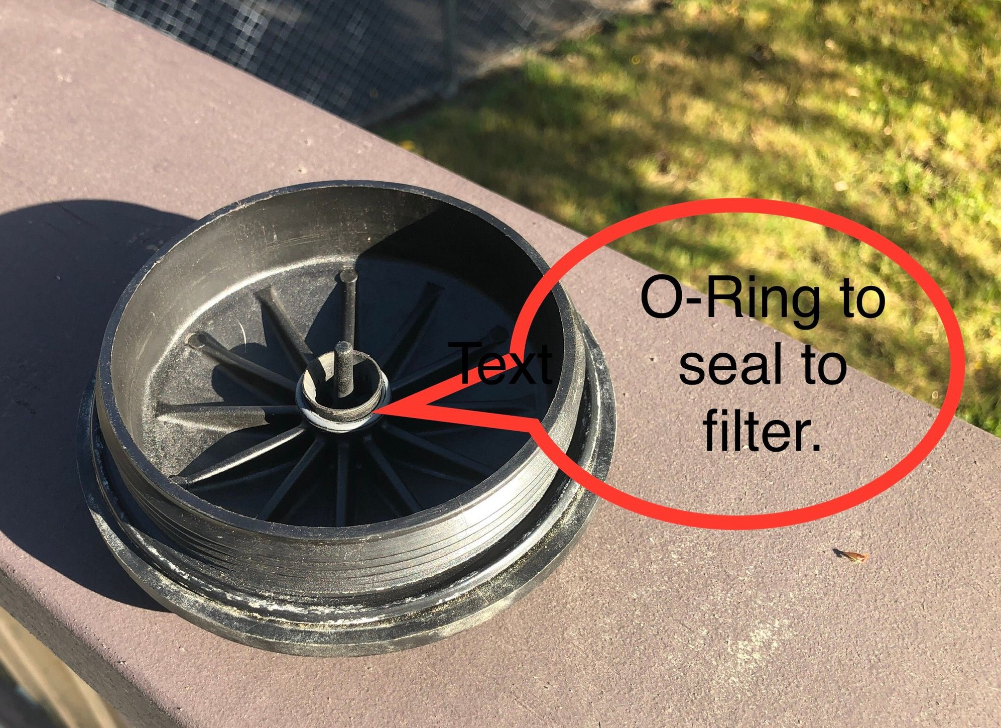

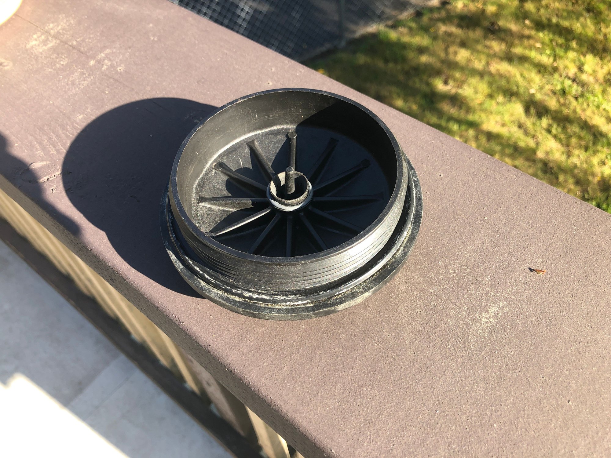

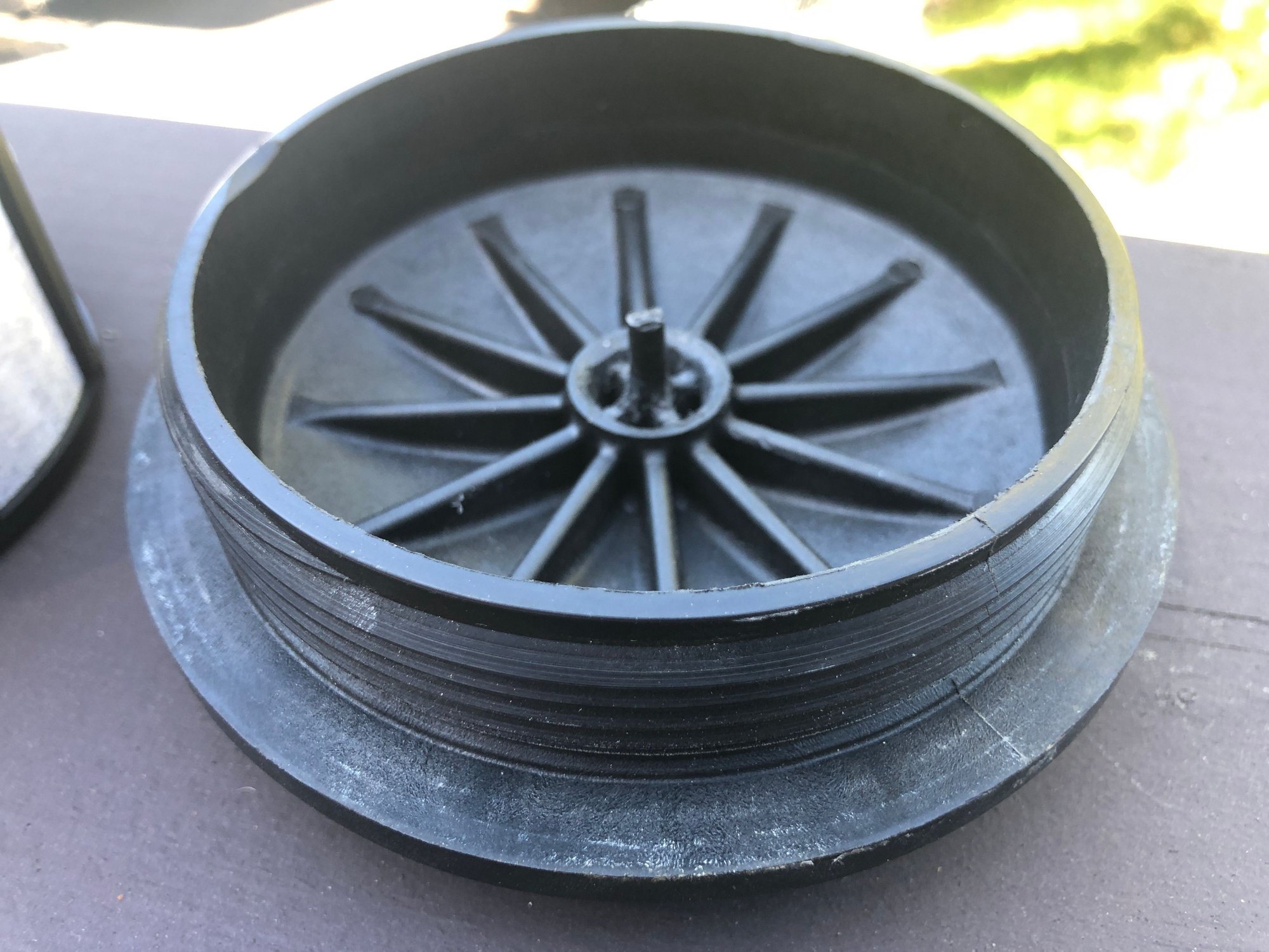

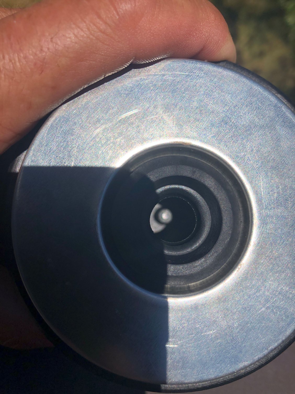

Best I can tell from all the interweb sleuthing I’ve done this is a Baldwin fuel filter cap I have.
Amazon Amazon
Ford fuel filter is solid on top and has the pin to push the fuel standpipe valve as internal.
The Baldwin was open on top and relied on an o-ring to seal the filter to the cap and the centre pin of the cap to depress the standpipe valve.
I have removed the o-ring section, and trimmed down the length of the centre pin. The filter now nest’s nicely into the cap.
I’m gonna give it a try before I go buying a new cap.

No more leaks and fuel psi is back up to 55lbs.
Haven’t driven it yet so see if there is a significant drop. Needle only twitches when I punch it in park.
Gives me time to get it together for the next filter change.
