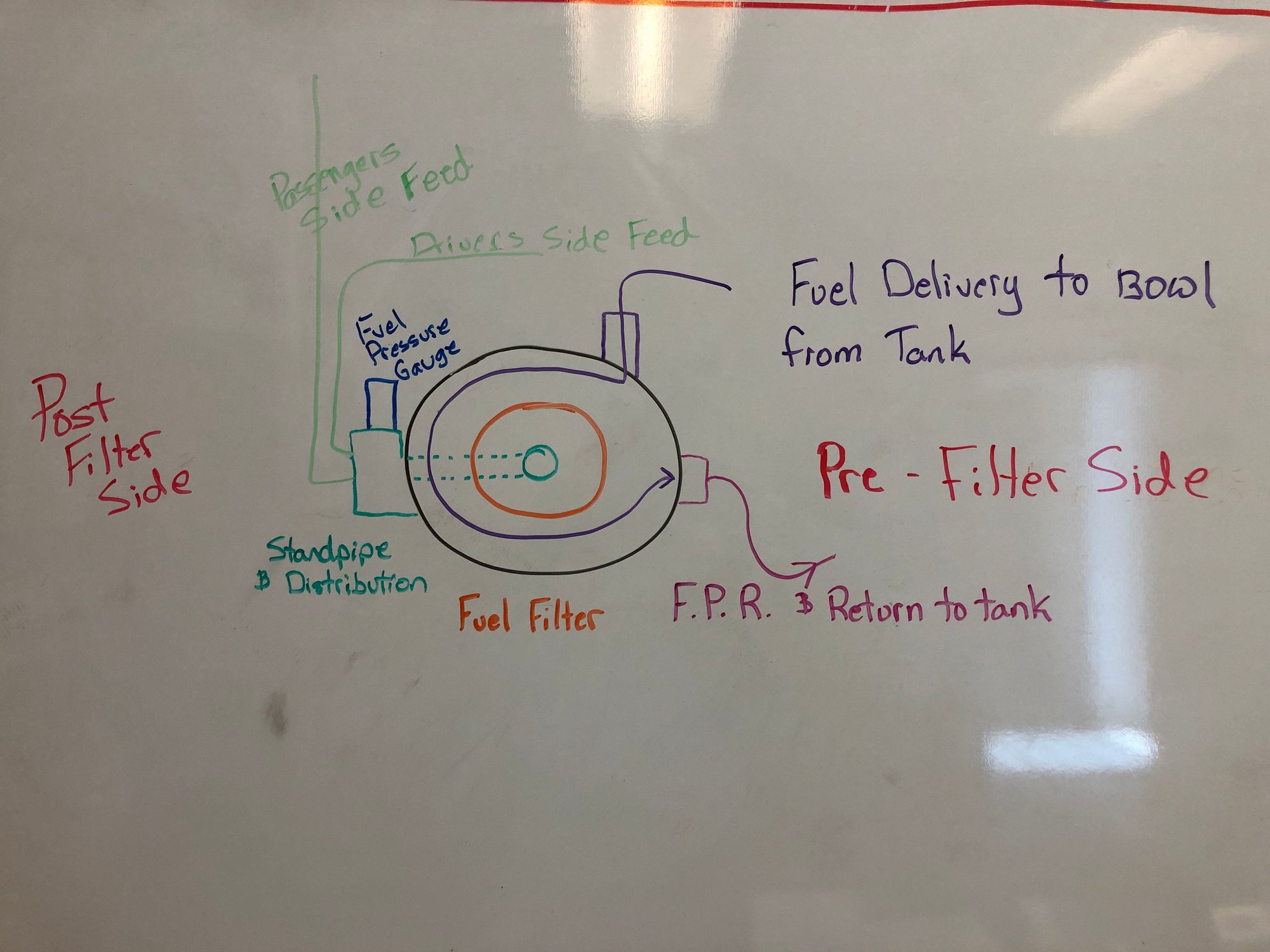

Originally Posted by Kwikkordead
Sorry, I'm still not seeing it. Especially if the standpipe has been gutted. And most especially at idle. But I'll back down now because I'll be the first one to state that I don't know everything and never too old to learn.
Here is the way I understand the fuel bowl and delivery system.
Changing the spring will raise overall F.P.
If I am reading from post fuel filter side, which I am, then my gauge is showing what the injectors see for F.P.
So in reality the only 2 things that can effect the FP from 1 week ago would either be the standpipe or the filter.
My standpipe is not gutted but I will have a good look at it to make sure everything is lined up when I replace the suspect fuel filter.

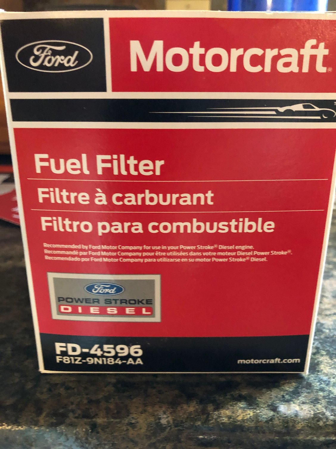

Today on my way home from work I stopped in at the local Ford dealership.
Almost choked when he quoted me the price for the filter but I bucked up the $138.21 after tax dollars.
It gets installed tomorrow afternoon once I get back from exchanging the rear tires I had installed 4 weeks ago that weren’t up to the task I asked of them.
