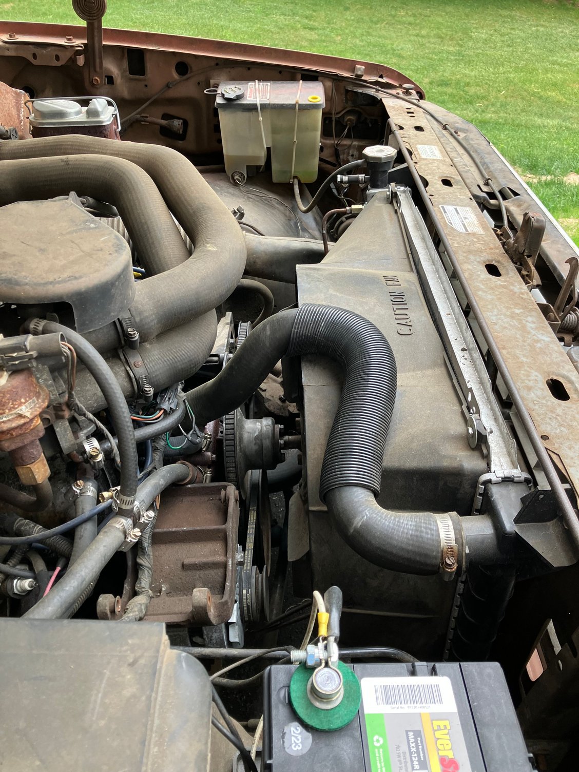

I have checked the radiator and it does not seem clogged inside or the fins. I was thinking about changing the radiator cap and the thermostat to see if that helped.

Why are we worried about the radiator if the truck is not overheating?

I also wonder if the OP has the shroud on the radiator ?
