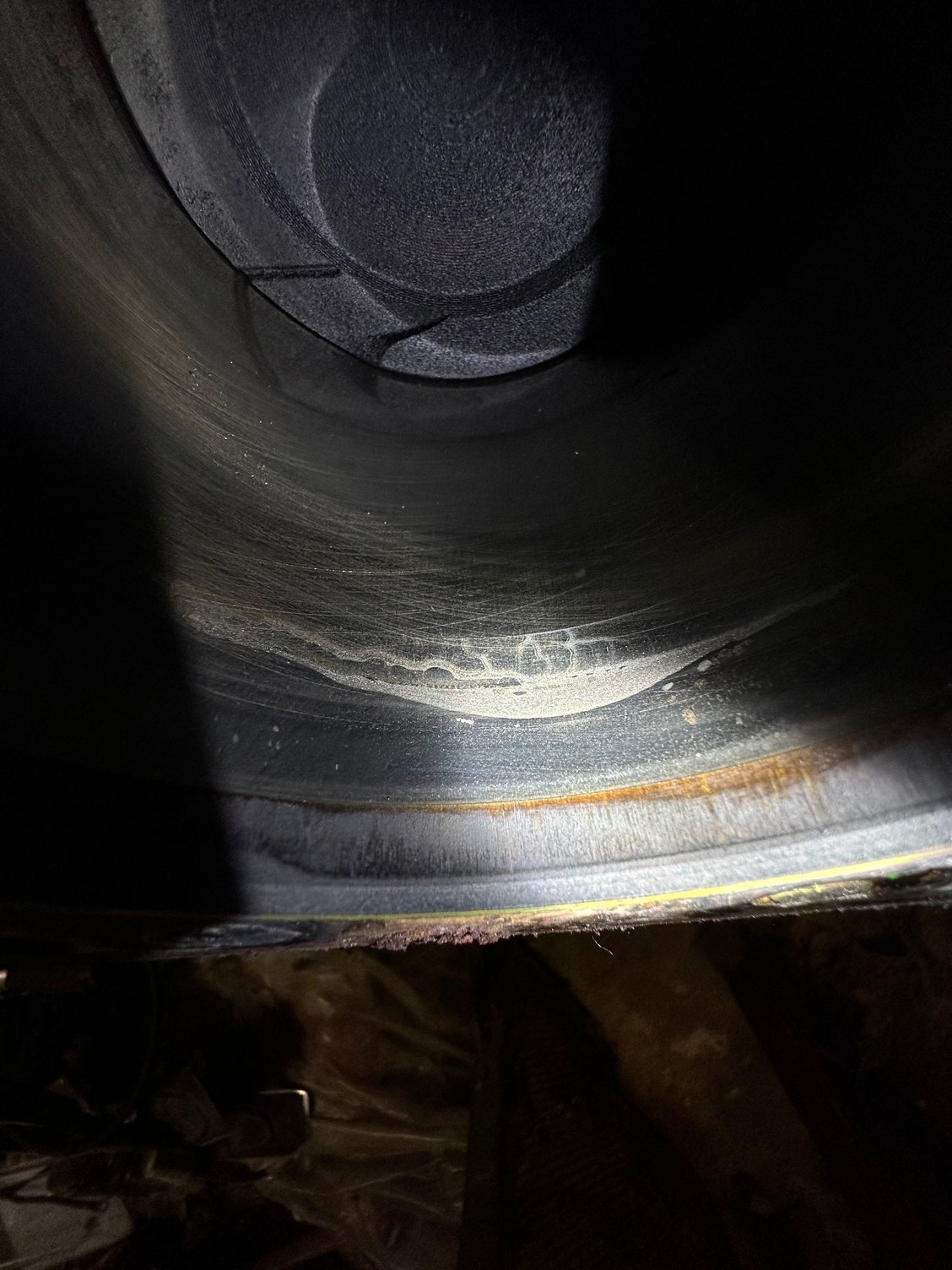

Hey everyone, I’m seeking some advice for what to do next. The situation is that I’ve pulled the engine out of the truck due to some nasty clicking noises and nearly no oil pressure at idle. The engine is a 400 and has seen some abuse before I got it.
Upon inspection the cam sprocket lost all its nylon teeth and somehow didn’t jump timing. Also I’m unsure if one of the cylinders is cracked. There’s some spiderweb like patterns along #7 that looks like corrosion more than anything but I can catch a nail on it going in one direction. Haven’t got it magna-fluxed quite yet since there are no reputable machine shops within an hour of me. Does it sound like a crack or maybe just a ridge for having sat for 12 years?

Here are the questionable marks on the cylinder wall.

The hone marks are perfectly normal. I can't tell what the mark is but it looks like light rust that's scuffed away. not sure, but if you can't feel it forget it. it's not a crack.
The 429-460 are a much better engine than the 335 series you have. and you can do a conversion if you want to spend the extra money. but if all you're after is an engine to drive your pickup I'd fix whatever your engine needs and drive. worst case you have to bore it and rebuild it, but unless it's worse than your pictures look that may not be necessary.

If you just want a capable reliable driver, I'd say rings, bearings, gaskets, and timing chain set, head refresh, and keep it. I see cross hatch pattern and scuffs and looks like maybe a light bit of rust from maybe where the truck sat a long time unused and that one piston was at top center, so light rust never got obliterated by a start up. If not sure about a crack, have the block hot tanked and tested at a local machine shop, like the one that you get to do the heads?
