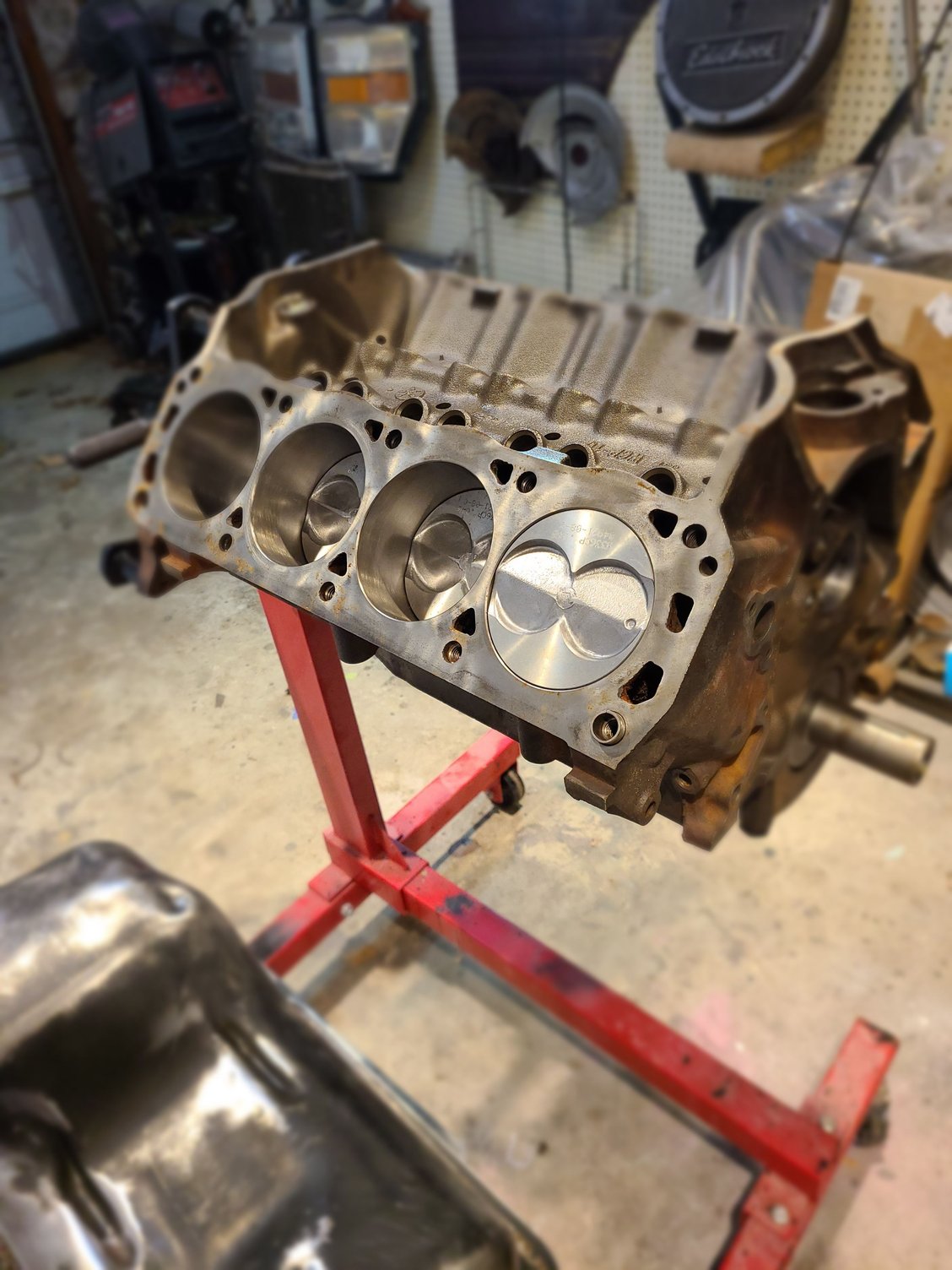

The first order of business was to get the new motor stripped down and sent out for inspection. The cylinder walls were clean but would ultimately need a 0.040 over-bore.
I went ahead and had the machine shop assemble the short block for me. I replaced the factory crankshaft with a stock forged unit from Summit racing. I think it was an Eagle Spacialty or something. This was mated to factory connecting rods and Wiseco pistons, also from Summit. ARP fasteners are being used throughout. Of course all the bearings and journals were replaced as well.
According to the Vin, this block is out of an '89. I'm keeping it flat tappet mostly to keep costs down. It is getting a nice little Comp 239 cam - 218/226 and matching lifters.

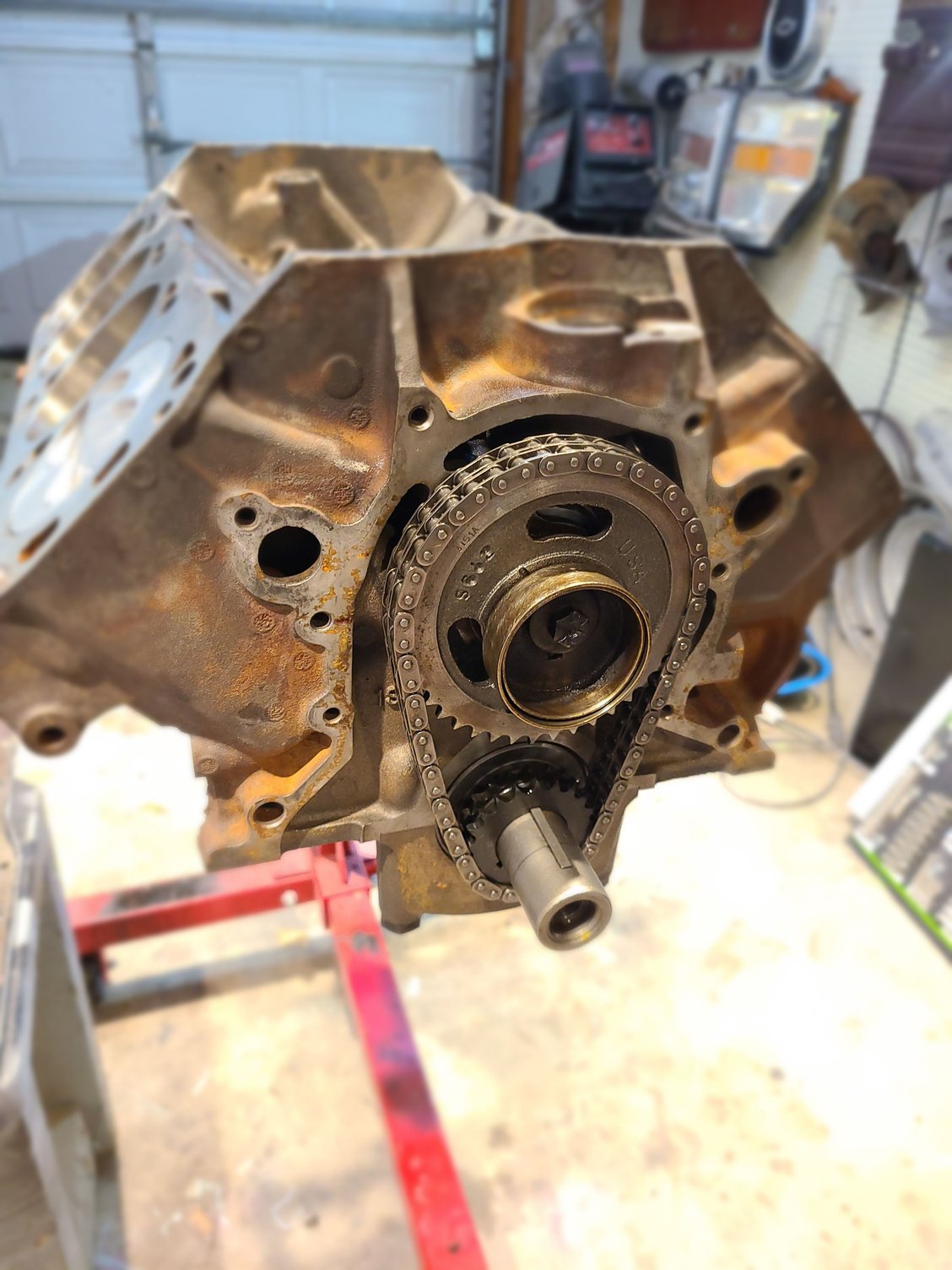

Thoroughly lube your shaft before jamming it in the hole.
The cam was followed up with a new timing cover and double roller timing chain to button up the short block.

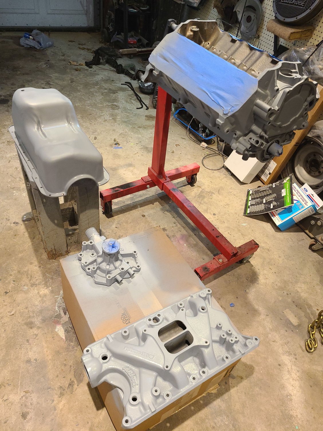

The oil pan on the donor engine was in fair enough shape so it's getting cleaned and repainted with the rest of the block. Similarly, I scored a used Edelbrock Performer intake for $80 that also was cleaned and painted.
You can also see the new Ford Performance aluminum water pump. Everything is primed with an etching primer before a few coats of VHT engine paint in classic Ford blue as well as a couple coats of VHT gloss clear.
I baked everything except for the block in my kitchen oven while my girl was at work.
Before bolting on the oil pan I installed a new Ford Performance high volume oil pump and ARP oil pump shaft.

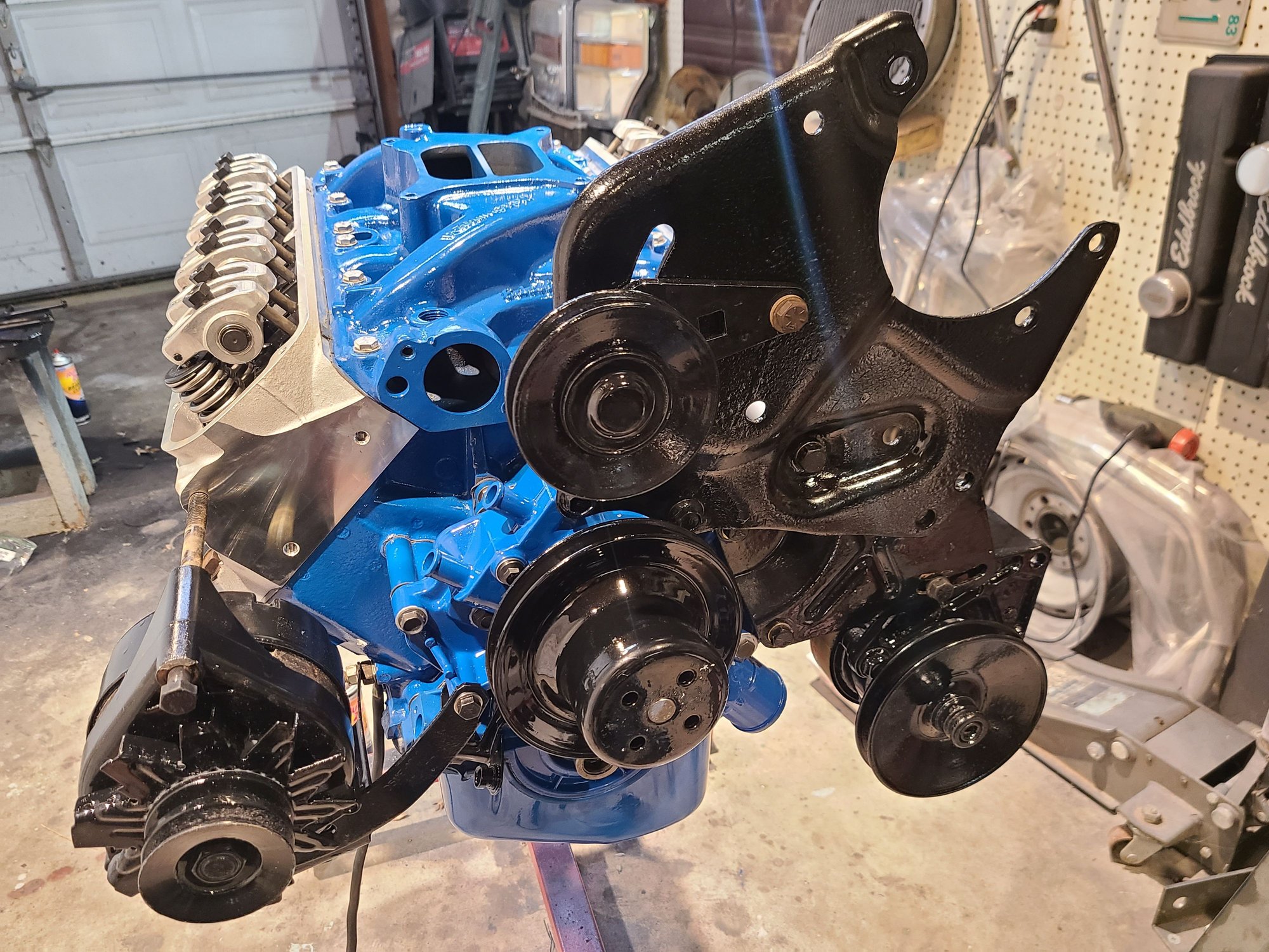

Good eye. The waterpump/timing cover combination was a pain to figure out but I got it sorted mostly thanks to info from this site. I'm using an old-style cover. I purchased a 110gph 8psi mechanical unit from Summit. I have a couple carbs on the shelf in addition to the Edelbrock I pulled from the blown engine. I have a Holley 750 double and a refurbish kit from Holley - I'm leaning that direction because I already have it.
I am using the front engine accessory brackets and v-belt set-up from the blown engine. I'll source new belts.

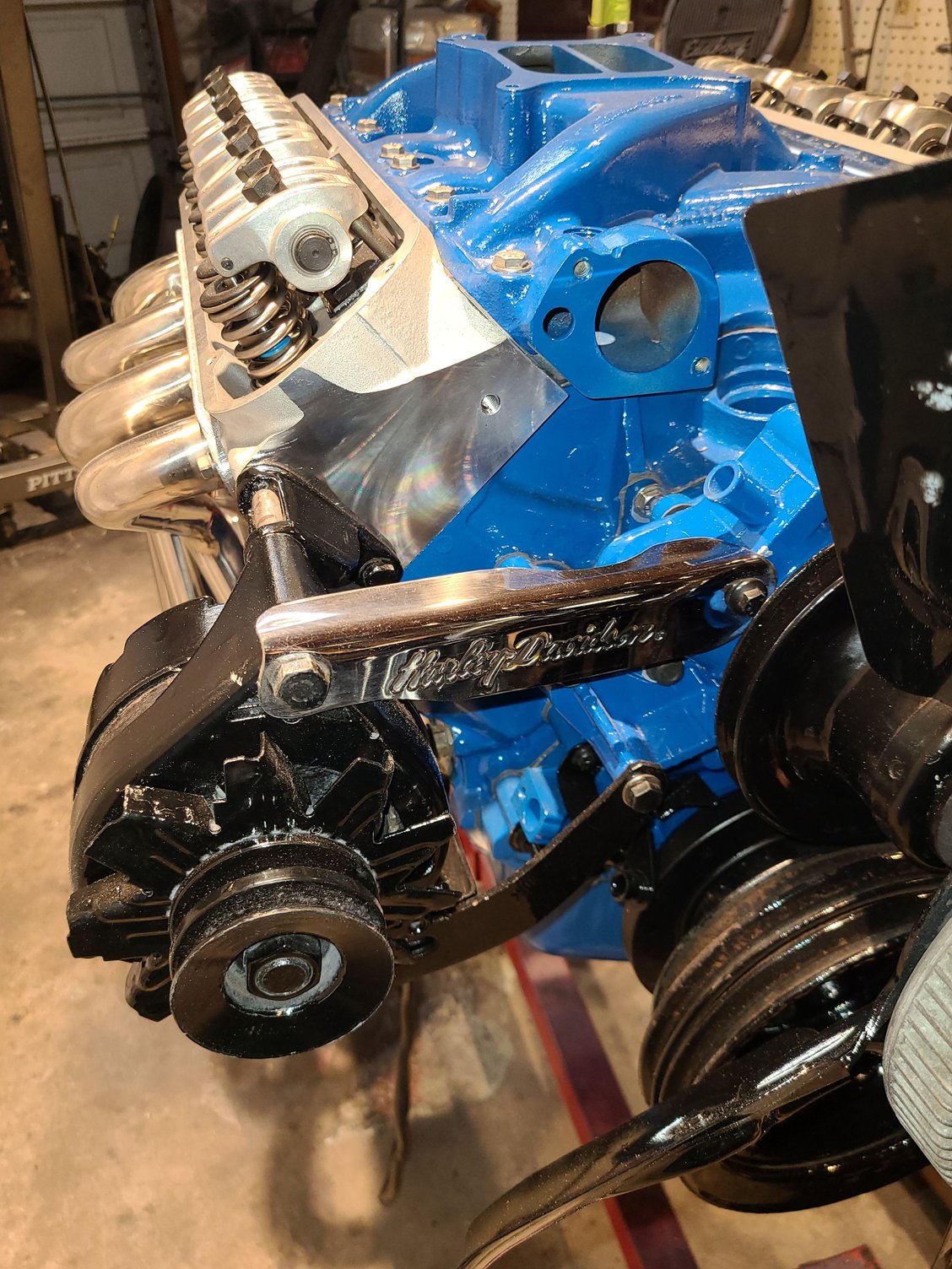

Here is the front engine cleaned, painted, and installed minus the crank pulley. I hate the look of the AC bracket but I don't have a better option at the moment.
I also deleted the smog pump. I modified the smog pump bracket to keep the alternator in the original location.
I cut up a stainless chainguard off an old Harley iron head, shaped it a little, and drilled some holes to triangulate back to the waterpump. It's super rigid.
The G1 style OE alternator is shown bolted up. I have already purchased a new G3 style with a new pigtail that I will install before I drop in the engine. I'll have some questions related to the ignition and charging system real soon. I want to simplify the harness as cleanly as possible - legit de-pin instead of clipping wires. I already have an MSD billet ready-to-run dizzy with new Ford Performance wires yet to install.

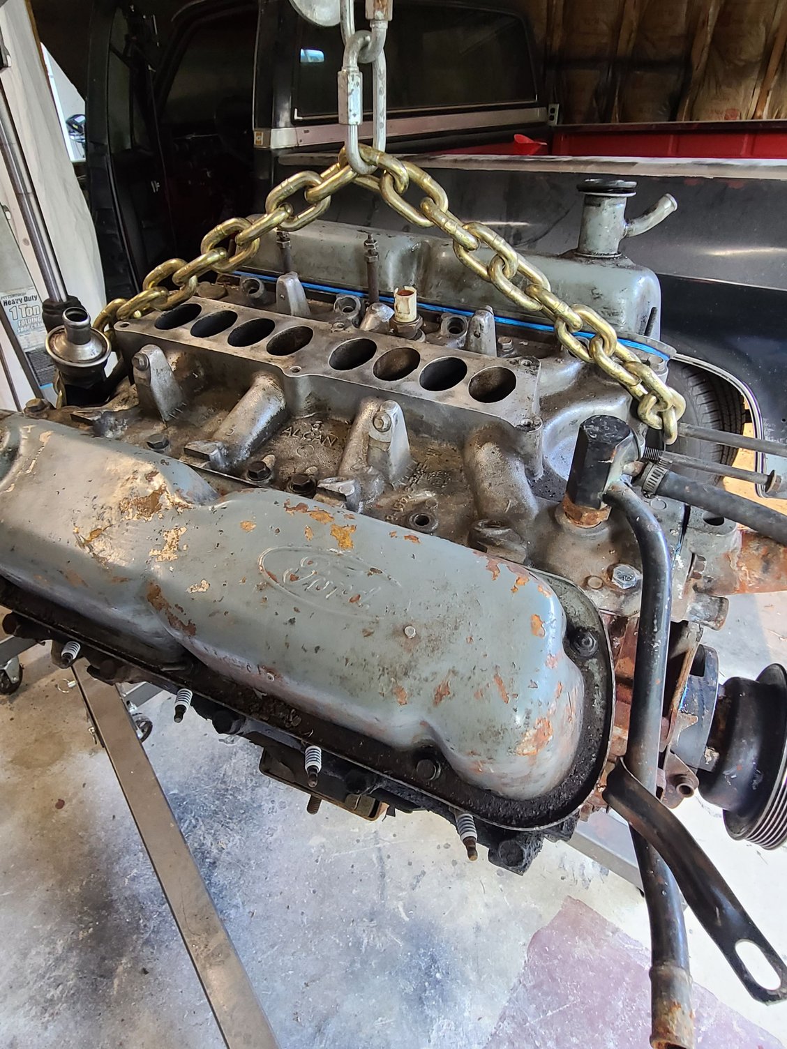

Originally Posted by dollarbeernight
I guess the project started a couple months ago when I finally sourced a 351W...
I'm not a Ford aficionado so forgive the stupid question... what is that crazy inline intake? Is it a later model EFI thing? I guess lve never seen one w the throttle bodies off.
Looks kind of... primitive/exotic, like something Smoky Yunich would have dreamed up (if he was a Ford guy).

That's the stock lower intake manifold from an 87-96 EFI truck. I'm staying with a carb for now.

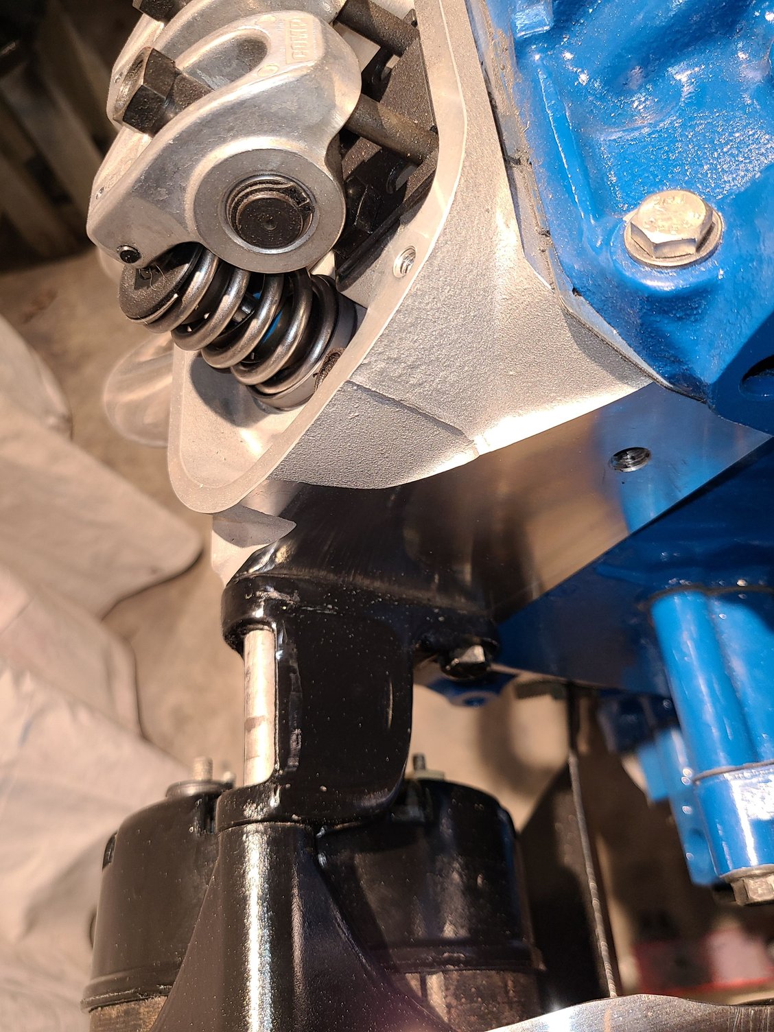

Meanwhile, I bolted on a set of long tubes that I've had in the shop for several years. They're unstamped but look like Doug Thorley knockoffs with equal length primaries.
Question: Will I have clearance to drop the motor in with these installed, or should I go ahead and remove the driver side header and just tie it back to the inner fender while i drop the motor in?

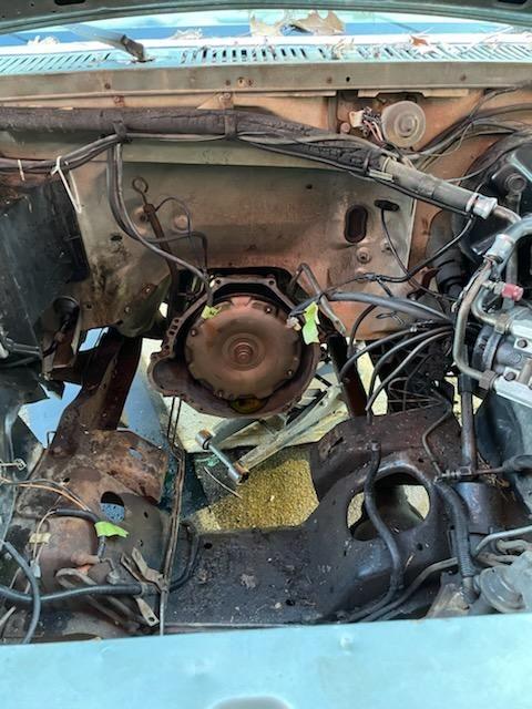

I've also started cleaning up the engine bay. As I mentioned previously, I'm simplifying the wiring and vacuum system as much as possible while retaining all the basic functions like heat, AC, wipers and washer. The smog pump is gone as are the carbon canisters and the mess of vacuum lines related to the original carb feedback loop. I don't live in a county where emmissions checks are required.
I also plan to re-loom the wiring harness and hide as much of the wiring as I can. I've got a couple specific questions once I get the motor dropped back in. Everything underhood is going to be cleaned and sprayed satin black.

On the headers can you lay both of them in the bay and held off to the side like you wanted for just the one?
I think that is how I would try and do it. Its what I did on my drag car motor it used 1-7/8" long tubes and a pain to get in place if the motor was already installed.

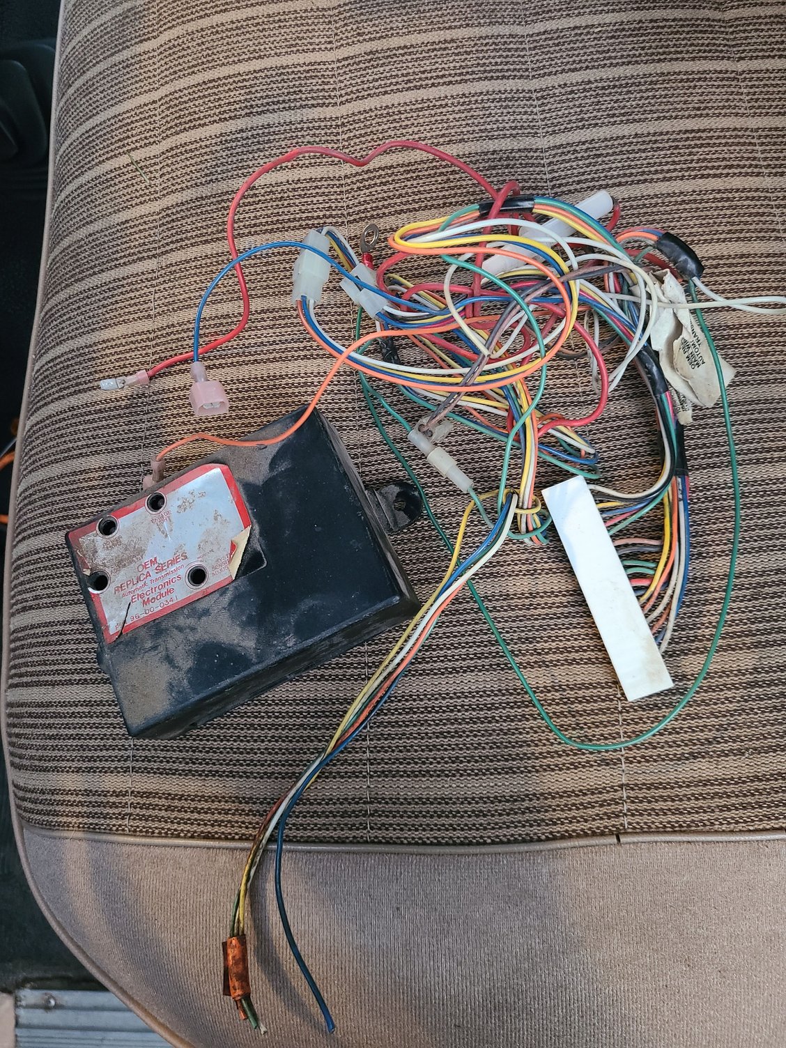

While chasing wires I found and unplugged this thing from under the dash. Any idea what it is - and do I need it?
It says OEM REPLICA SERIES Automatic Transmission Electronics Module. The truck has a regular C6 transmission and I don't what which stock transfer case.
